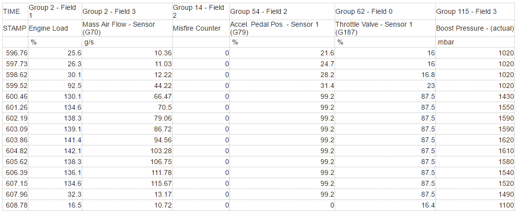

OK, so I have some data, but I'm not sure how helpful it is.  I logged the following:
  • Accelerator position
  • Throttle position
  • Boost pressure (mbar)
  • Misfire counter
  • MAF
Here is the data from driving normally at 30 in forth, to sudden 100% accelerator, then back to normal again:
It peaks at 1620mbar, which is around 23PSI. Is this normal? It seems high to me?  Also, when I had my foot flat on the floor, I could hear a constant, quiet psssh sound, as if air was venting. It certainly sounded like it was coming from the turbo area.  Doing some reading, it could be an n75 failure? Any thoughts?

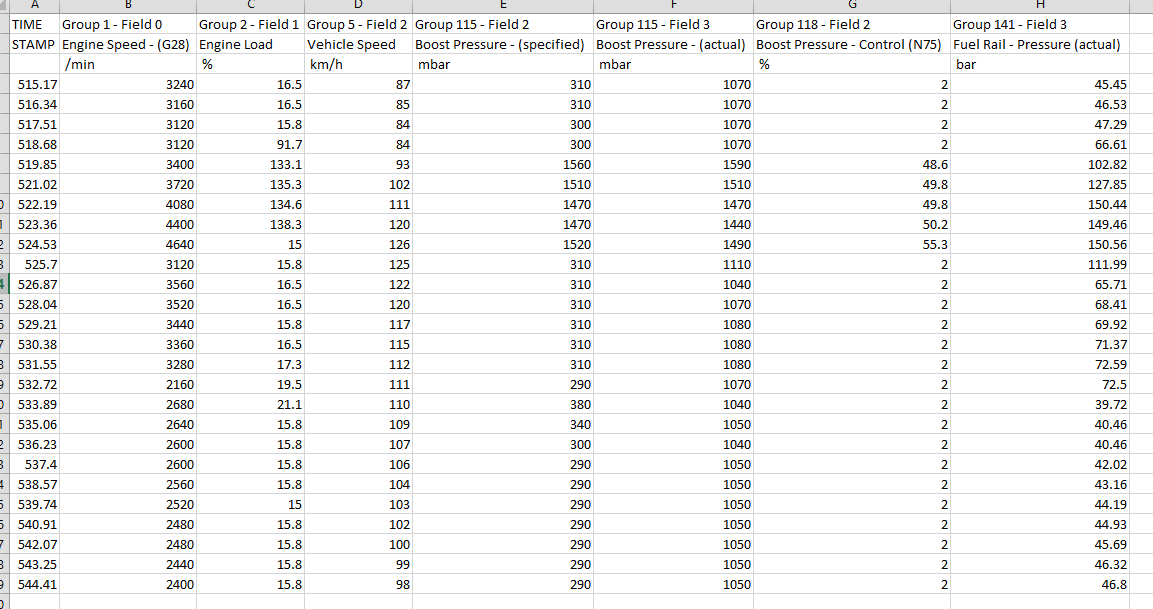

The data that I've got isn't really helpful.  I had 12 items checked to log so the sampling rate is too low to see any accurate, usable data :(  From the obvious though, it looks like actual boost is close to specified.  Here's a glimpse at a 100% accelerator in 3rd up to about 80mph, then off again:

Thanks, here it is:
https://drive.google.com/open?id=0B9KSwu5pc5lzR3hLWUxWZUdhTjQ
I did, and no codes showed up from an autoscan.

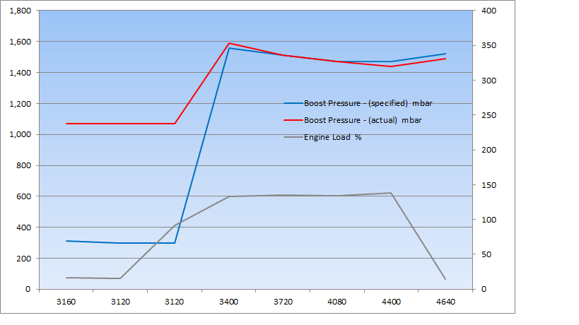

Can anyone tell me why my car is only asking for 300mbar at times? I don't quite understand why it isn't asking for at least 1000 at all times...
That is a chart of your full throttle run. However, clearly you only commence proceedings from 3,400 rpm so you don't see the entire spectrum, and as you say the sampling frequency is quite spread out, but it seems to be holding boost ok.
I'm not sure why it's calling for 300mbar boost at times. Maybe something to do with overrun on release of throttle and vacuum...Hope someone can clarify.
If you logged a full throttle run from 1,000 RPM I'd expect to see boost rise sharply and slightly overboost compared to specified boost for a short time at start and then settle to a sustained boost more or less in line with specified.
Your, misfire counts are very low, only 1 on each of 3 different cylinder banks. Are you feeling or noticing the misfires? Clearly they are not severe enough or sufficient frequency and duration for them to log a fault and CEL.
Interested to see what other suggestions are offered by forum members to narrow down fault finding.
