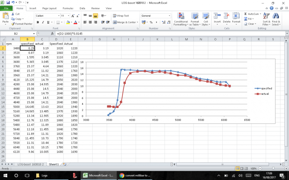

Yep, indeed. It does look better but it was really bad between 2k and 3k before, well beneath the range of that plot. But promising. I'd like to understand what the timing chain cover replacement solved, if it is all 100% now.

  • Yes, I made a post similar a while back. Mine has got quite a bit of oil around it, the mounting bolts in particular. I've cleaned it up and waiting to see how quickly it comes back. Mine is an April
  • I don't have VCDS yet but there have been a few posts fairly recently with turbo logging data to capture. You need requested boost  and delivered boost, against engine rpm.. Often use 3rd or 4th gear
  • Cool, I'll do that.  I'll take up the A1 ha.
 Yeah I'll go out again tomorrow or over the weekend and get some lower rev results too.
Still seems crappy/laggy if I try to put more than moderate load on at 2k... I'll put throttle on, it'll kind of think about it until 3k then whoosh, off it goes. It feels like turbo lag, but I've been led to believe that that is almost non existent on these due to the small turbo spooler size?

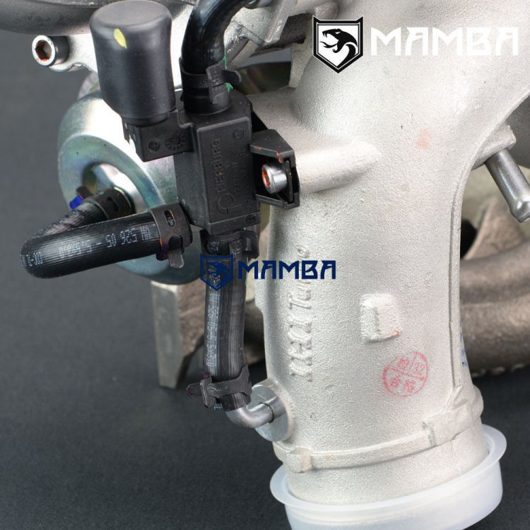

Nope. They've replaced N75 as I asked them to, and it has not yet fixed the issue.  They've said that the current map is pulling nicely on the dyno, but it is still not where they want it to be, and the car is still under boosting.   I've been informed that their next port of call is to remove the turbo, send it off for inspection.
