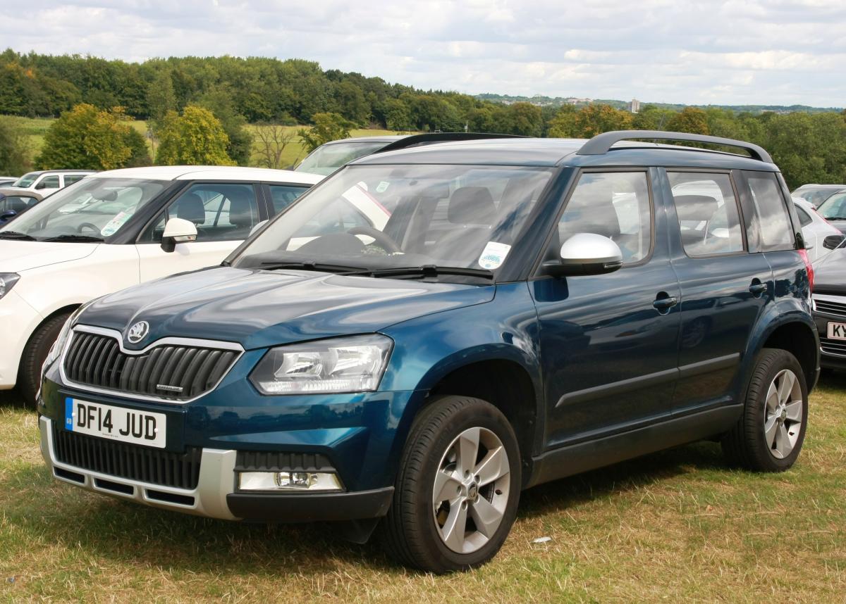

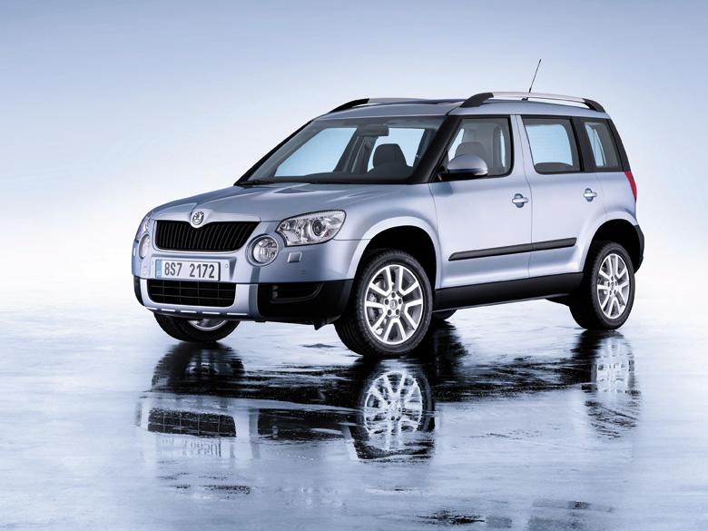

Pre-FL:
FL:

Pre-facelift has the "bug-eyes", post doesn't.
If it is a "bug-eye" then the wiring loom will not be the same, and to change to the new headlights would be quite complicated and would need a modified mounting panel, as the whole front is different.
