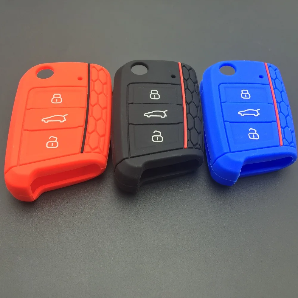

As I keep my key in my pocket at all times mine does it at least once a week but have never got the windows to open as well!
Problem is that the buttons are flush or even proud of the fob, been waiting for someone to produce a fob cover which should solve the problem but no one has yet, the Superb 3 key is a new design and no one as yet sells a correct cover for it.
