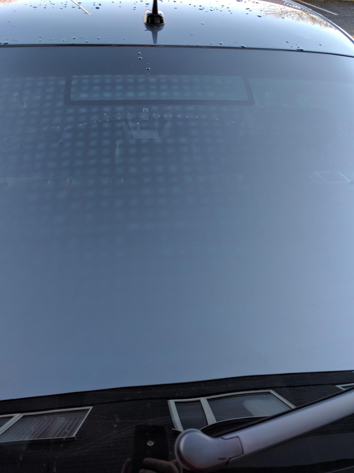

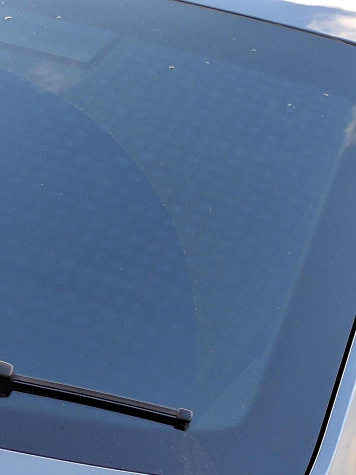

Hi,
Had my VRS since May and I'm still loving it but after a fortnight or so I noticed these spots on the rear window, I thought they'd come off when I gave the glass a clean inside and out but this hasn't made a difference. Its only a little niggle hence why I've not took it to the dealer, its only annoys me when I spot them in the rear view :D

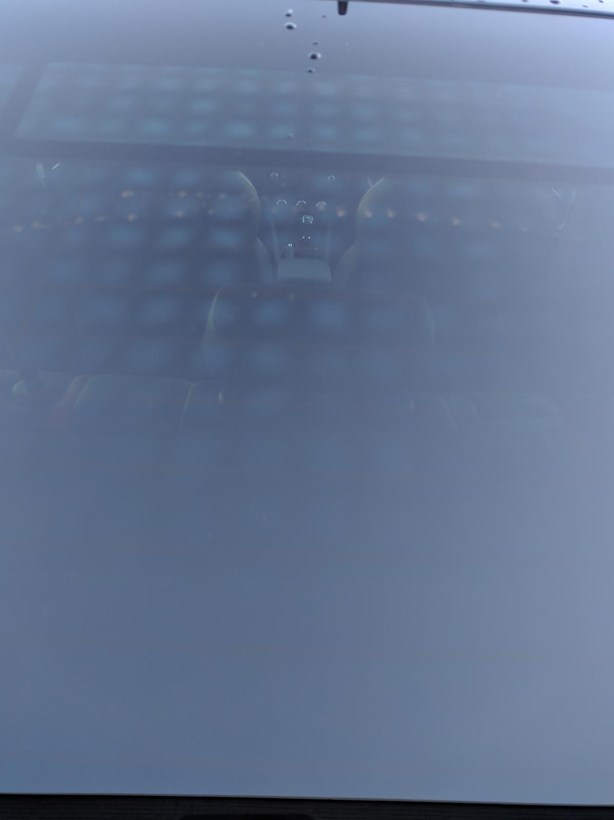

The thing is some days you can't see them, not sure why but may have something to do with the factory sunset glass and the daylight. In certain light they seem to disappear so I don't always see them in the rear view and from outside.
Anyone come across this issue?
Cheers
Luke

I don't think it's a fault as such Mence I think it's part of the process of making the Sunset glass.  As I said earlier it's looks the same as looking through the glass whilst wearing polaroid sunglasses.

Thanks, I'd been baffled by these, seen them on lots of cars and had them on my last car (mondeo) but not noticed them as much on my Octy.  Now i know its the tempering.  My guess is the spots are where the cooling air jets hit the hot glass.
