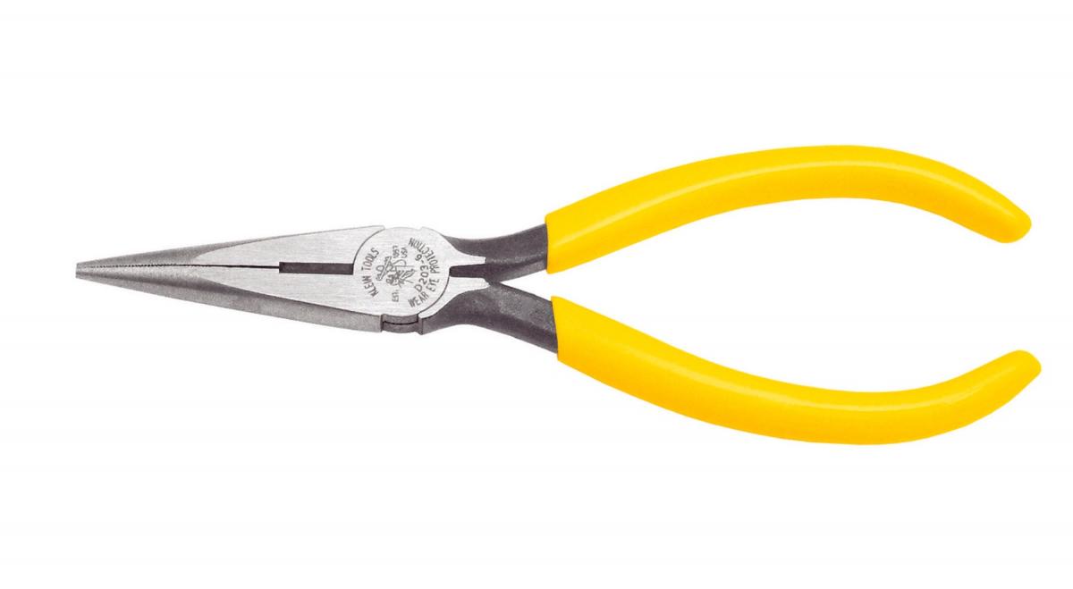

Projector headlamps (with the dipped beam in a tube) use the smaller H7 bulbs for dip and main beam. I managed to change the dipped beams quite easily, using long nosed pliers through the wheel arch opening but I could not for the life of me rotate the main beam bulbs into the locked position. There must be a special, double jointed tool for these so a visit to the dealer is called for. Bulbs were very tight in their holders but they just pull straight out.
Might have to try the long nose pliers trick
Daft question are they extra long nose pliers

Just regular long nose pliers like these, Malcster. And remember the locked position before you remove the bulbs so you can replace them at locked position minus a quarter turn.post-133523-0-68216600-1481102927_thumb.jpg
Just regular long nose pliers like these, Malcster. And remember the locked position before you remove the bulbs so you can replace them at locked position minus a quarter turn.attachicon.gifimage.jpg
cool thanks wsnt sure if they needed to be the upturned type
