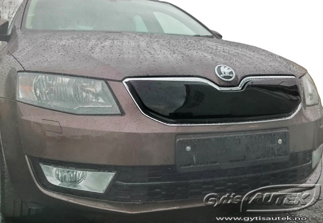

- fit a winter cover for upper grill, see picture
I like the looks of this - Is it an official Skoda accessory or aftermarket ?
I don't know, I found it here:
http://www.gytisautek.no/Shop/Product/Skoda-Octavia-2013-Vinterdeksel-Øvre/GASKO-VD013
(Norwegian site)
It is also sold at Superskoda.com.
