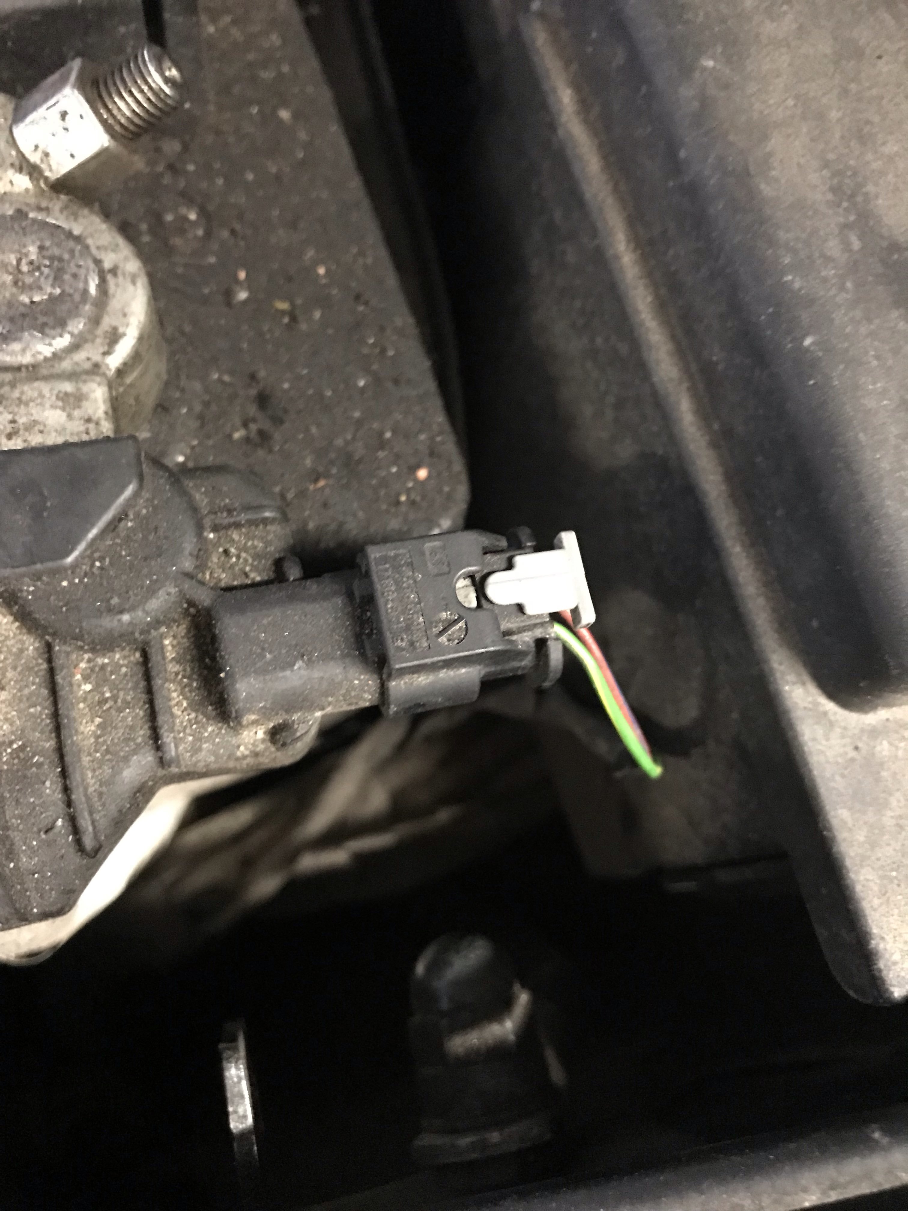

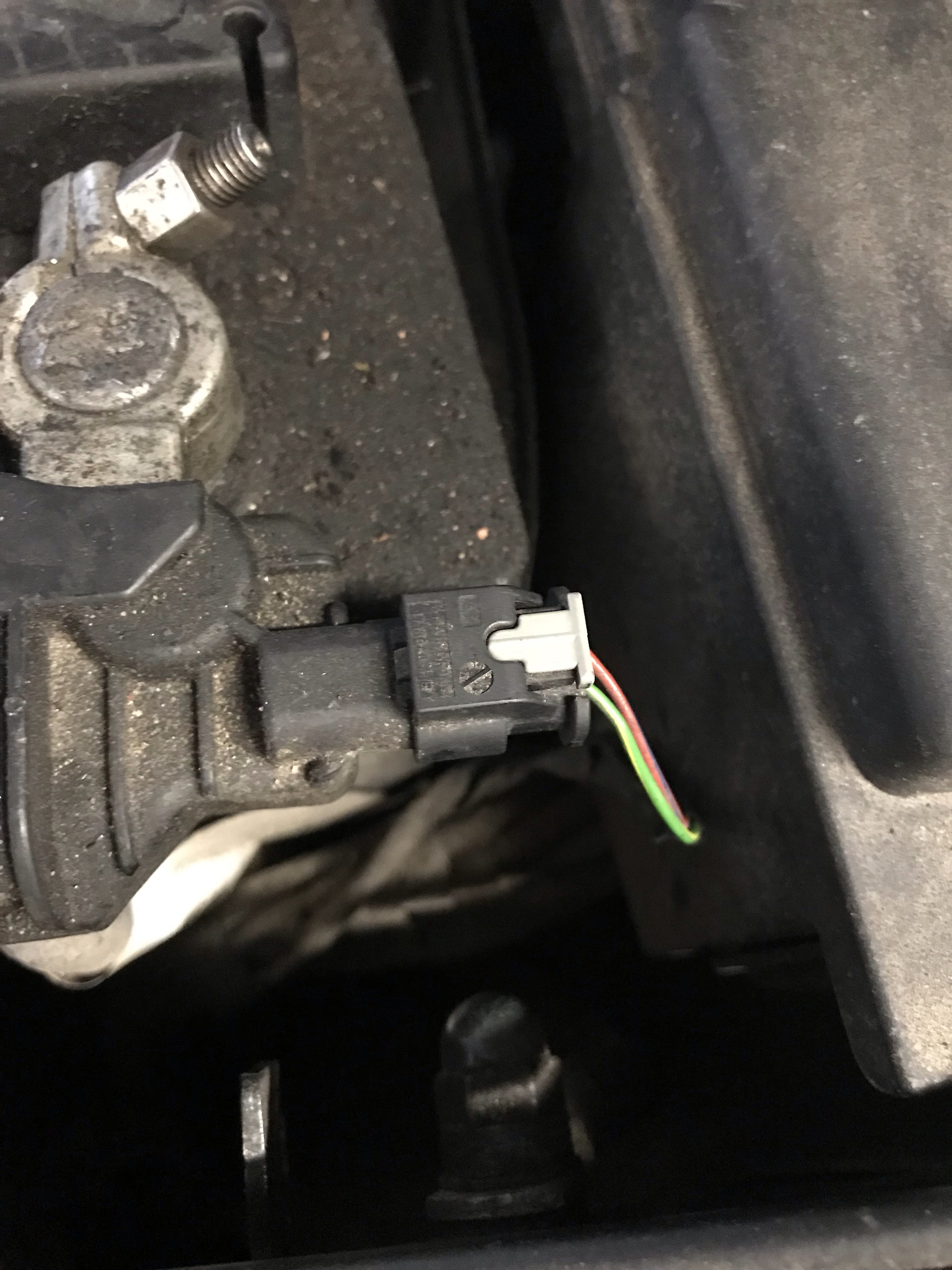

If you want to disable it really easy, permanently, without cost for buying module etc, and without coding anything.
Just unplug the extra connector on the -ve terminal of the battery. This extra connector is to a "shunt resistor" which purpose is to measure the system power consumption. Unplug that, it simply reads that system power consumption is too high, and never activates start-stop.
No error codes thrown, no lights, no pings warnings or anything. Just no start-stop! Simply "power consumption too high" in the menu.
If you're going to leave it off for a while, i'd recommend sealing the connectors in a bag or something to prevent dirt and wet getting in them.

Any chance of a photo showing the connector in question please before I attempt to do the same.
No problem, I'll try to take a picture of it today.
That would be greatly appreciated.
You'll find the connector at the -ve terminal of the battery. Might be hidden under the Protective flap (mines broken off so is missing);
There's a little connector toward the fusebox, with the little grey tab;
Pull this clip out fully as shown, this unlocks the connector;
Now finally the connector will unplug. You might hear a little click of some relays and a whirring noise. That's just the computer recognising the change;
Note. Do NOT use any pliers or any tools to remove the connector as it's easily damaged. If it's not coming off easy then the little white tab is probably not pulled out far enough.
Good luck.
