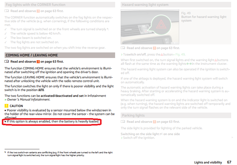

Hope the owners manual is wrong here (see attachment from 05.2016 manual)
"If this option is always enabled, then the battery is heavily loaded"
Reads like it will use significant power just sitting there enabled, with lights out but switch set to auto, so that lights are ready to do their thing.
If this really is the case then it would be risky to make use of this feature.
Would like to think this was something that just got a bit mangled in the translation but I can't find this wording in earlier versions on manual so they may really mean it.

I'm not sure where the confusion is?
They aren't saying that simply turning on the feature drains the battery, it is having the headlights on with the engine off that will drain the battery i.e. when the feature is actually working.
If you have the feature enabled and make use of it regularly the battery will fail sooner than on the same car without the feature.
Yes, I think (and hope) that that is what they meant to say.
but, what they actually said is  "If this option is always enabled, then the battery is heavily loaded"
to me "simply turning on the feature" equates to "feature enabled"
Manual only says:
