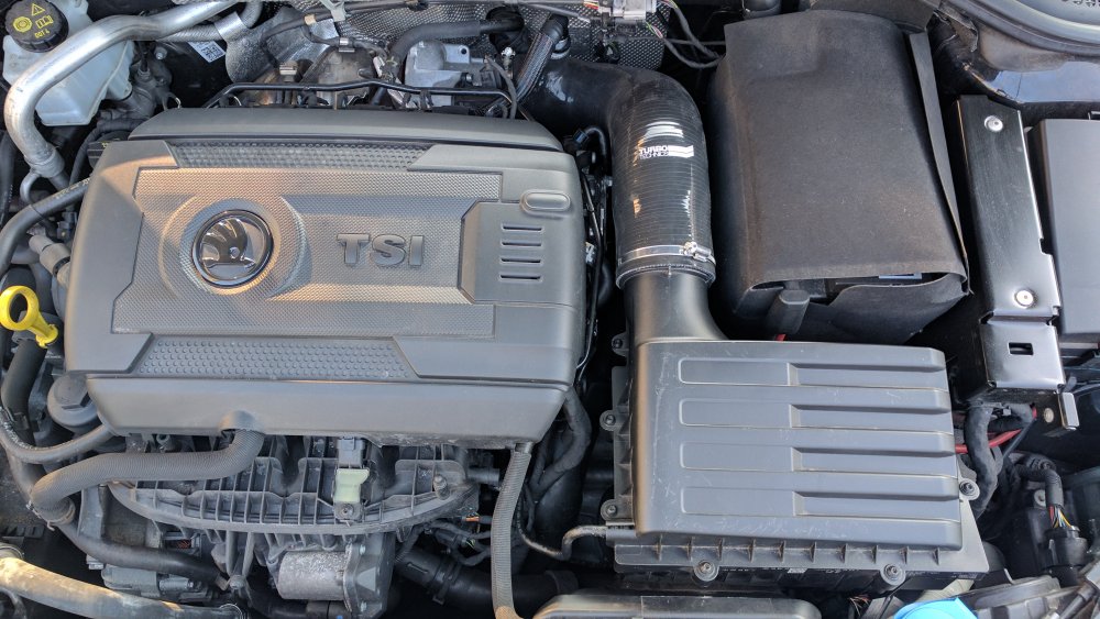

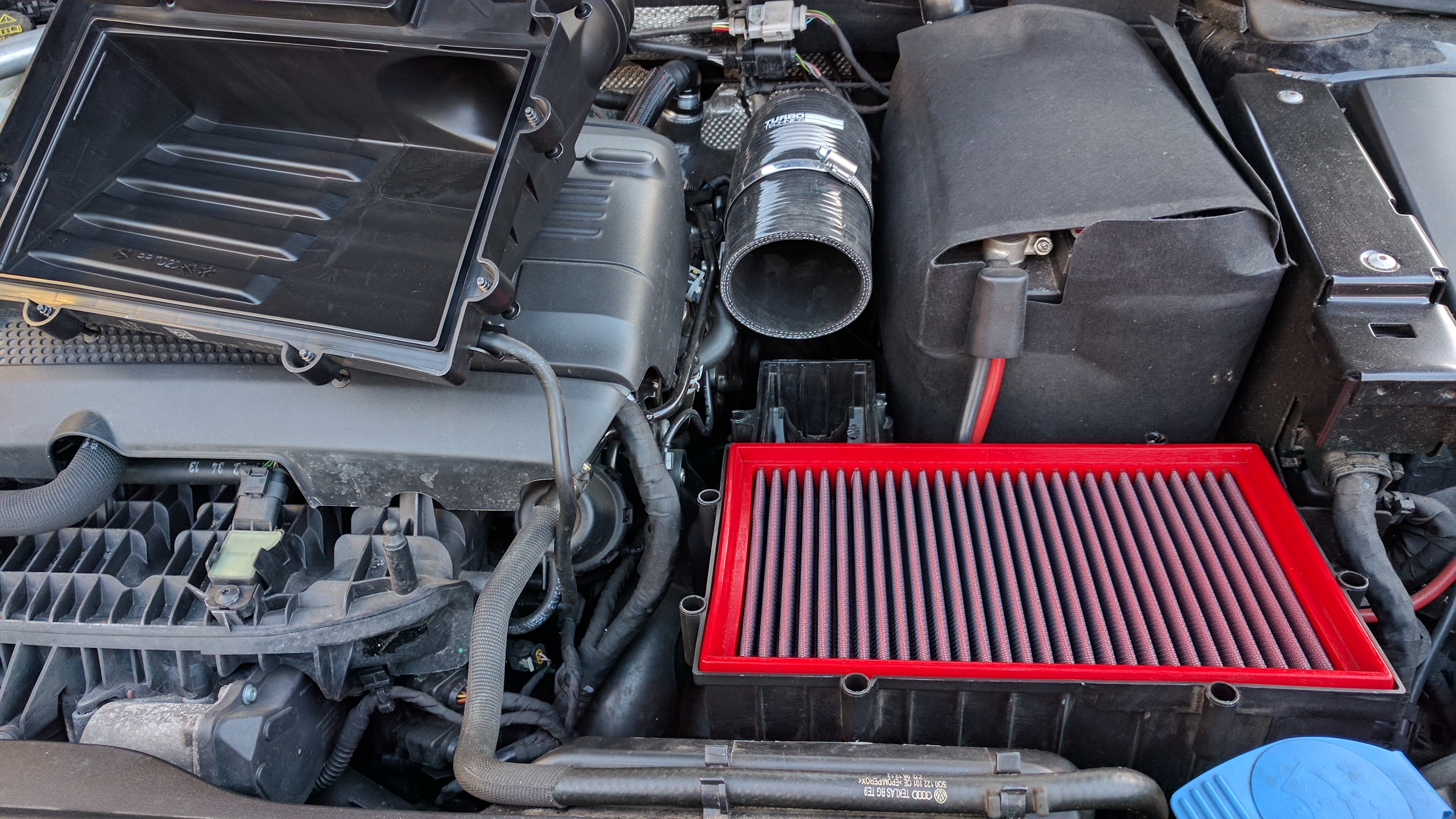

Swany I got the TT inlet and BMC panel filter yesterday, so I'll post some pictures on Sunday when I put everything in.

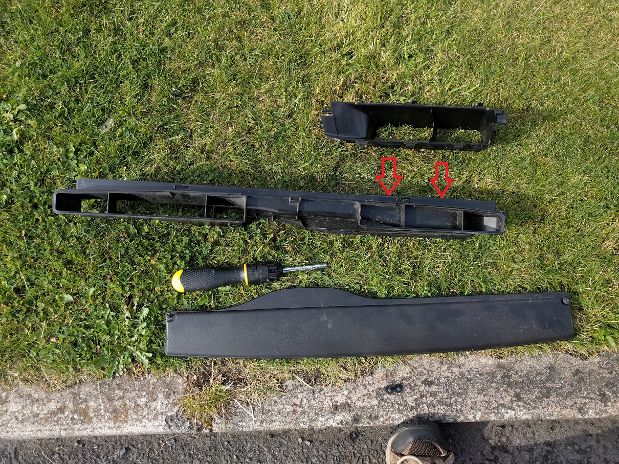

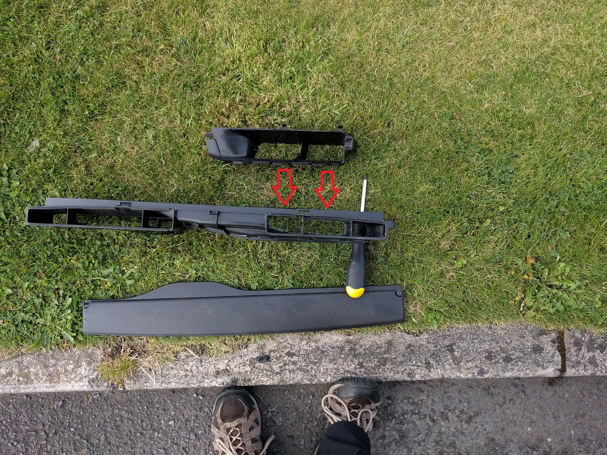

to save some cash you can improve the airflow by drilling out the blanking plates (red arrows) in the stock air intake
stock
drilled out

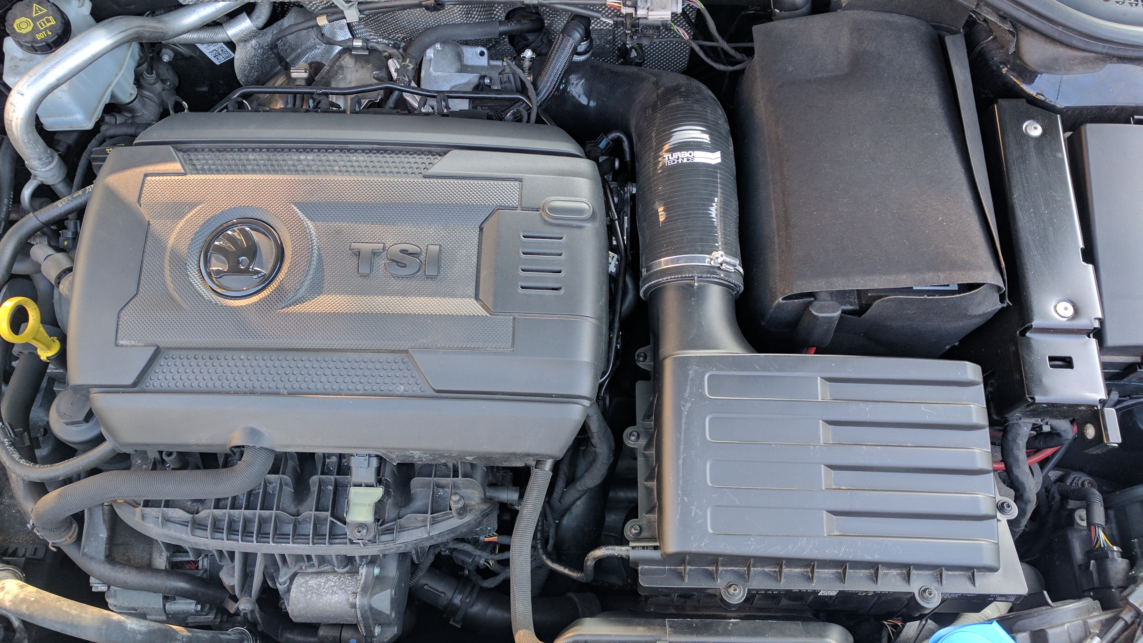

As promised swany, pics.
Car is actually a lot more lively, every accelerator application immediate, and the car is a lot smoother in the higher revs.

The panel filter is BMC.

It's supposed to be a bit less restrictive, but the main benefit is that as I have the cleaning kit and oil I won't need to pay for replacements when servicing it.
I'm doing 170 miles per day without any vacations so I'm servicing it a bit more often than the average owner.
The biggest benefit in the setup is the turbo inlet replacement.
