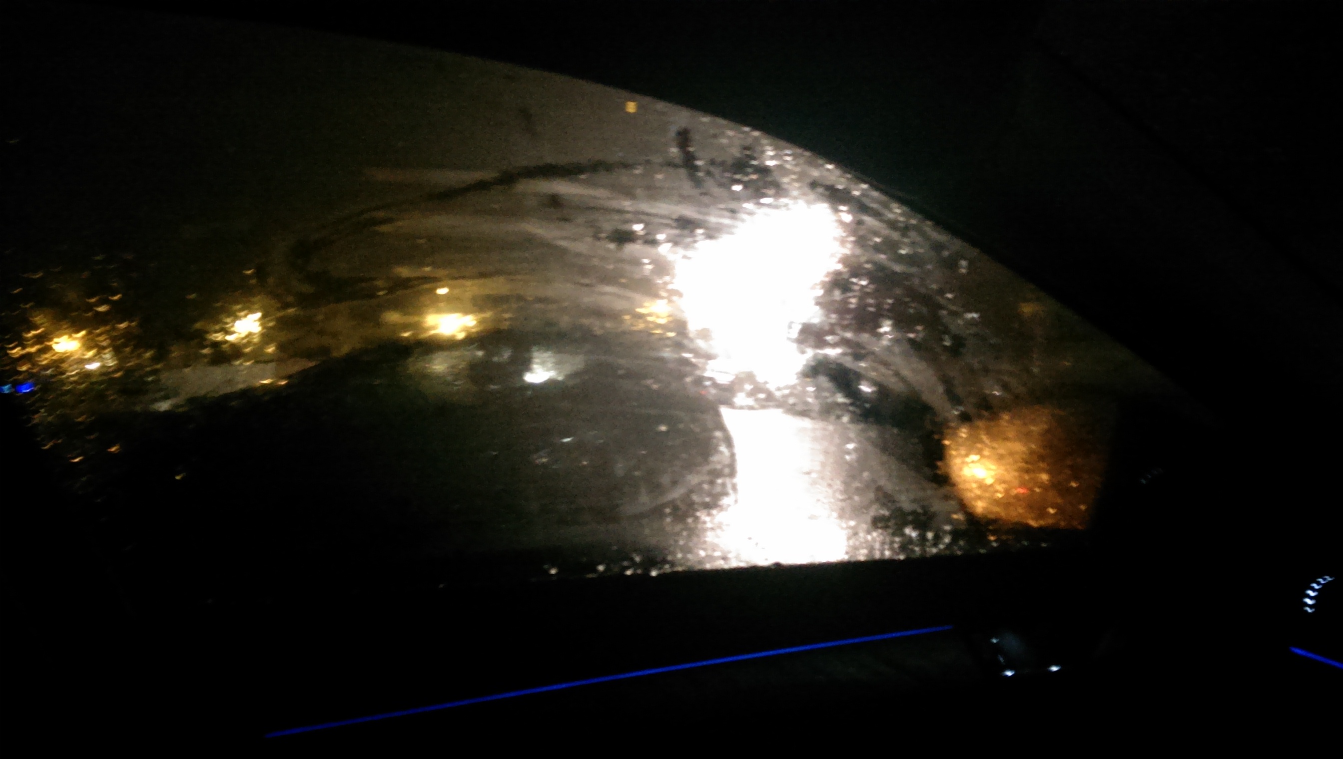

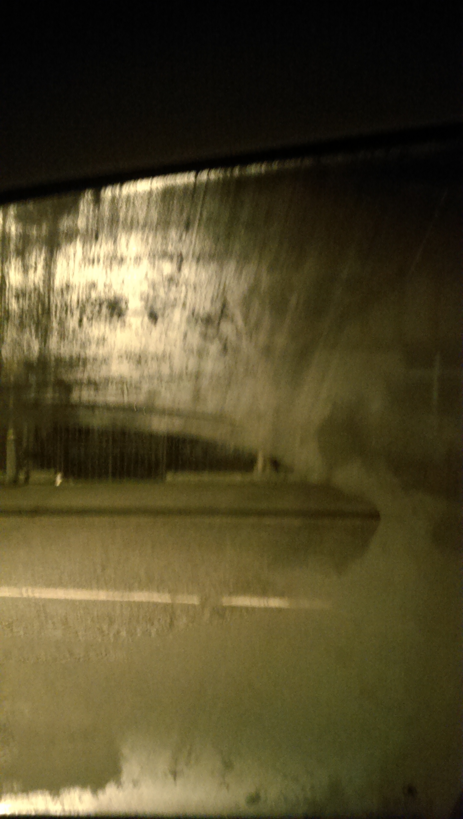

I have had a number of issues to the point I am talking to Skoda for compensation. As with the brake sticking on and the condensation / misting the car was becoming undrivable.

Quality of sound via the speakers being shocking, sound being worse that a Dr Who Dalek
Condensation - levels inside that results in water running down the inside of the windows, I had to stop the car and clear the windows, only the heated windscreen allowed me to see forward.
Metical sound upon cold start, with petrol engine sometimes sounding like a diesel.
After 15 years, 9 cars and about 100k in deals I have had enough and prepared to take it to court. Dealer has been great, but Skoda UK Customer Services are a joke, with the so what attitudes.
Rufusmcc
you have a definite water ingress problem
does your car have a pan roof ?...blocked drains ..?
please check the boot for water ....leaking through rear lights or poss pipe from pan roof..if you have one
how old is yours car ?
do you park under trees?.....have been known to block drainage under wiper scuttle panel and force water into car through heater fan and into car through lower heater vents.....
do you do short runs regularly?
that amount of condensation is water ingress somewhere ....
Do you have a dehumidifier as this is the only way you will dry your car out fully.....
ive seen this a few times in my 29 year in the windscreen fitting trade water is your enemy inside a car they suck it up like a sponge and it only takes a very small amount over a period of time to cause mega problems
cheers
Mark
Edited by Windscreenman
Correction
Windscreenman,
It's a software or mutiplex issue. At times the car has a mind of its own. Automatic brake won't release, radio changes channel by its self. Seats over heating. I think the condensation and misting is down to the recirculation flaps closing. Skoda view was that it was either ,1) I had washed the car, 2) it was because I was playing football 30 minutes earlier, yes they did say this, 3) it was because of direct sunlight, well at 8:45 pm in Scotland during late November there is not much sun about.
In the end I have accepted my dealer offer to buy the car back, but I have lost thousands, didn't mind losing the monthly payments, but deposit lost too. There was an offer of a good deal to buy another car of same spec, but it I took that as an insult. It is like me paying 3k to Skoda to fix the faults.
Starting to think that I should now take this to a court. Sad as I said before over 15 years, 9 cars and spending about 100k great how they look after you in time of need.
have you tried reading the manual about air recirculation... it is a check in the software dont remember how is called and you can tick it on or off... think automated recirculation... try it
Edited by Corbu33
