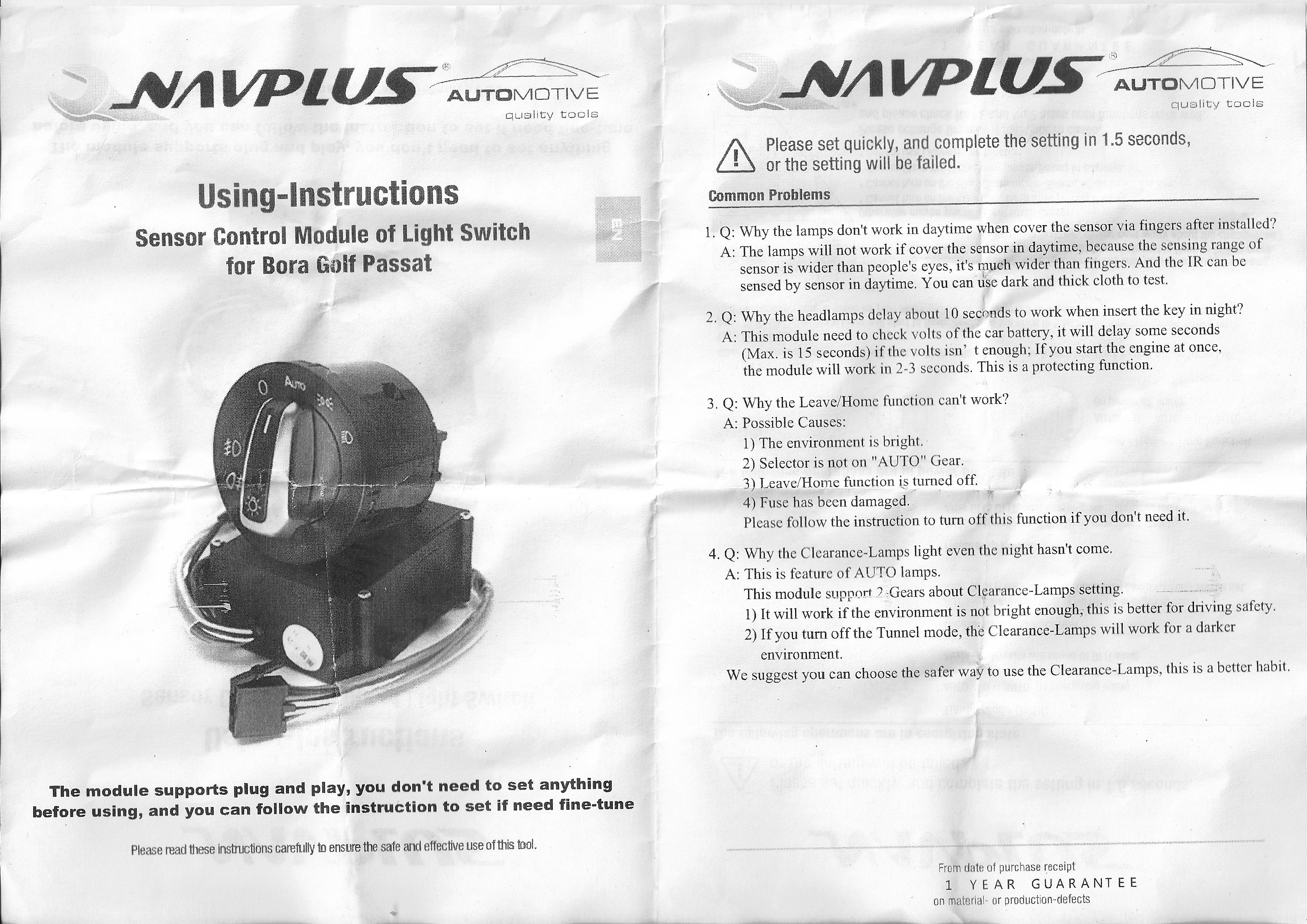

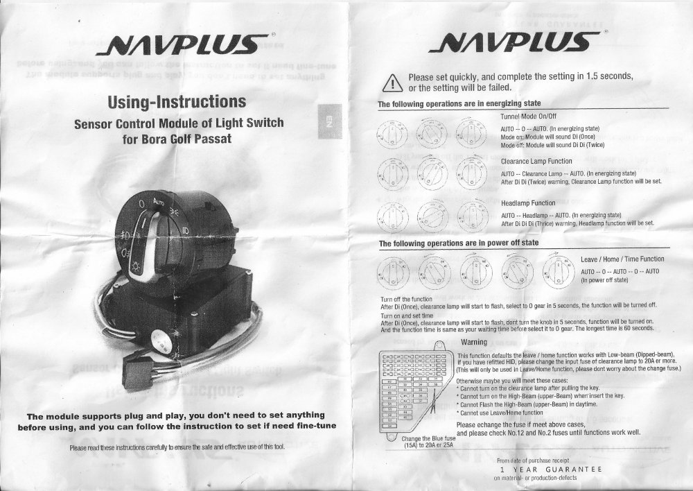

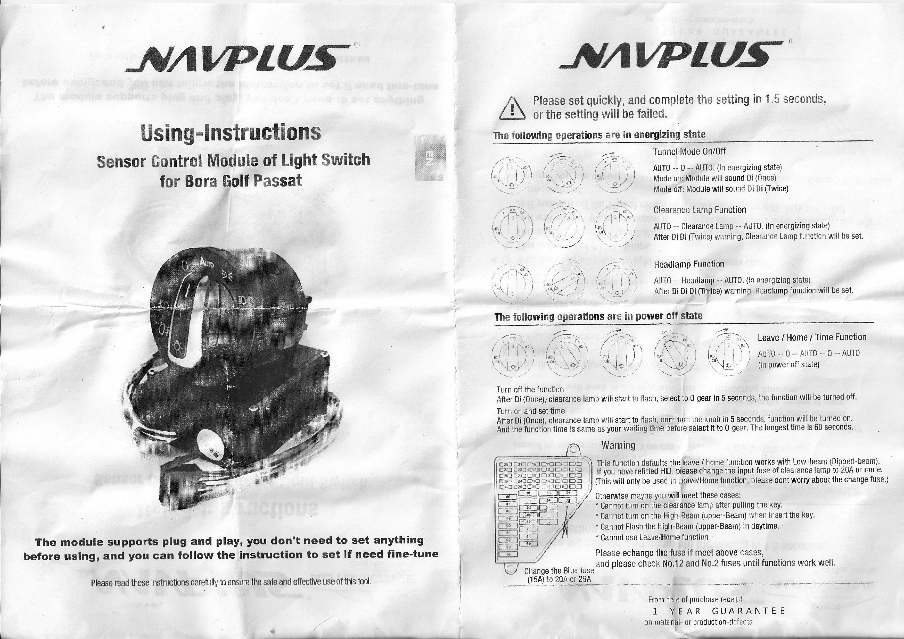

25 minutes ago, globalste said:
Ok thanks Hutch, do you remember what the sequence was that you did for it?
Here are the sequences to turn on and off certain features. 59de4f145c6e2_Autoheadlightsmanual.thumb.jpeg.c68feb0c84253254feed79d2f7c431f8.jpeg59de4f1d559c6_Autoheadlightsmaunal2.thumb.jpeg.a9d4931ae2e80d525fd1c309eae9603e.jpeg

Just looking at @JGrindels instruction link and reading it again (amongst other instructions in various levels of translation) I wonder if I had to change fuse 23 to a 20-25A one?  I changed the large fuses for headlights (57 & 58)  and and the main beam (36), but it seems to suggest that the side lights fuse needs to be increased to 20A, which is one of the small fuses running at 15A.
it might also explain why @AMD87 managed to get his working, because he has LED headlights and not HID...
hmm, do I give it another whirl and buy another kit...  or do I just try and nip down the road to see @JGrindel and look at his fuse Box as I think he has HID.
I don’t have HID installed but I do recall a fuse needs to be upgraded if you have HID’s.
