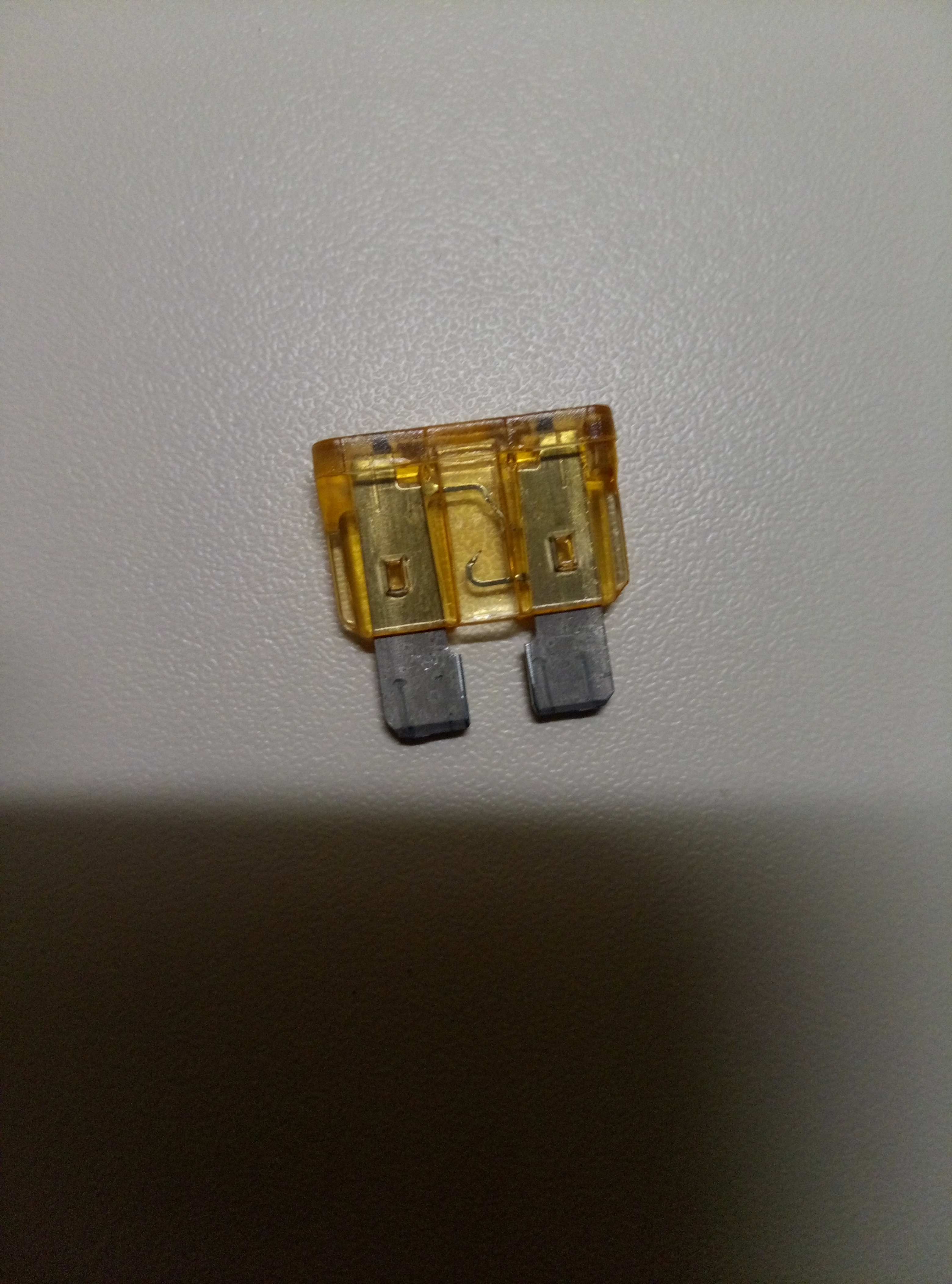

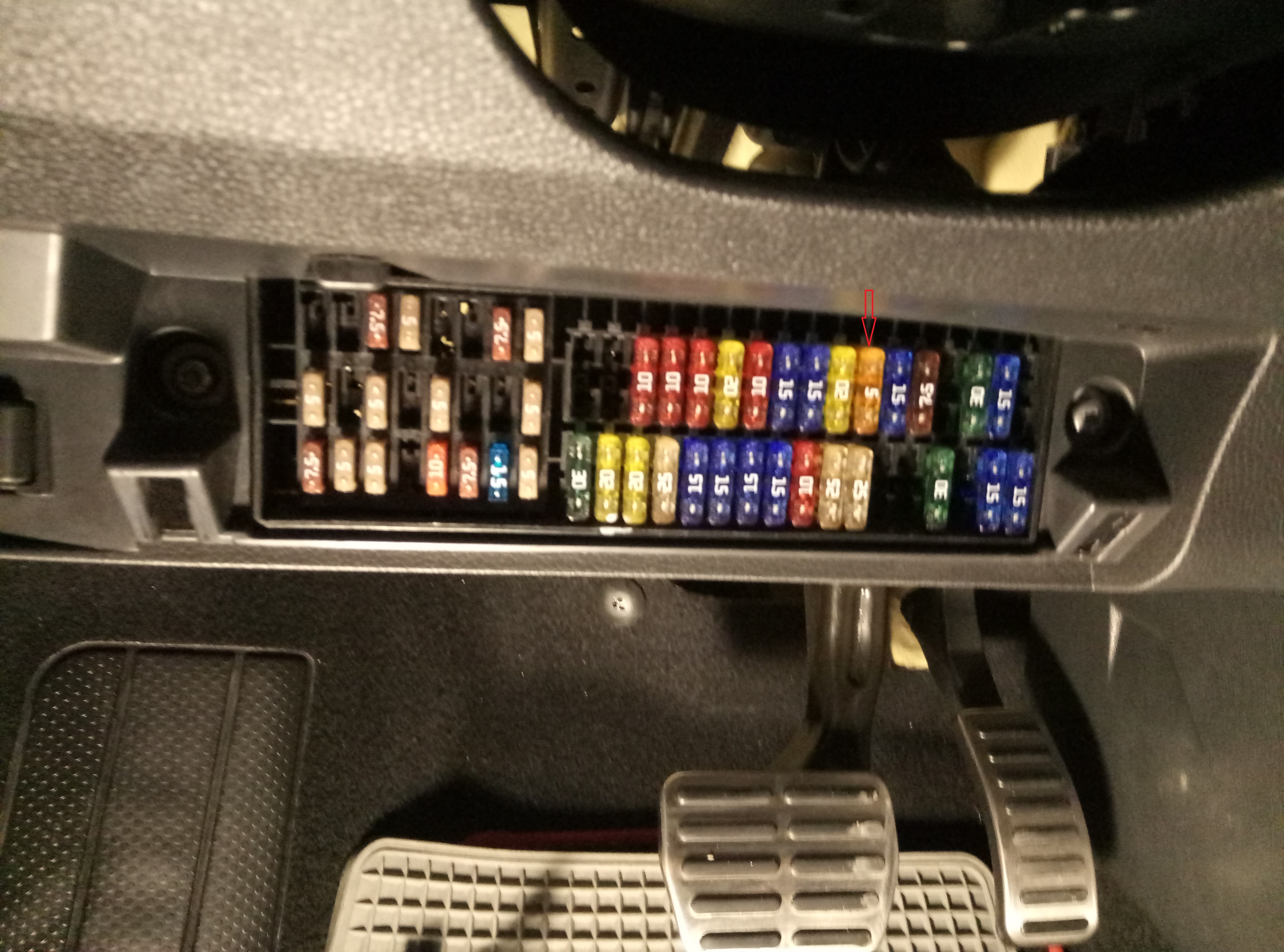

i ve install this kit in my Car but as other members fuse 35 (5A) went off , and  no dash lights

About fuse 35 , is there any solution ?

I changed fuse 35 for a 7.5A but that didn’t help, I then changed fuses 36/57/58 to 20A fuses but that didn’t help either, it still blew fuse35, so I returned the item.
however, when reading someone else’s instructions, I believe I should have changed fuse 23 (sidelights) to a 20A fuse.
So try changing fuse 23 to a 20A fuse and see how what happens.

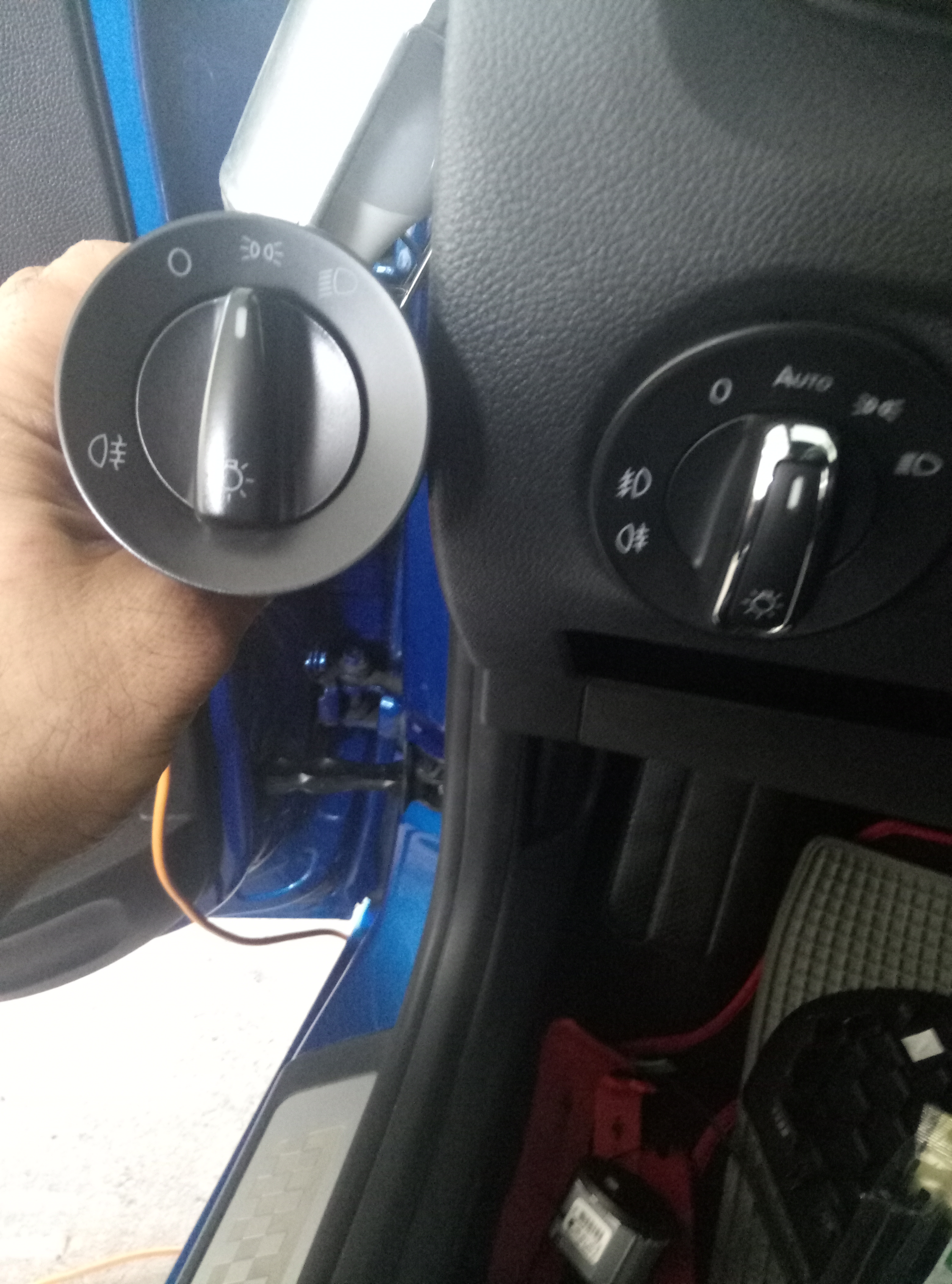

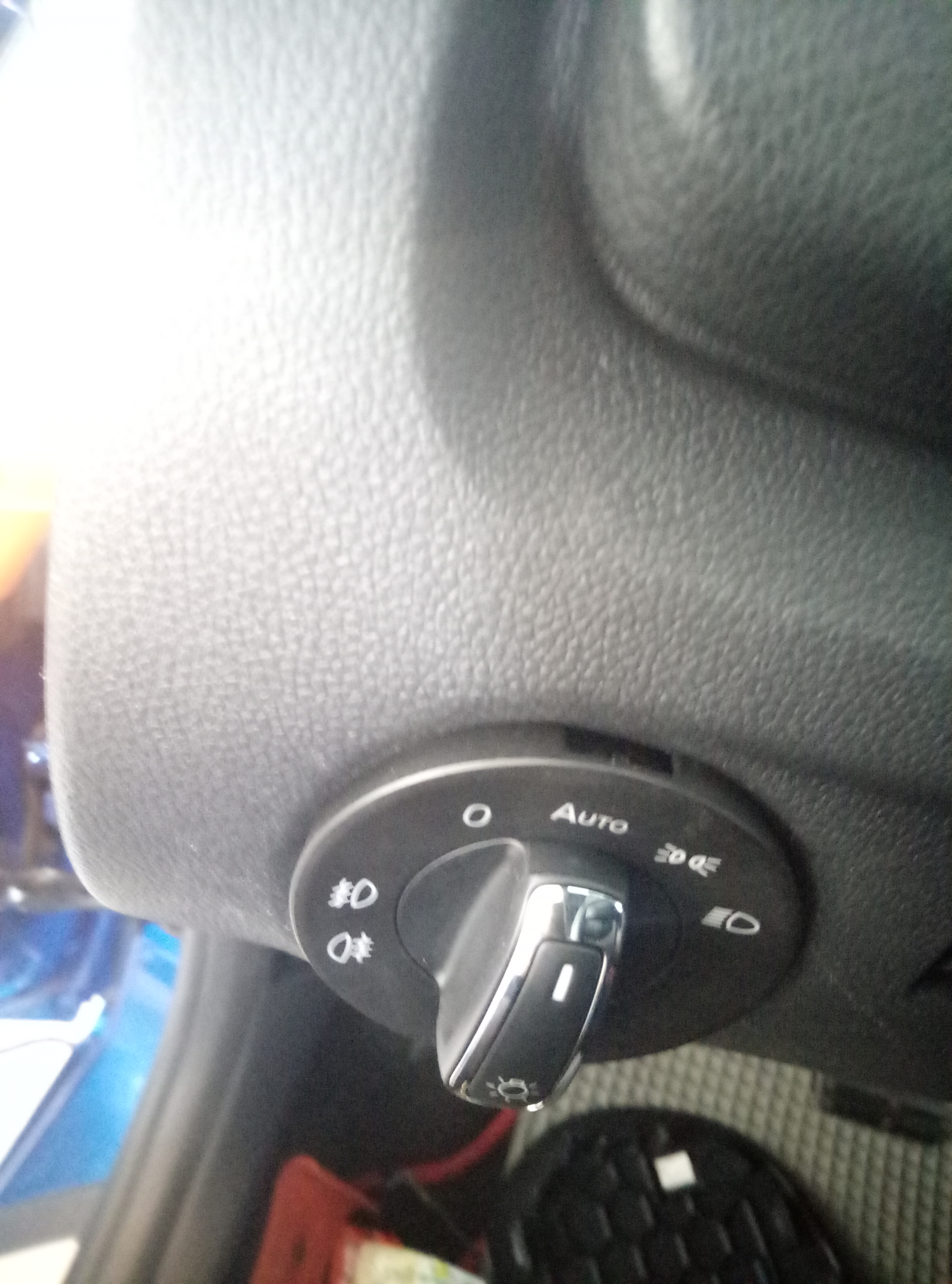

It is not possible my friend , the only way to fit the auto light switch is to increase the diameter of the switch hole in dash board, not good idea.
Or get a yeti one
When I fitted my auto light kit all worked ok except the front side lights. They don’t work at all.
If I return it back to factory fix everything works as it should.
Not sure if it’s the switch or auto control box just behind it.

there are different sizes of switch for the VAG, from memory the Fabia is a round one, others have an oval shape.

This is what I see when I remove my light control. Unfortunately, I think I'll need mine coded.
You just need to unplug the connector from the switch and fit the new Auto one, then feed the light sensor near the front windscreen. There is nothing to code.

The Yeti one has got the small plug, the other is the large plug like yours.
Just pull the switch out and compare the pin outs in the picture. On the pins you will see the abbreviations for the various light switch functions.
