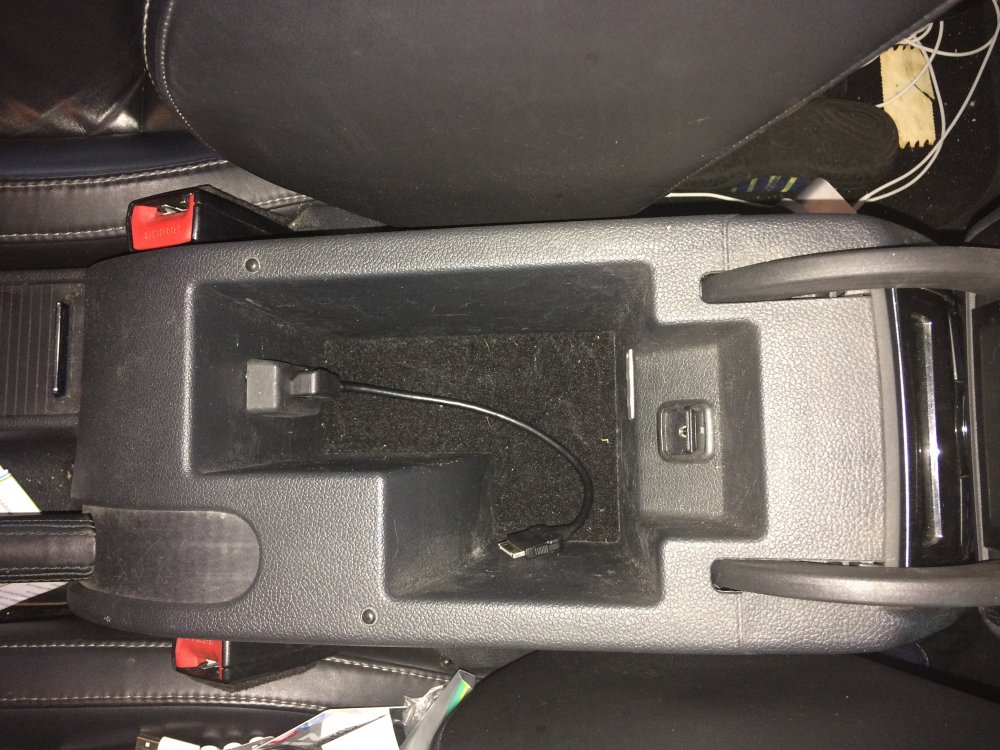

Sorry mine is a grey connection not white as I thought (see attached). I don't have a copy of the relevant manual handy, but I'd say if you don't have the plug then there would be no wiring to the area for it.

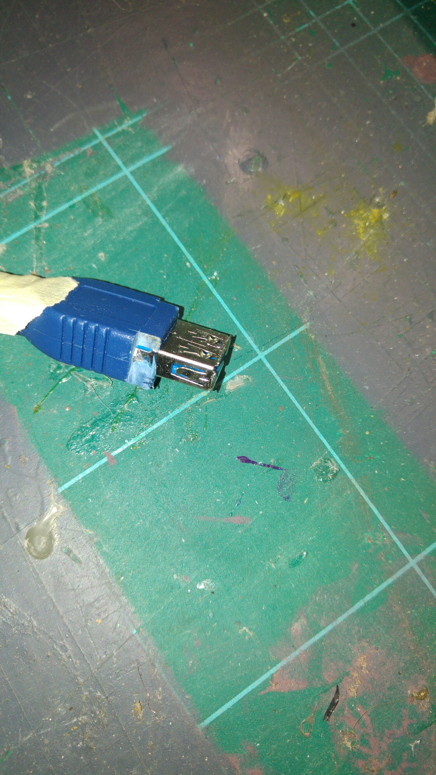

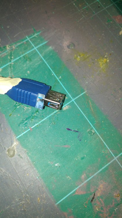

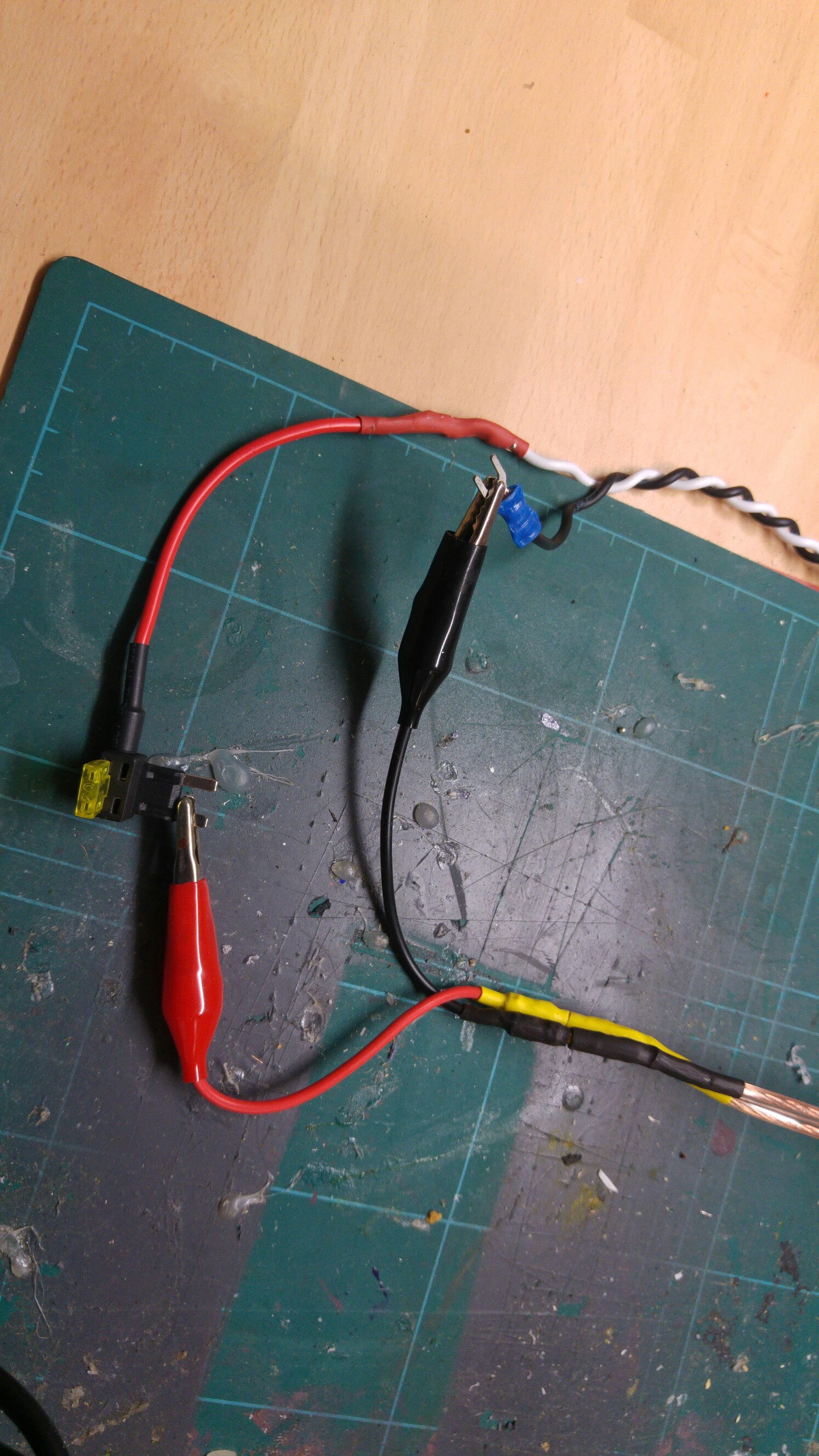

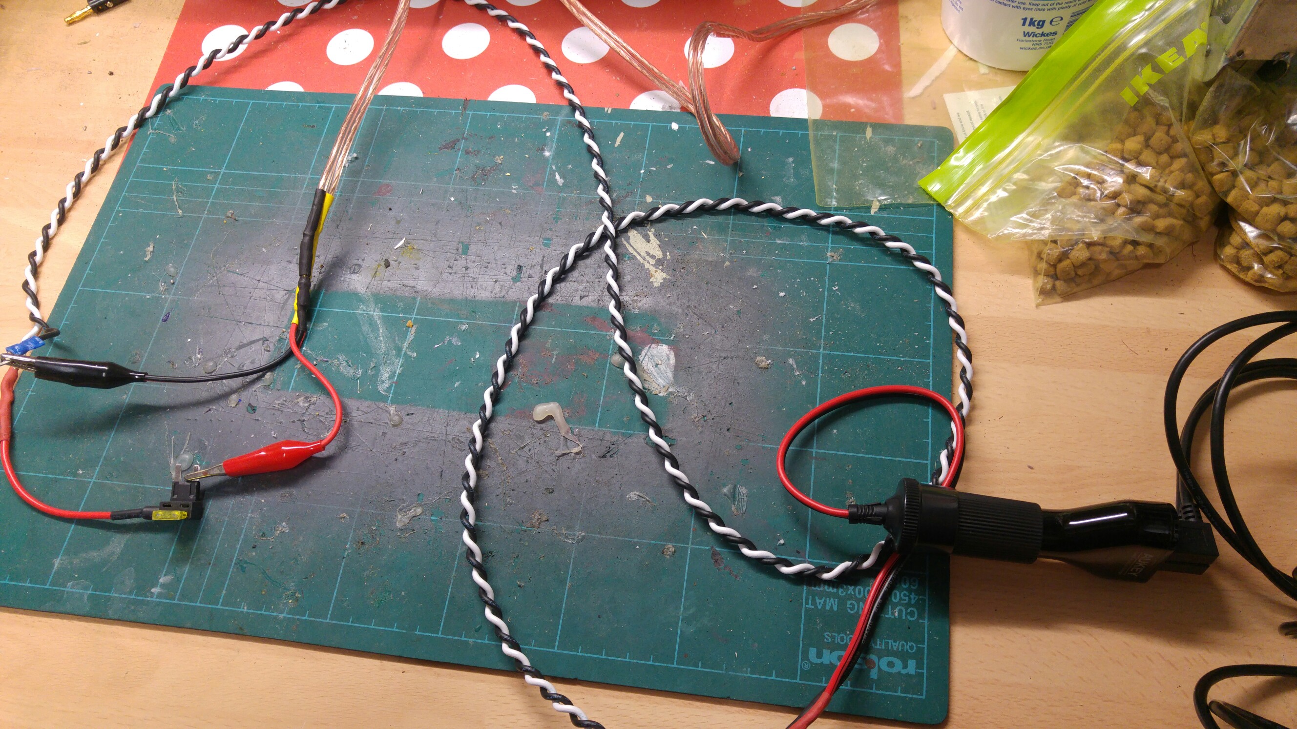

I've made a start, piggy back fuse, 14awg cable and adapter. 20170204_202158-1494x2656.jpg20170204_202208-2656x1494.jpg
Tested on my bench supply to make sure it's all working.

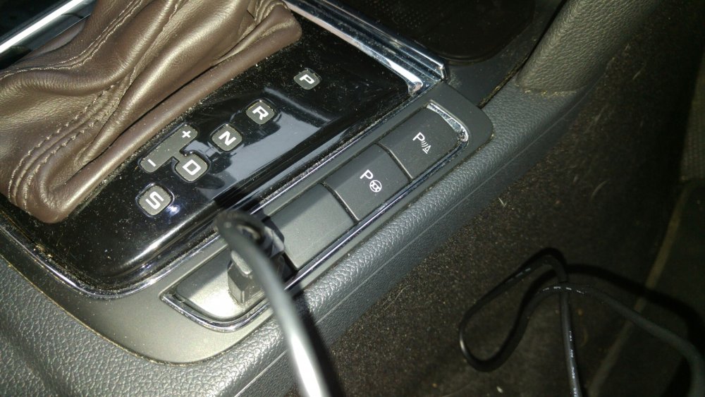

I've routed it across the back of the footwell, tucked into the plastic trim. I removed the side panel off the tunnel and ran it up to the buttons.

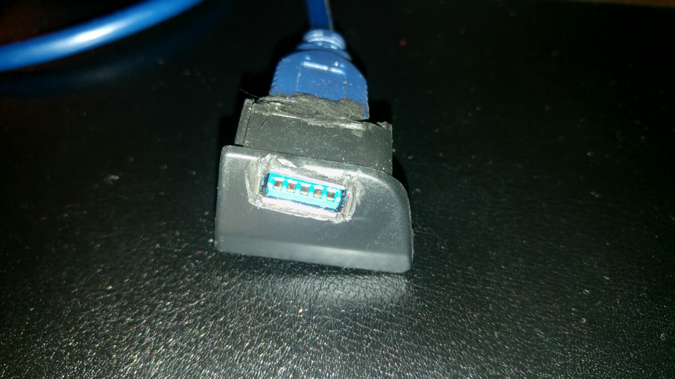

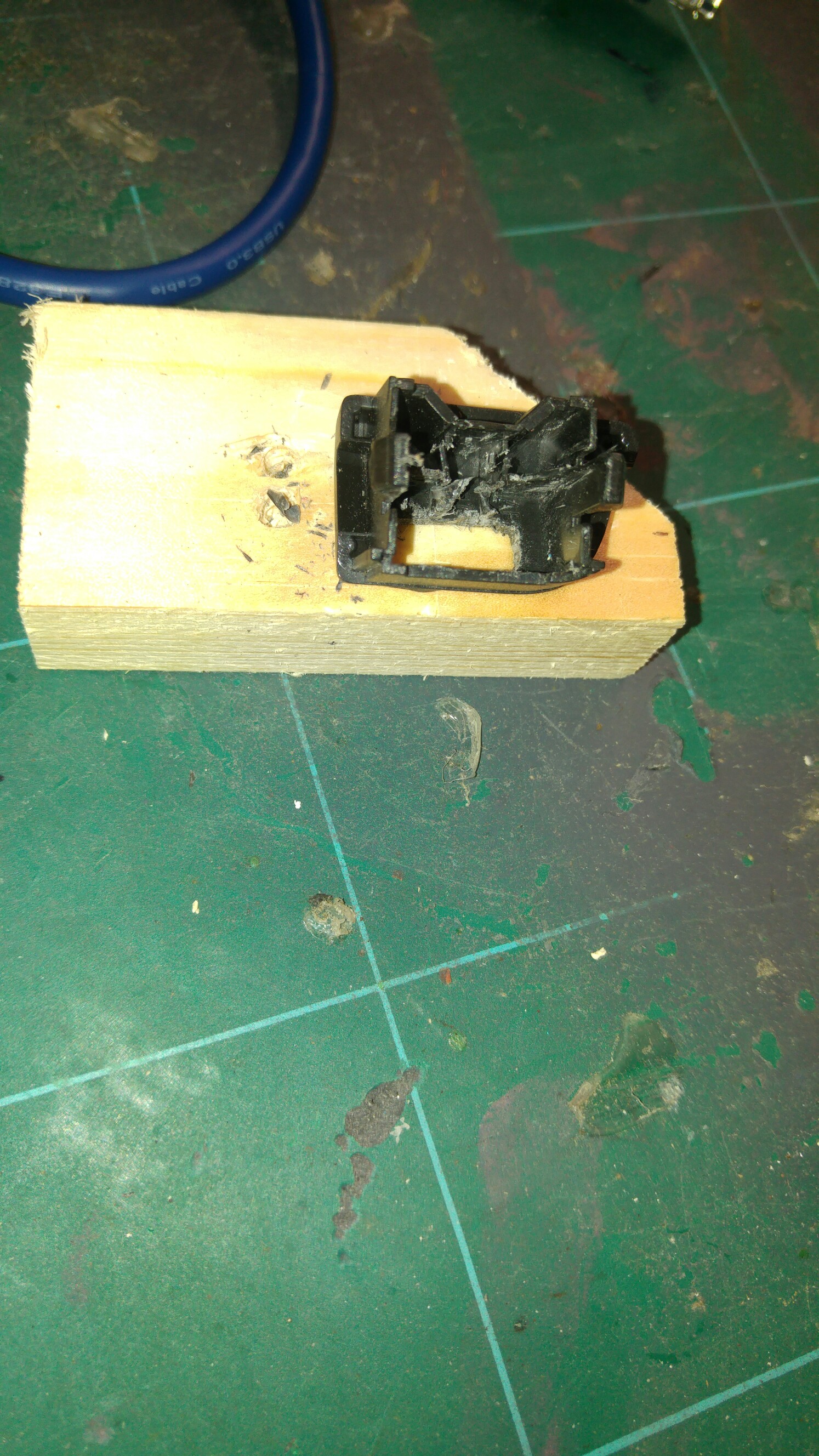

I've taken a blank out and started modding it. 20170205_140441-1494x2656.jpg20170205_140448-1494x2656.jpg

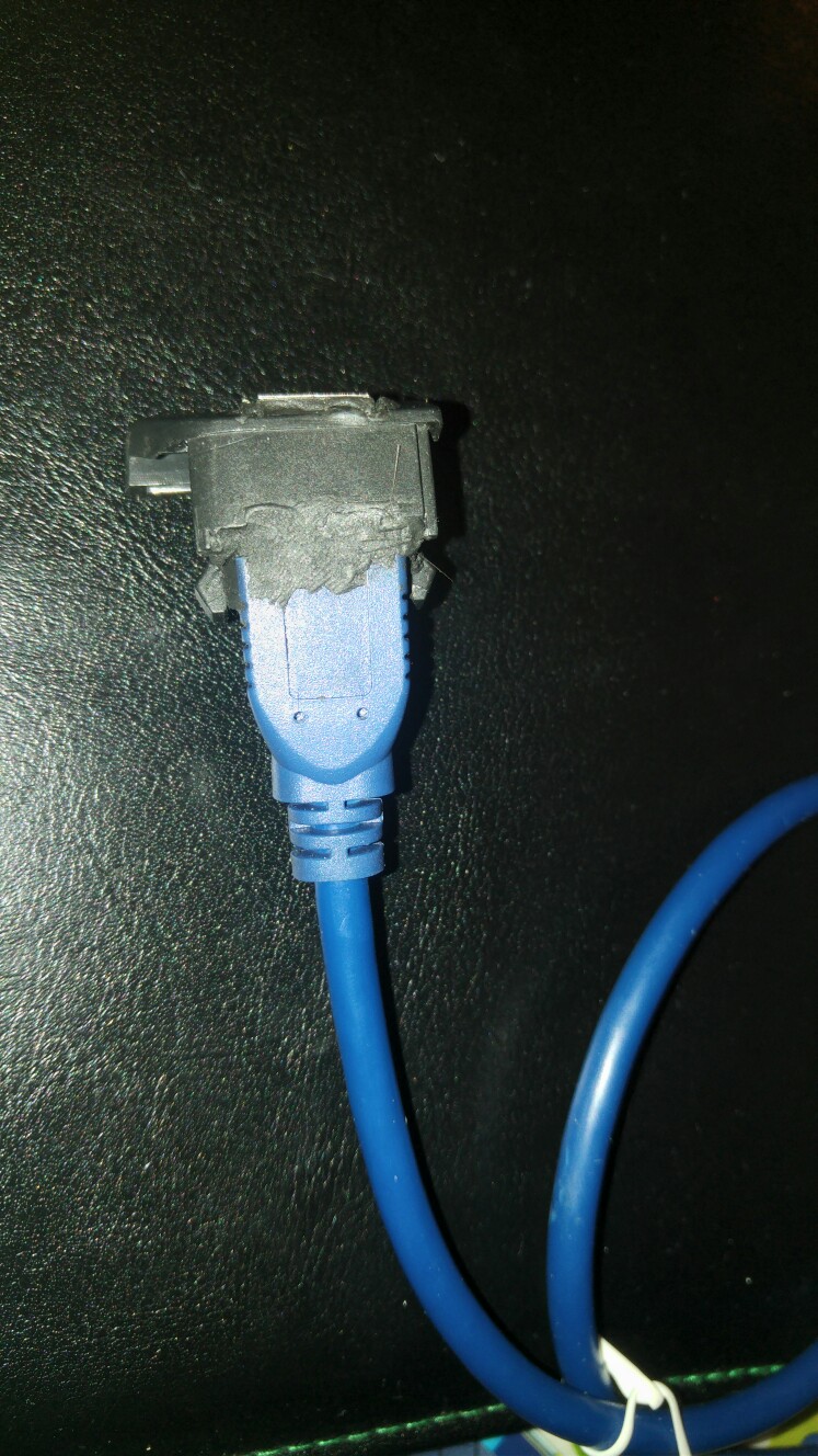

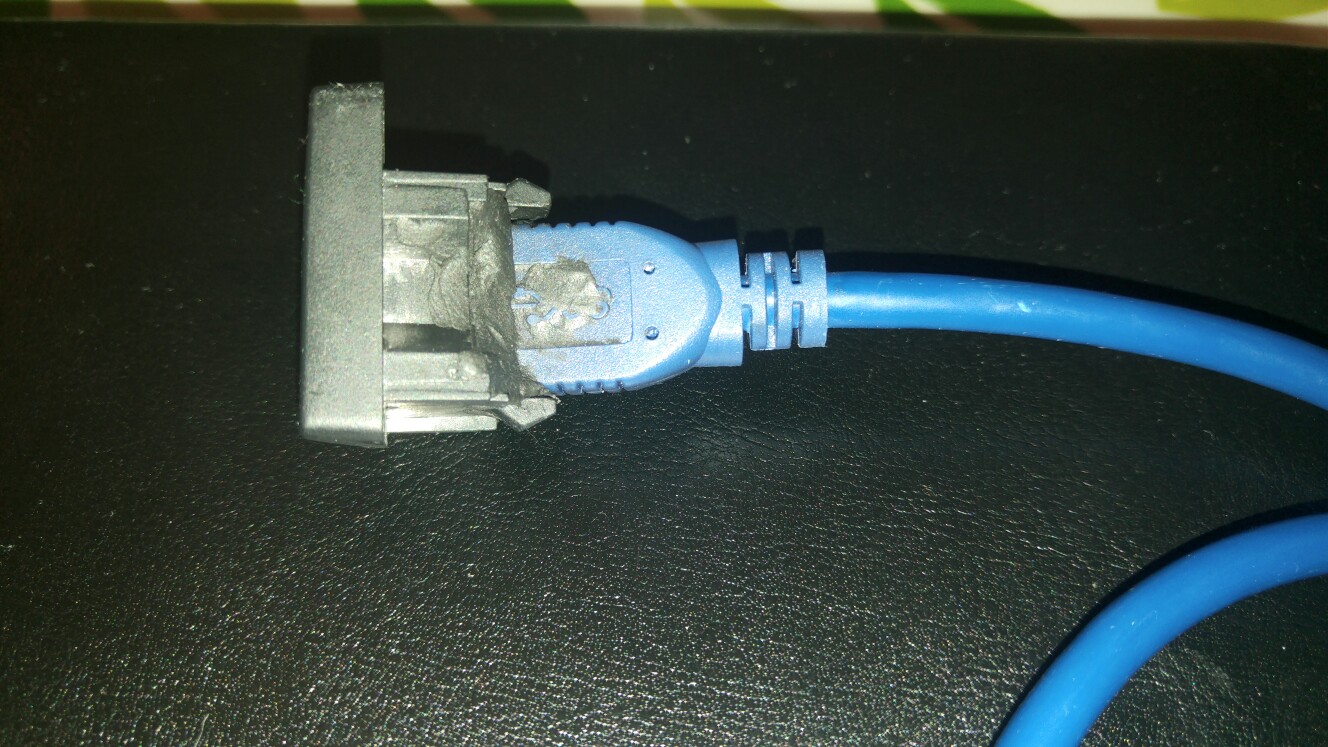

I drilled and filed it out to the right size. You can also cut with a decent blade easily enough. I've used sugaro mouldable epoxy to hold in the space and cover some of the cuts where they were slightly oversized. It's just setting at the moment.
Here is the latest status. I've got the cable secured in to the blank. Cuts are ok but could be better. Could always redo it at a later date if I wanted to. 20170207_060019-747x1328.jpg

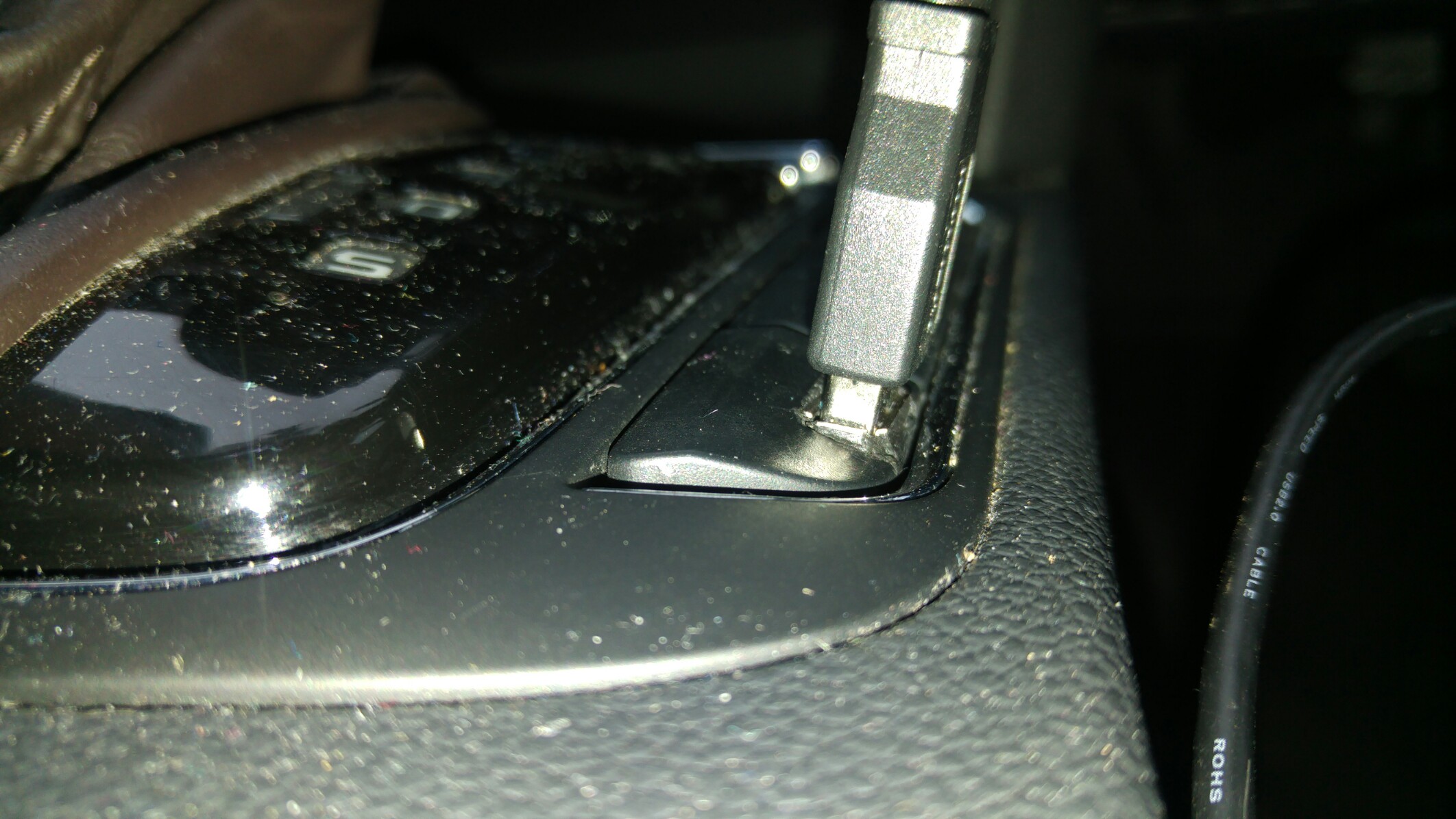

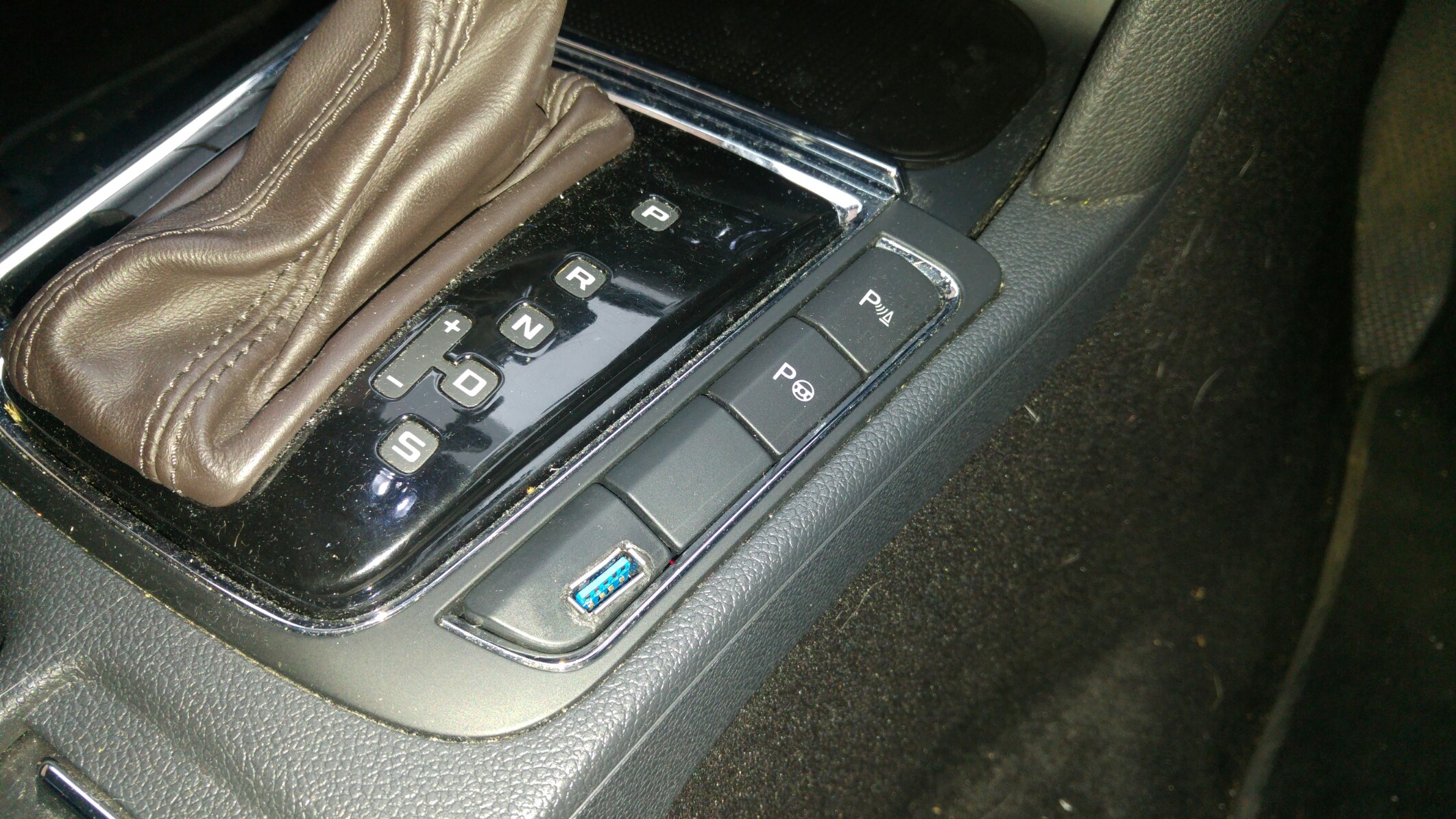

Installed the blank today
I've ordered from HK a right angled USB on both ends to reduce the cable height.
Got to do the other blank now.
