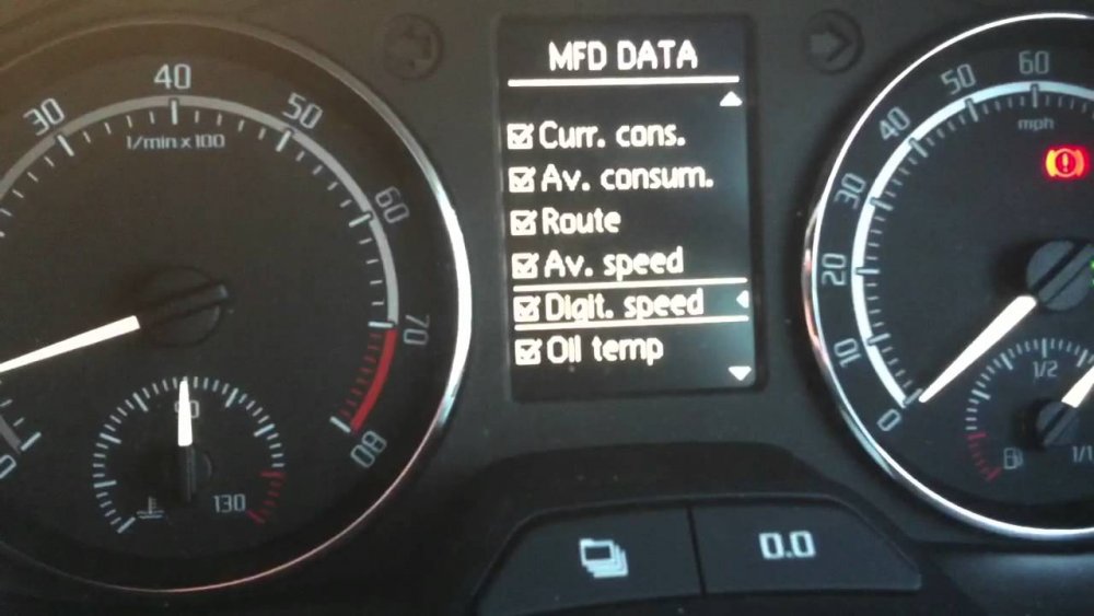

My Mk2 Fabia vRS has not been reading the Oil Temperature since I purchased last October and I've only just realised.
All it reads is --- I've had it going when driving to work which is about 20 minutes drive and by which time the Coolant Temperature sits in the middle where it should be but still no reading??
Anyhelp would be great, I have got it booked in for a health check in the 3rd February so was going to ask them to perform a ECU Update as not sure if one has ever been done since the car was manufactured back in 2010 as I've all the paperwork but it doesn't mention anything to do with any form of update.
I'm sure you turn it on in the setting on the maxidot or it needs to be turned on with vagcom I've seen other people put threads up about this
You can go into the menu and tick what you want to display, Average Speed, Range etc & that includes Oil Temp.
Except if someone has messed up changing Fixed Servicing to Variable, then Oil Temp can get lost.

I've turned it on in the maxidot but still not showing, really don't have access too vagcom and even if I did I wouldn't know where to start lol
Cheers buddy have got it clicked on, at present I have no service plan setup as was going to sort that out on the heath check, how do I change from fixed to variable in the menu and will Skoda reset it if they do carry out my services as was thinking I may do them myself...
You can not, the last technician that was setting it messed up.  I doubt Brian had Variable Servicing set.
So you need VCDS or someone to do it for you.
It is Fixed you want back to.  9,400 miles (10,000) or 372 Days.
