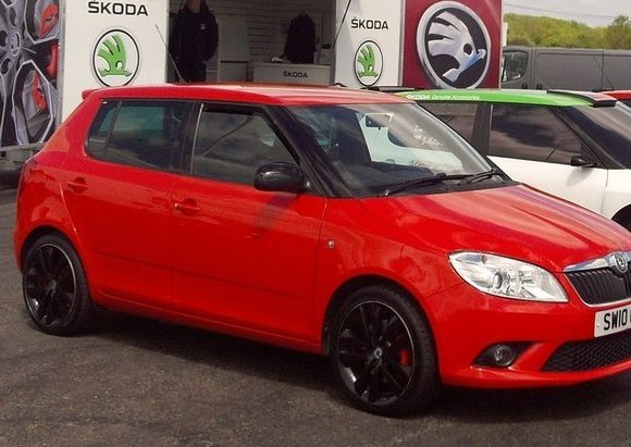

As they should be, all red. (Black wheels though)
 Naths, yours and mine were triplets built at the same time.

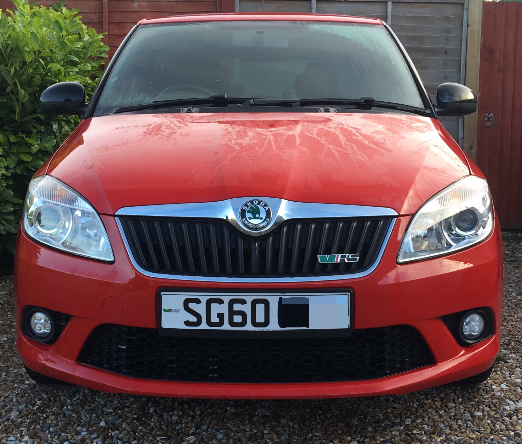

Ohh didn't realise mine had sisters lol, I'll give you a flash if I see you buddy, I'm in Sussex by the way and I've got new surrounds for my number plates so I should be easy to spot buddy is your SG60 also?

Number plate is pretty smart better than the standard yellow, how did you get the VRS logo on? Am I right in thinking you can only have standard yellow or white background only.

It's a standard uk number plate that I got made up, internet order...all I did was type into Google vrs.png which will give you the logo with a transparent background. Use any decent show plate website that does LEAGAL plates and upload it as the badge to either side and hey presto there you have it, also got it on rear. Just be sure to use your legal font and spacing.
I have attached the vRS Logo that I used, sorry but I can't remember the site I used to order them from...
