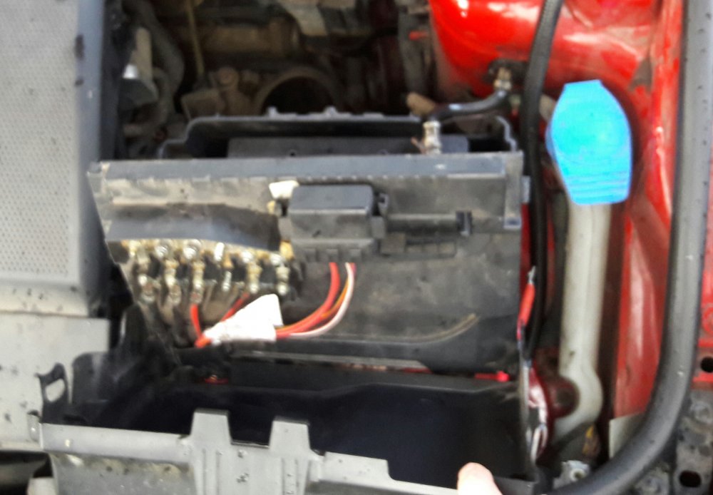

Check the strip-fuses  in the battery box fuse holder first. Very common for the ABS one to crack. Simply opening the battery box to charge the battery may have finished it off.
Wino just where in the battery box will i find it .
  • Sponsor
The fuse panel is directly beneath the lid, it separates when you release the two catches on the sides of the lid:
Apologies for the lack of focus, it started peeing down with rain just as I was opening the bonnet so I was in a hurry!

Wino so sorry but i am in the rifght place .Just put the wrong car model in the post to start . It is a Fabia 2003 .And thank you Wino,  and Spulchrave,  thanks to you both i have located the fuses in the battery box lid .I looked in there first but never investegated enough .All the fusable links look fine along with the normal fuses . But i have seen some place a way to reset the lights with the trip button on the speedo i did this just know .But no change .I think now its time to get the VAG1552 on it . This only came about after i removed the battery leads to charge it up .I waited 30 mins before starting it up . So do you think its the best thing to do .Thank you .

To -day  the auto electric  chap was searching about in the fuse box
He checked the strip fuses to find the one for ABS was loose .
After it was locked  up , the light is no longer showing .

Well if i had just checked the fuse nut that holds the blade fuses in i would have found it myself .The nut was loose and making spasmodic conntact  Wino thanks.
