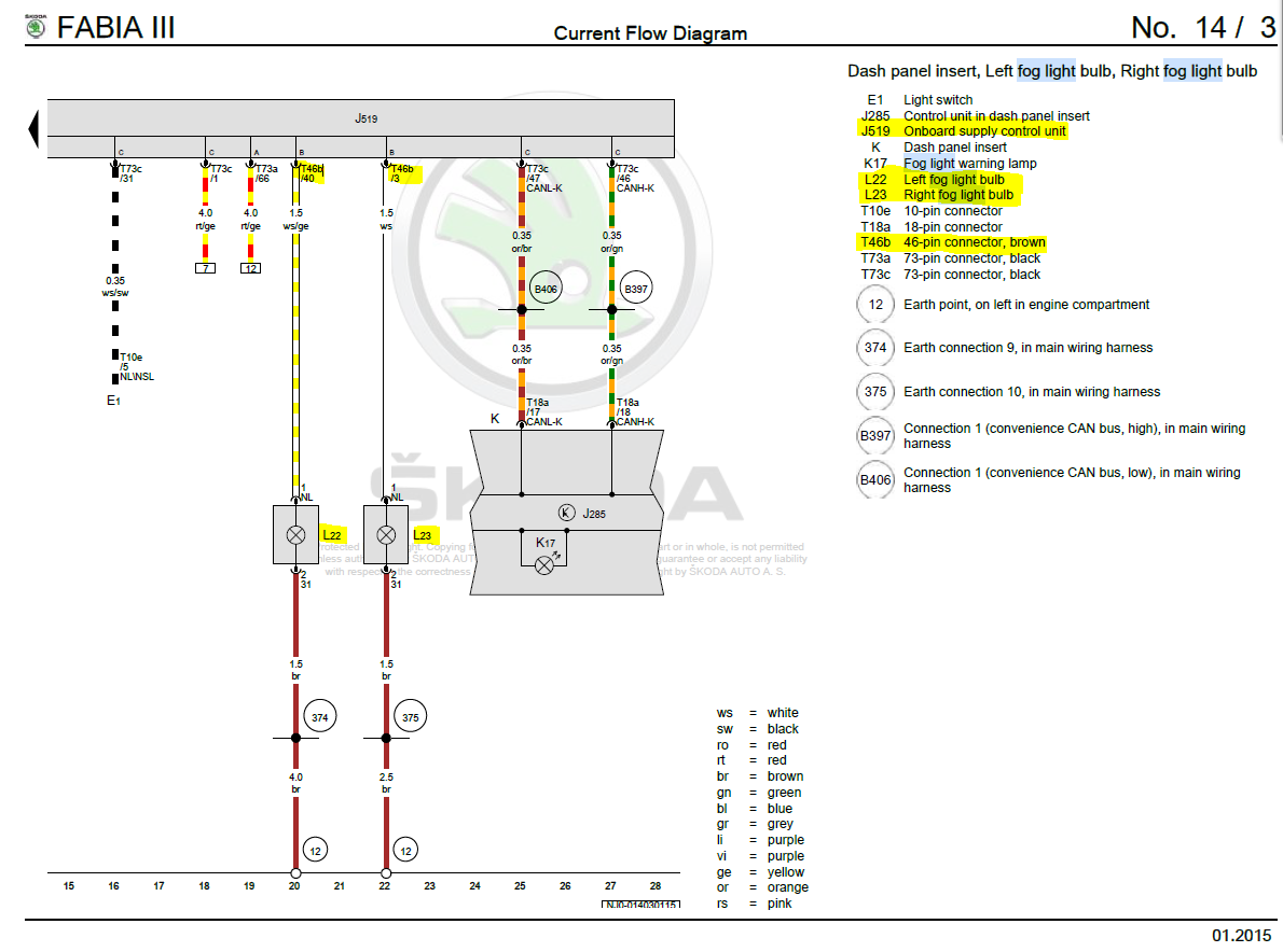

Sorry to raise this thread from the grave but I have just ordered the Fog Light Retrofit kit from aboard (Skoda Parts confirmed it will work with my VIN)
What I am in need of is the wiring guide / instructions of how to fit the kit onto the Fabia. @malcsterdo you have any powers to links for this retrofit etc? Or is it available on erWin after I pay the hour access fee.
I have all the workshop manual, electrics, body, etc etc but wondered if there was a direct repair guide that VW / Skoda techs use to retrofit.
TIA.

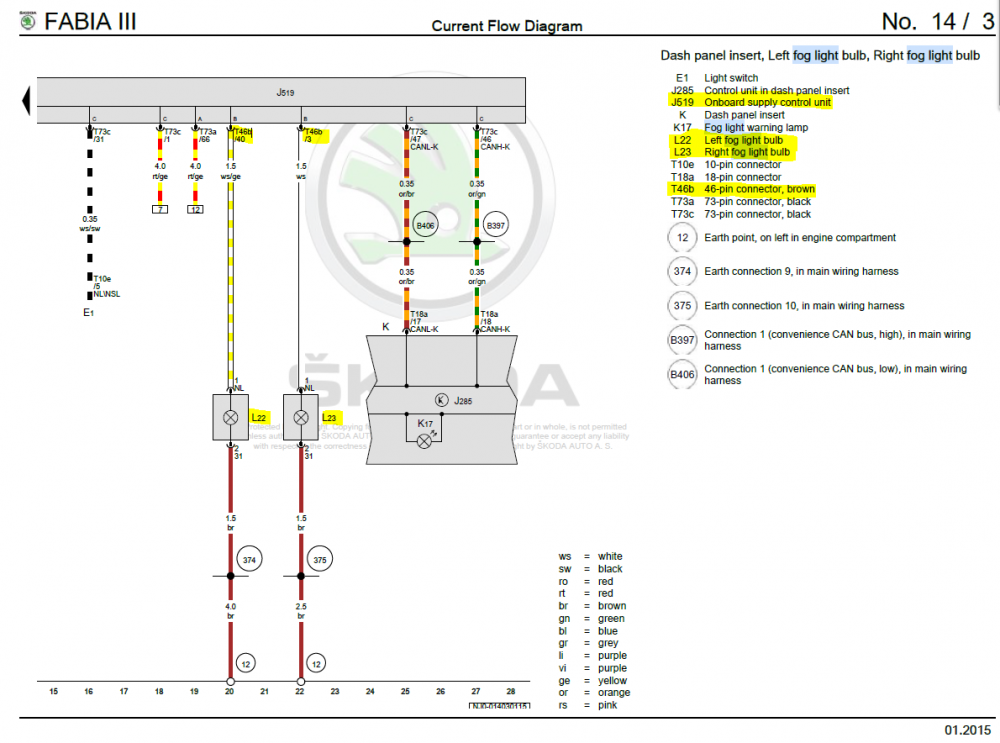

I think I have found how to do it using the Fabia wiring diags and some forum jumping.
2 wires from each light (L22 and L23) - 4 in total. 2 go to ground with the other 2 going into the cabin and connect to Pins 3 and 40 of the brown plug (T46B) connected to the BCM (J519)
VCDS will 865936223_FogLights.thumb.PNG.e3b1dc7215fe271a6244bca99b3b202a.PNGobviously be needed as per previous posts above.
Will not work without VCDS coding mind.
That is correct yes :) - Kit comes with instruction booklet on where to run the cables etc.
