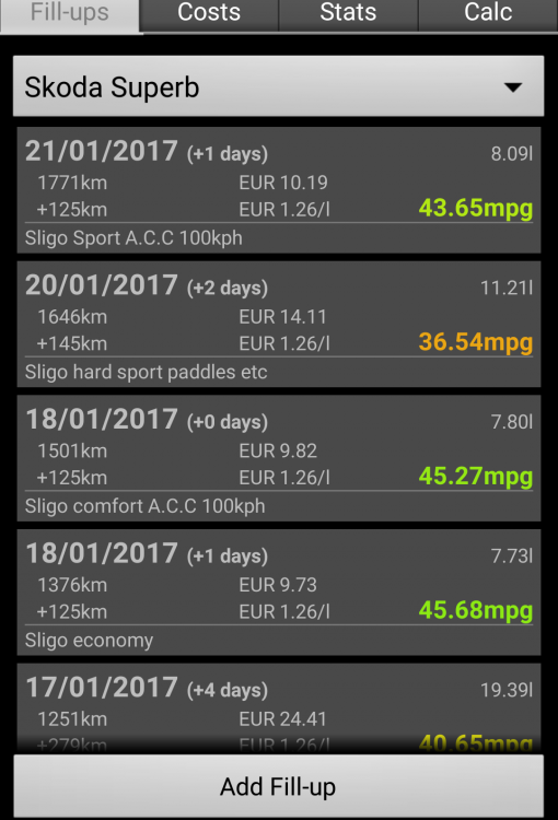

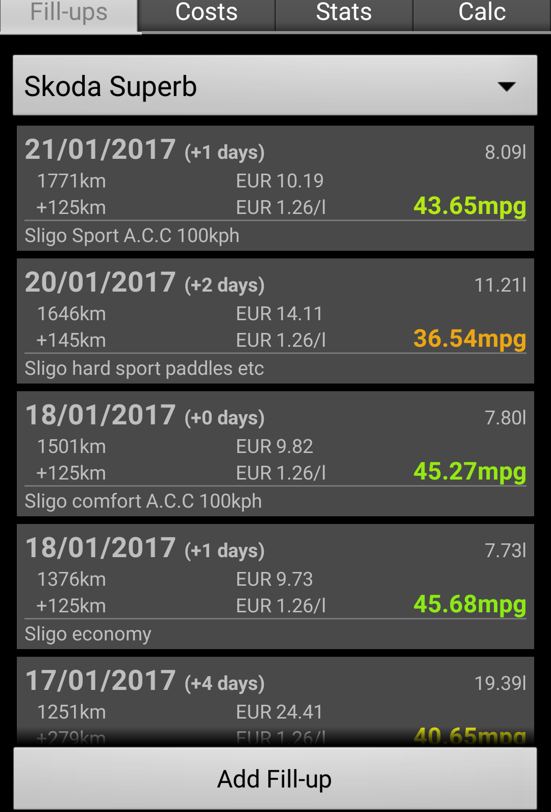

I have the 2.0tdi 190bhp and I use a app for inputting the fuel records. I did three runs with it, all the same time of day and all the same length return journey. Each record states the driving mode used. Not the same as your car I know but yet same idea as you have. The destination was sligo as shown on the picture.
