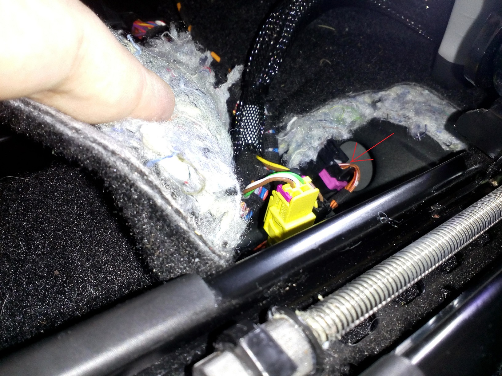

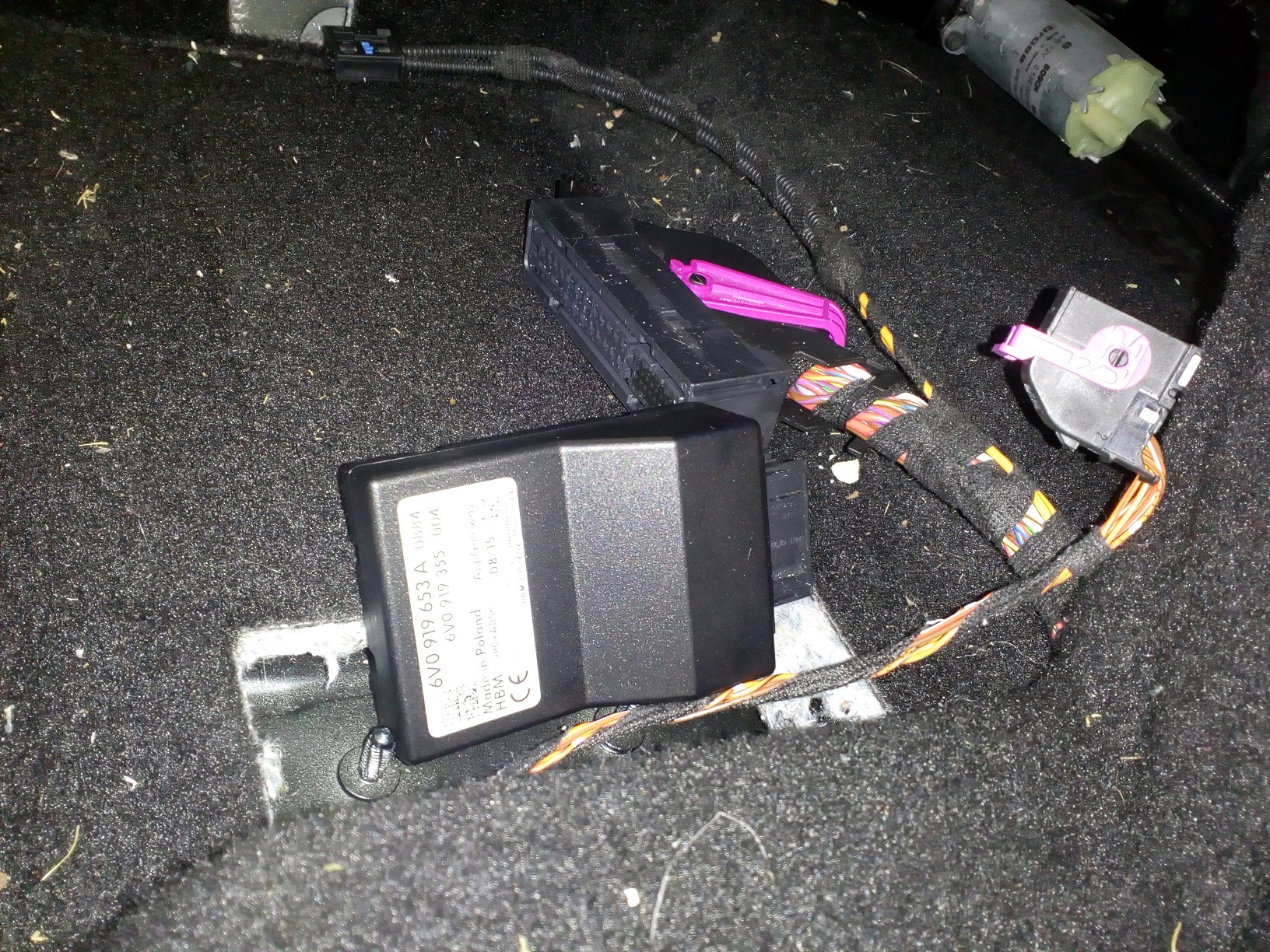

And then i've found it! It was not easy to find, and it was well hidden under the carpet.
To make it a little easier to locate i removed the amplifier under the seat.
I disconnected the cable and waited for about 3-4 minutes, and then....voila! The default password returned! :biggrin::thumbup:
