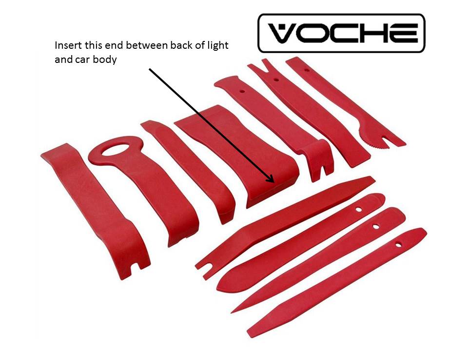

Hi I had same problem. Using the hook for wheel trims tends to try and pull light cluster out at wrong angle for the locator pins. I invested in a set of plastic trim removal tools. I used the one shown and the attached pic. Inserted the broad hook end between the lamp cluster and the car body. Gently prise in up and down movement as you pull the lamp cluster back in your other hand. Hey presto it popped of with no problem. I've used this several times no problems no damage to paintwork. I also you silicone grease on the pins to facilitate later removals.
Tools are available on Amazon:
https://www.amazon.co.uk/Voche-Piece-Panel-Removal-Tools/dp/B01ITI9ZJ6/ref=sr_1_1?ie=UTF8&qid=1486647580&sr=8-1&keywords=car+body+panel+and+trim+removal+tool+voche
Good luck
