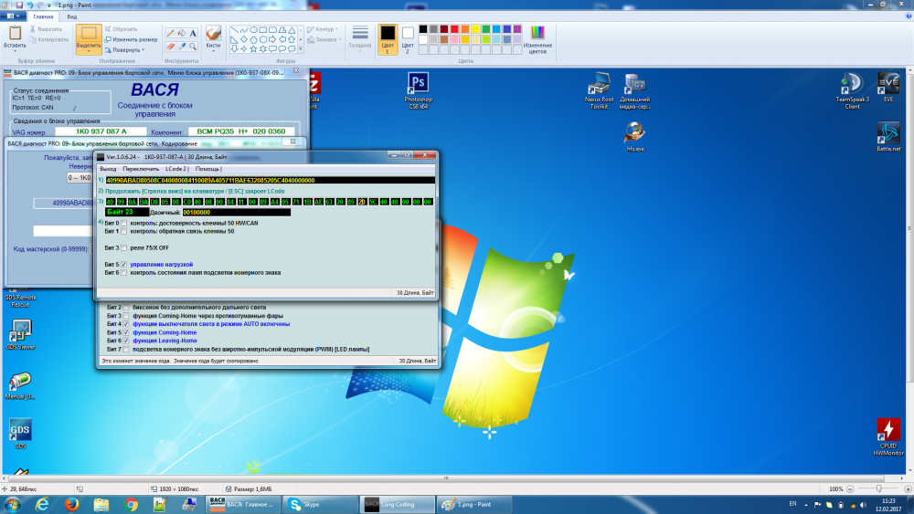

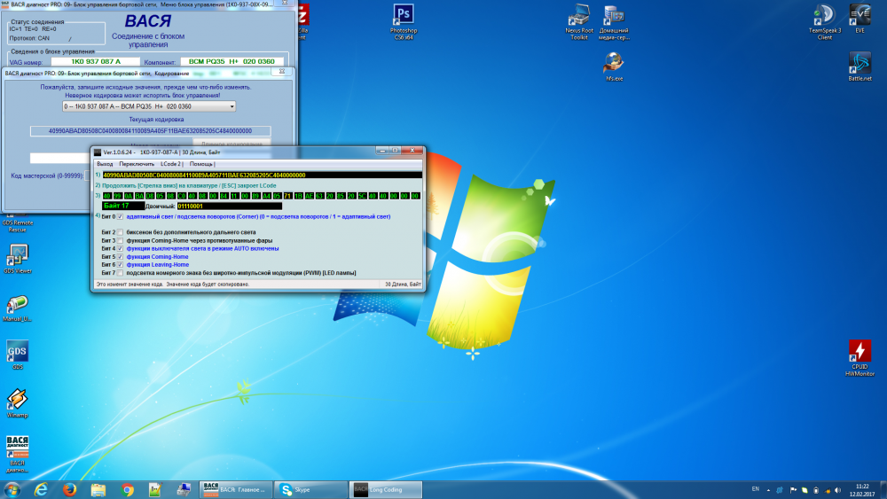

Hello,
I have superb 2008, 09 model (3T, mk2)
I swapped all lights to LED, no error appeared except rear licence plate.
I have I believe VCDS (but Russian variant, called vasyadiagnost, live in post CIS country):
Where I go to 9 block, byte 23, bit 6 disable
And 17 byte, bit 7 enable
And this coding is saved, but error appears withing few seconds after erasing it. I tried turning off and off car, locking, unlocking, leaving overnight, driving 50-100 km. Errors shows up anyway. Other adaptations that I tried - work no problem, except this one.
Can anyone please recommend me where to look?
