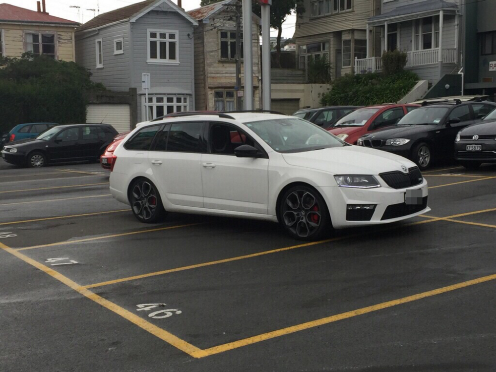

Got them installed today, really pleased with them so far. Didn't have a chance to have a long drive so I'm sure my thoughts will change in time.
22mm Superpro rear sway bar, KW V3's, lowered a further 20mm from stock.
Edited by mabnz
22mm Superpro rear sway bar, KW V3's lowered a further 20mm from stock.
Does anyone have any experience with spacers on the O3? I've read 10mm is probably fine, but not sure if I need longer stud bolts?
Edited by mabnz
I have 10mm front and 15mm rear hubcentric spacers, with the same wheels as yours. Don't use any non-hubcentric spacers, you will get vibrations.
Longer bolts definitely needed, and make sure you get radius seated ones to fit OEM wheels. Makes a big difference to the look IMHO.
Also remember to keep standard bolts in the car for your spare wheel, or make sure you keep the spacer in place with the spare, otherwise the longer bolts will go right through the hub...
