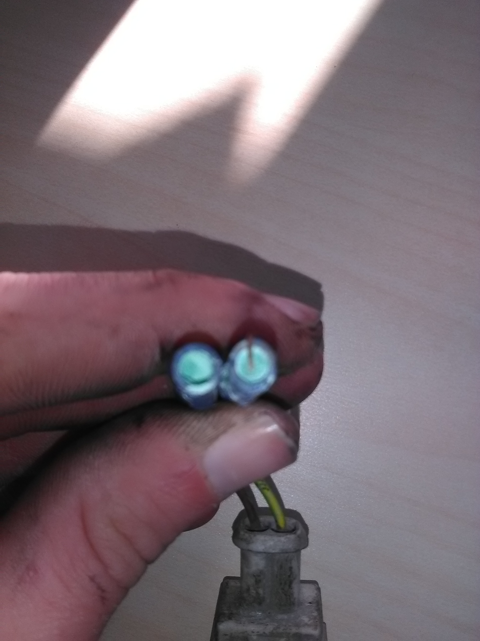

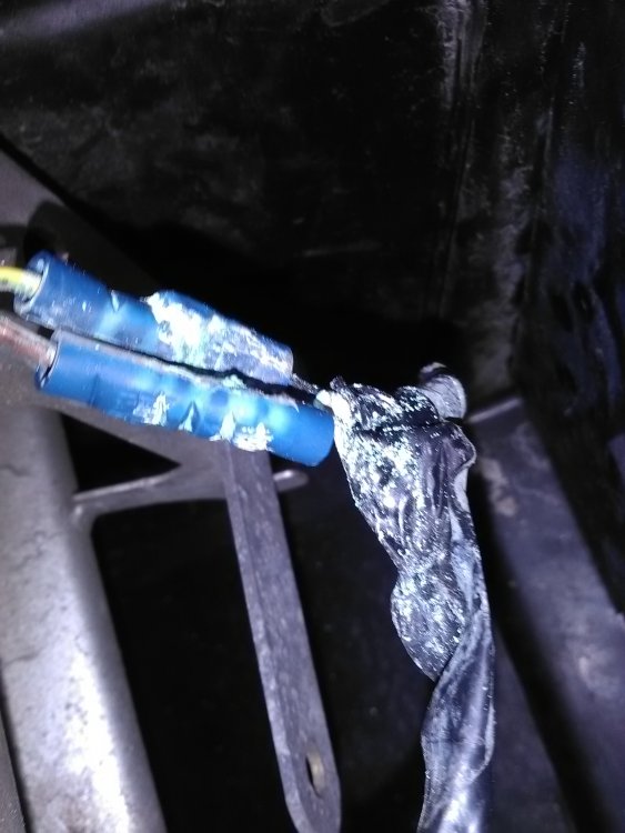

Hi Ricardo,
Good question, and I find the problem. The wiring is in two pieces, and there was a bad connection. ( see pictures )
Thanks for the help.
The lesson we learned from this topic is this: if possible replace the entire length of a broken wire, especially when there are high currents involved. If the broken wire can't be replaced, crimp or solder the ends and protect the area with heat shrink tubing that has glue inside. It is vital to seal exposed wires from the elements.
It's always a potential problem area where there are joints in wiring. And so much fun (not) in tracking them down.
