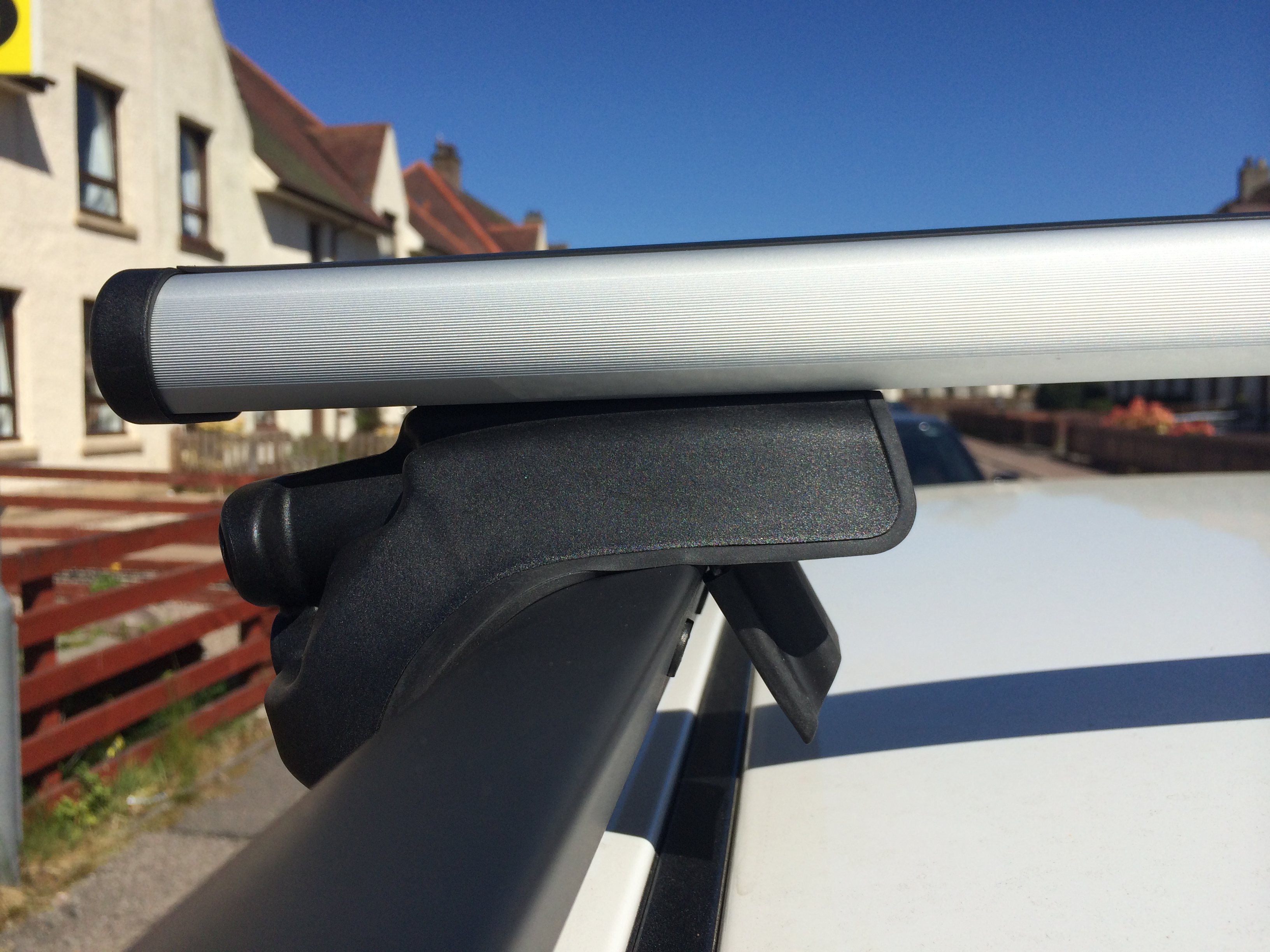

I have just bought these roof bars G3 Aluminium Roof Bars to fit Skoda YETI 2009 Onwards With Raised Roof Rails *
But can't get them to fit properly, has anyone else used G3 bars with more success than me.

Can you reverse the arm sticking down through 180 degrees so it grips the bar instead of point away from it?
Colin
No eribaMotters it only fits one way, I bought from Mick's Garage .com and watched the youtube video of them fitting this bar.
But the car they used had narrower rails than the Yeti, so I think they may have to go back.
Sent them photos but I can't see any way this is going to fit.

Mick's garage have concluded that G3 bars are only combatible with Yeti up to 2013 and are going to refund fully including cost of sending them back.

Well the roofrack i built to cary four bikes for my 2010 yeti fitted perfectly to my facelift 2014 one.
There is no difference between the cars so his conclusion is wrong!
My bars (See for sale section) fitted the "original" yeti & the facelift model. There is no difference.
The roof rails are the same shape and size across all the years. The only difference was the dropping of one bolt hole each side.
I would say they have sold you a pair that have been incorrectly packaged/labelled.

That's crap. If they fit a 2012 Yeti then they will also fit the latest one as the bars are identical.

I have come to an arrangement with Mick's Garage to swap the G3 bars and try the Nordrive ones. So Max i will let you know how it goes, unless you have gone down another route.

Nordrive Yuro bars arrived today and fitted, just going to test drive for wind noise, will post pics. later.
Much better fit than last lot so pleased so far.
No wind noise to speak off and look the part.
