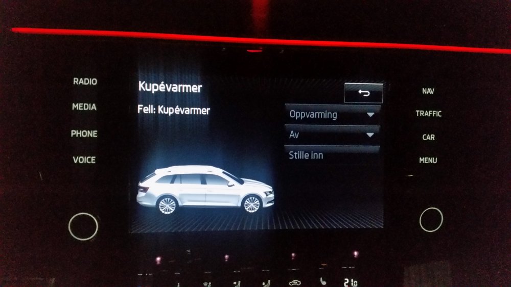

I have some problems, maybe 50% of the time when I take the settings on the Amundsen when the car should be warm.
I have used it 3-4 times, but 2 of the times webasto hasn't started. Do u know what the problem could be? I dont get any fault-massage either what the problem could be. Just this:
(Feil: Kupévarmer means Fault parking heater in Norwegian...) :)
The webasto has never failed to start when I use the remote control.

Should not start on low battery levels, maybe this?
Mine works perfectly, though I start it with remote mostly. Sometimes I top up the battery with ctek, but it never charged for no more than half a day, so wasnt ever seriously discharged I guess.
It doesn't start when Fuel tank in red.
have set timer just two times, mostly start from remote control
Its enought fuel on the car, and I don't think it is the battery either, because I can start it with the remote control. But of course, I can take the charger and top up the battery and see then. :)
I´ve experienced this once, dont know why.
Get an auto scan to check for fault codes.
The batterycharger indicates at least 80% full battery, so then I just have to drive the car to the dealer I think...
I looked at the coolant level in the car, and it is entirely down to minimum. Could this be why Webasto will not start? The factory fills well only on minimum liquid on the car to save money so that it stands on the minimum does not surprise me...
So, could it be so easy? :)

Have someone unlock it via VCDS. It's not in a locked state.
See this link for info http://blog.lausdahl.com/2011/12/unlocking-webasto-aux-heater-on-a-vw-touran/, though not for Skoda but it's the same principle.
