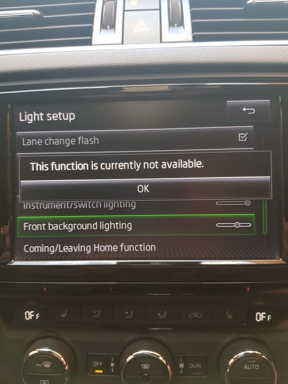

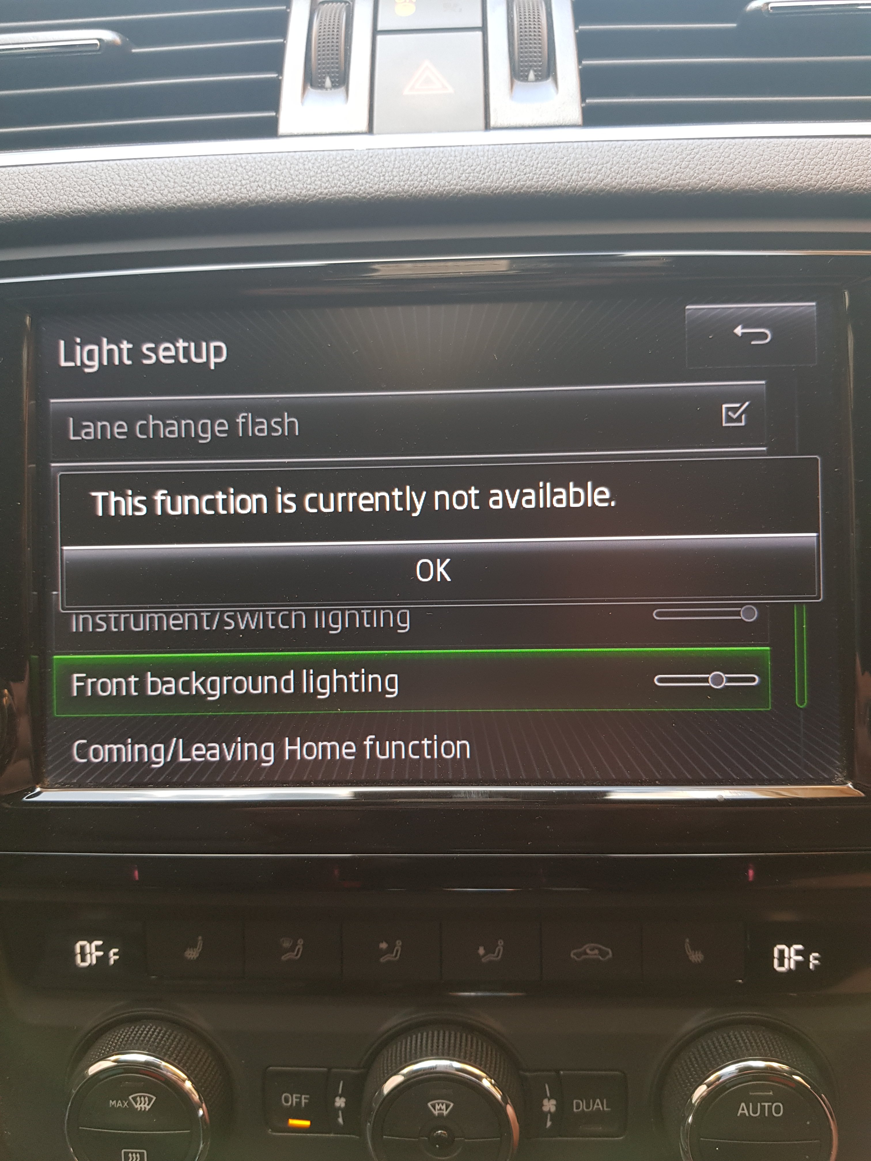

Need more help on this. I've followed the instruction above, I've got it on th screen but says it's not available.
Anybody tell me where I'm going wrong.
2014 octavia vrs with big nav columbus 2018 maps on it

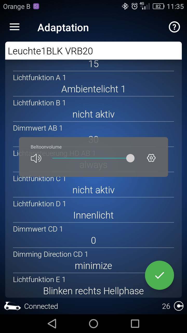

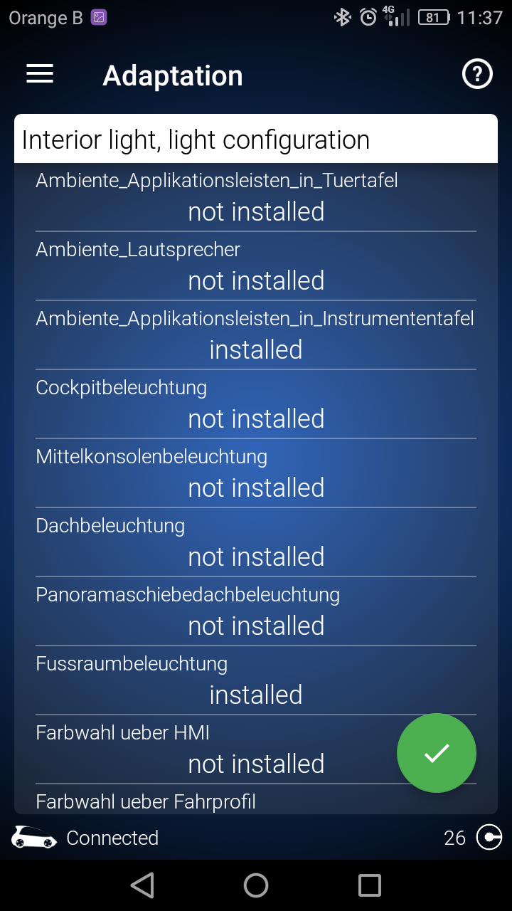

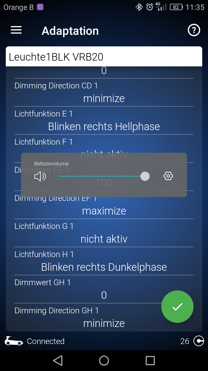

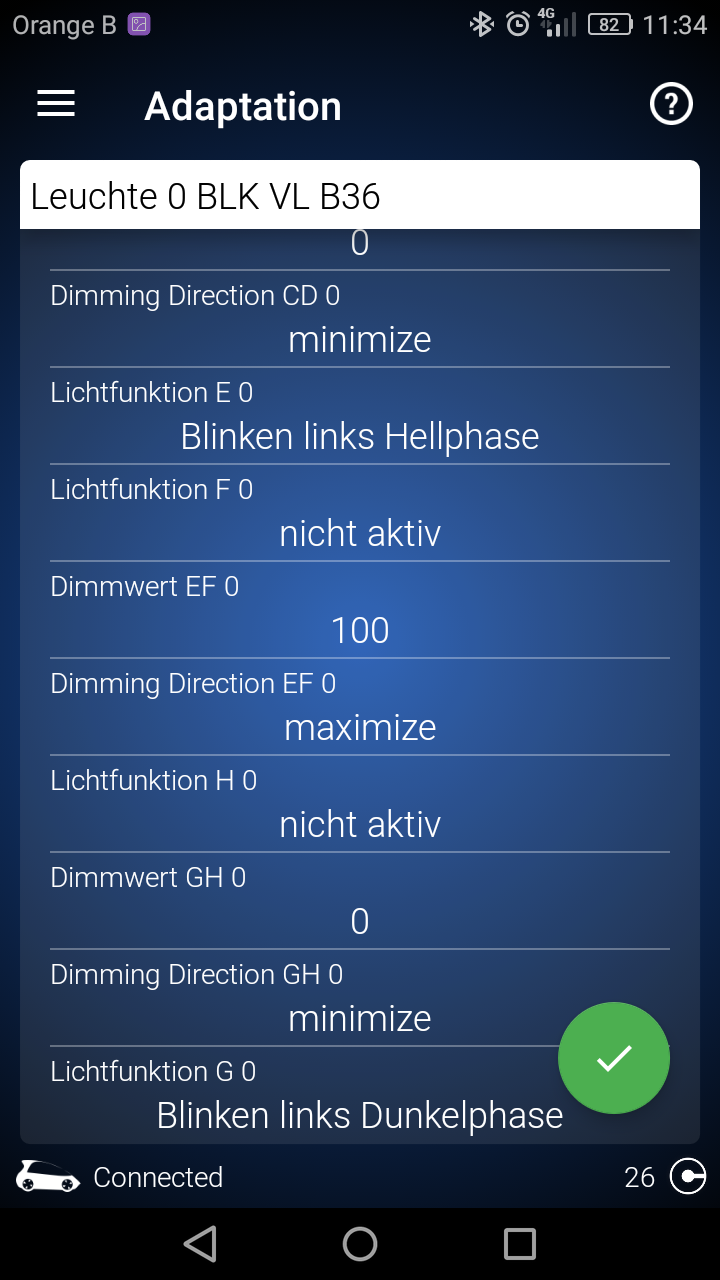

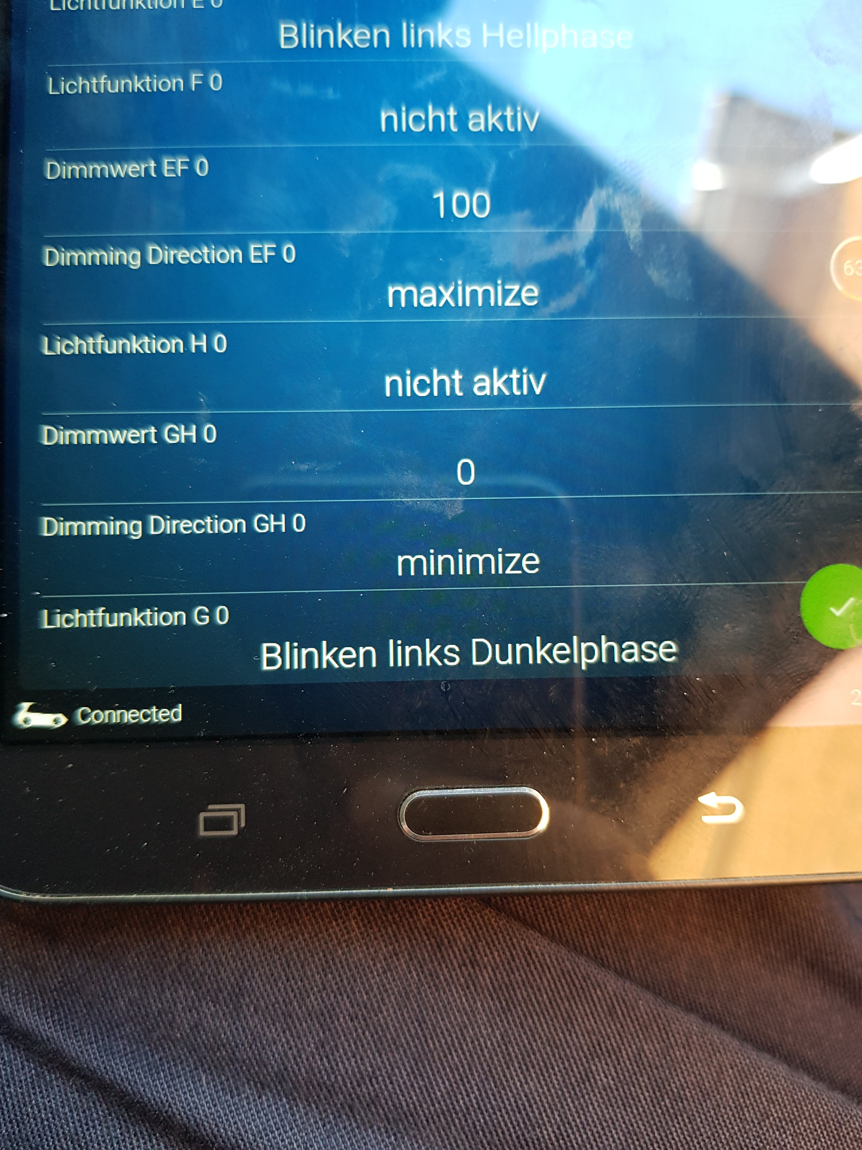

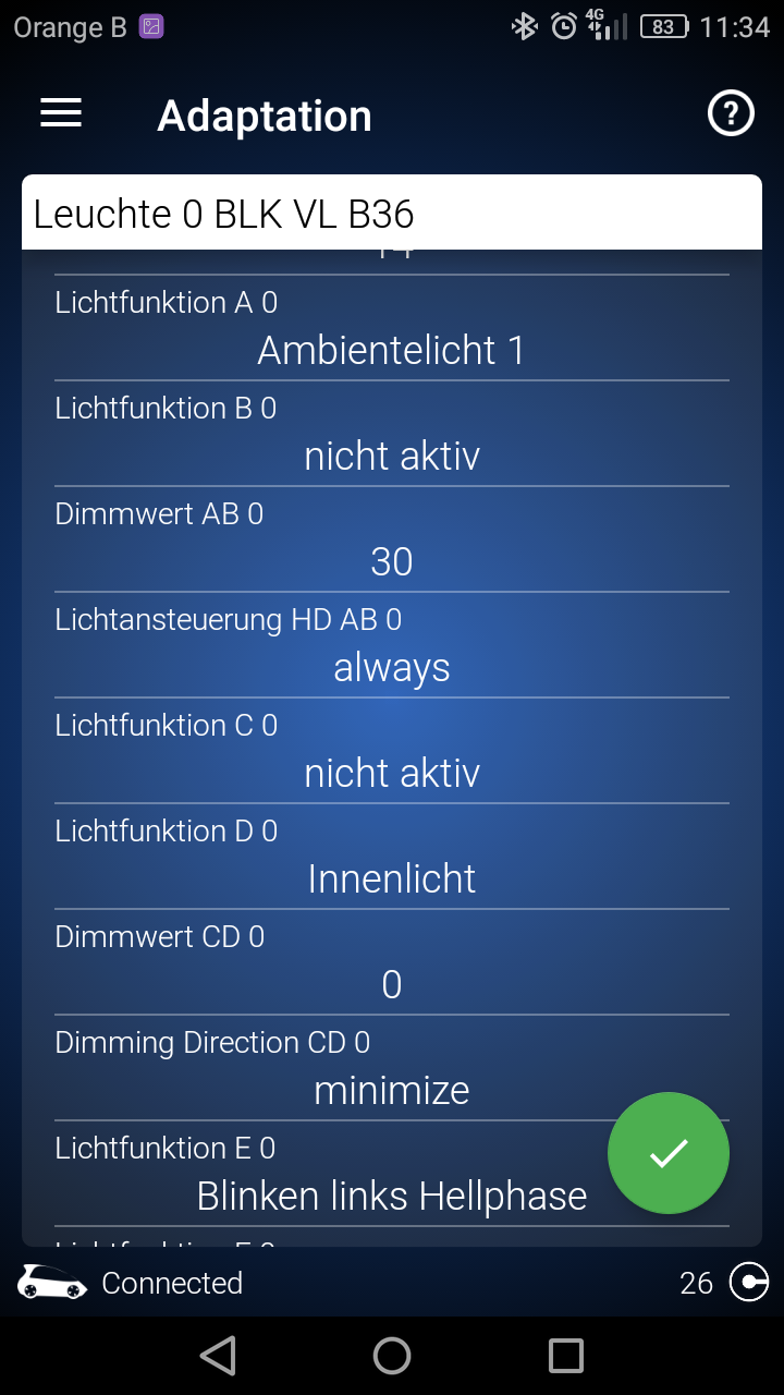

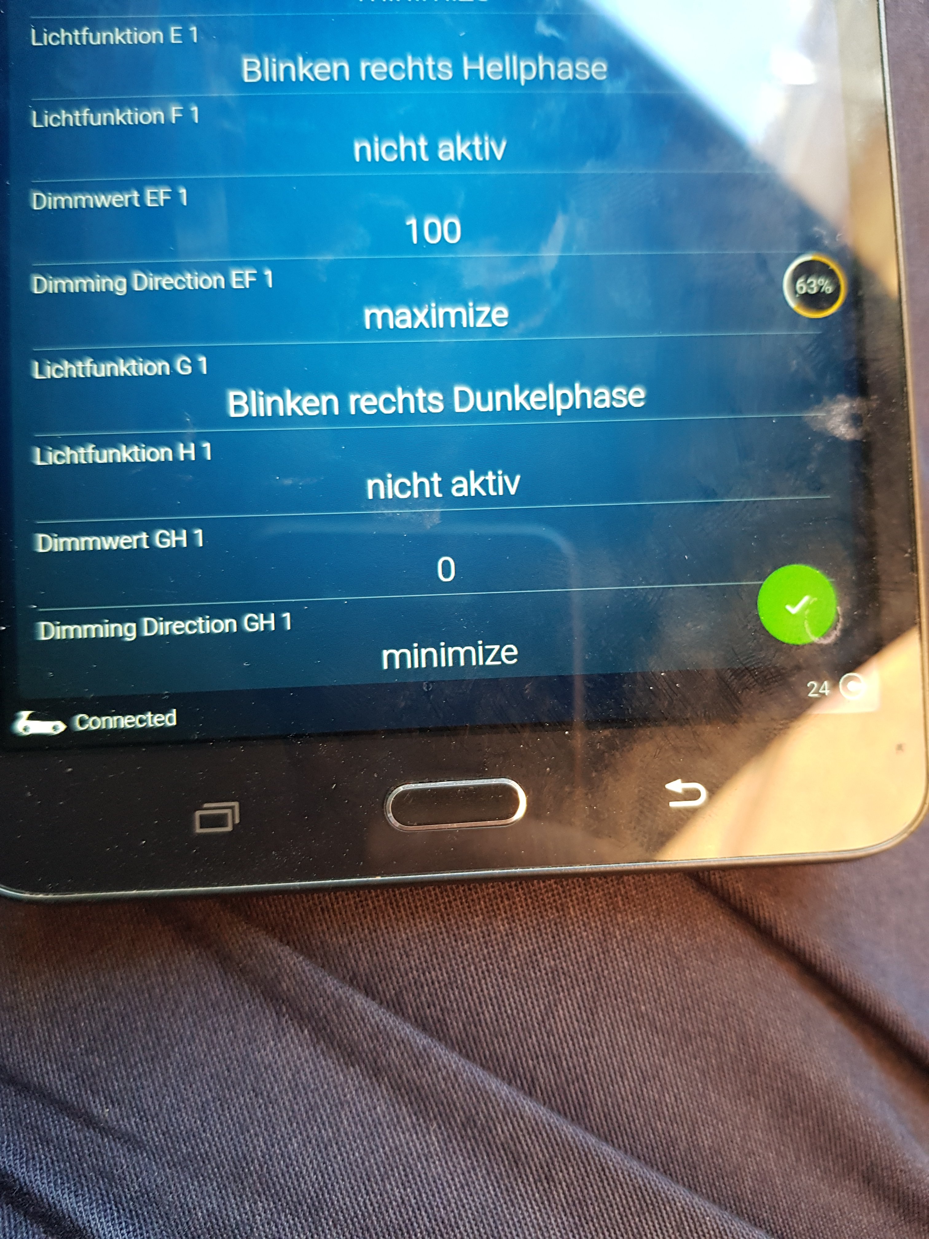

This is what i did, i hope this helps you,:)

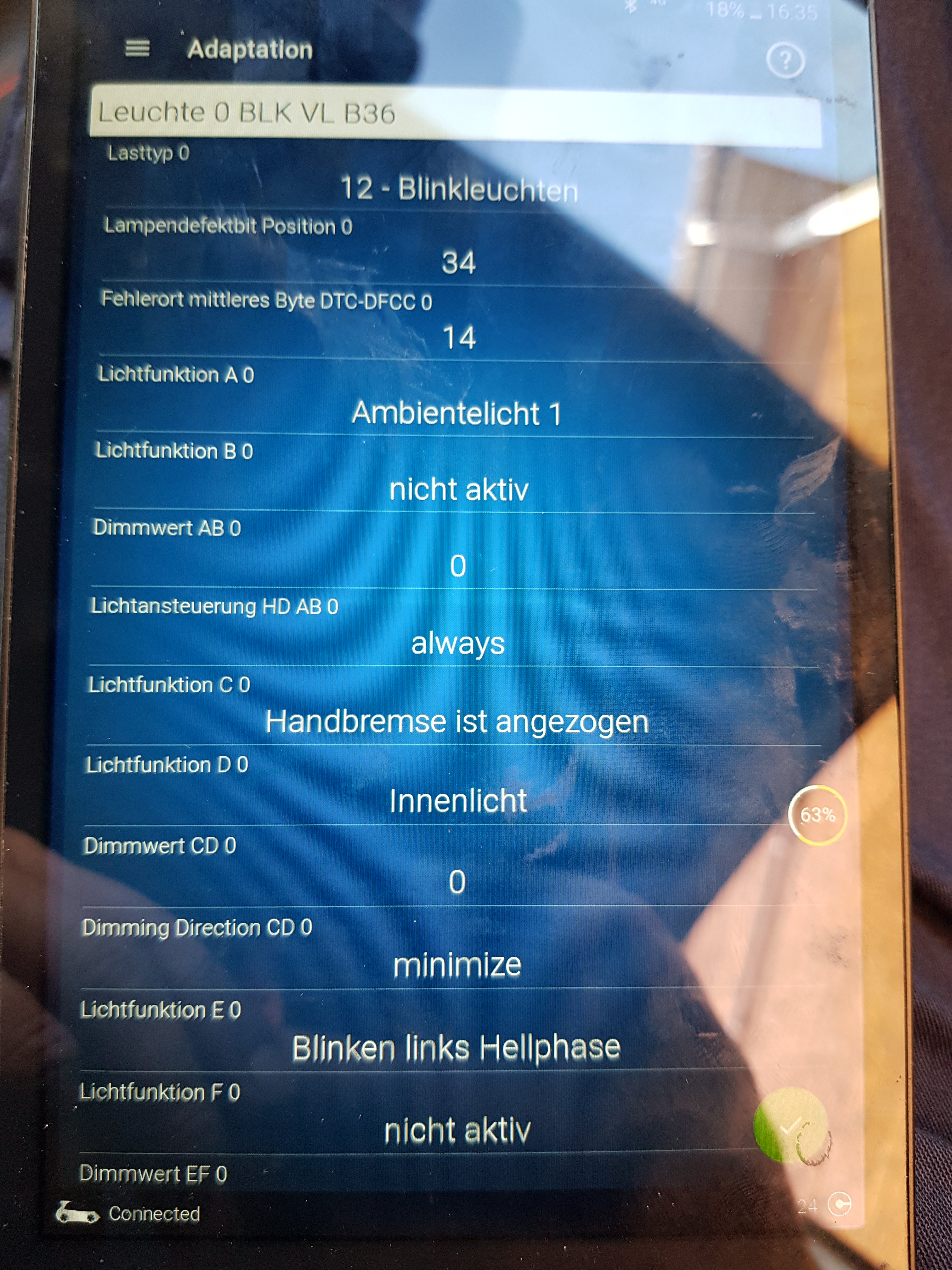

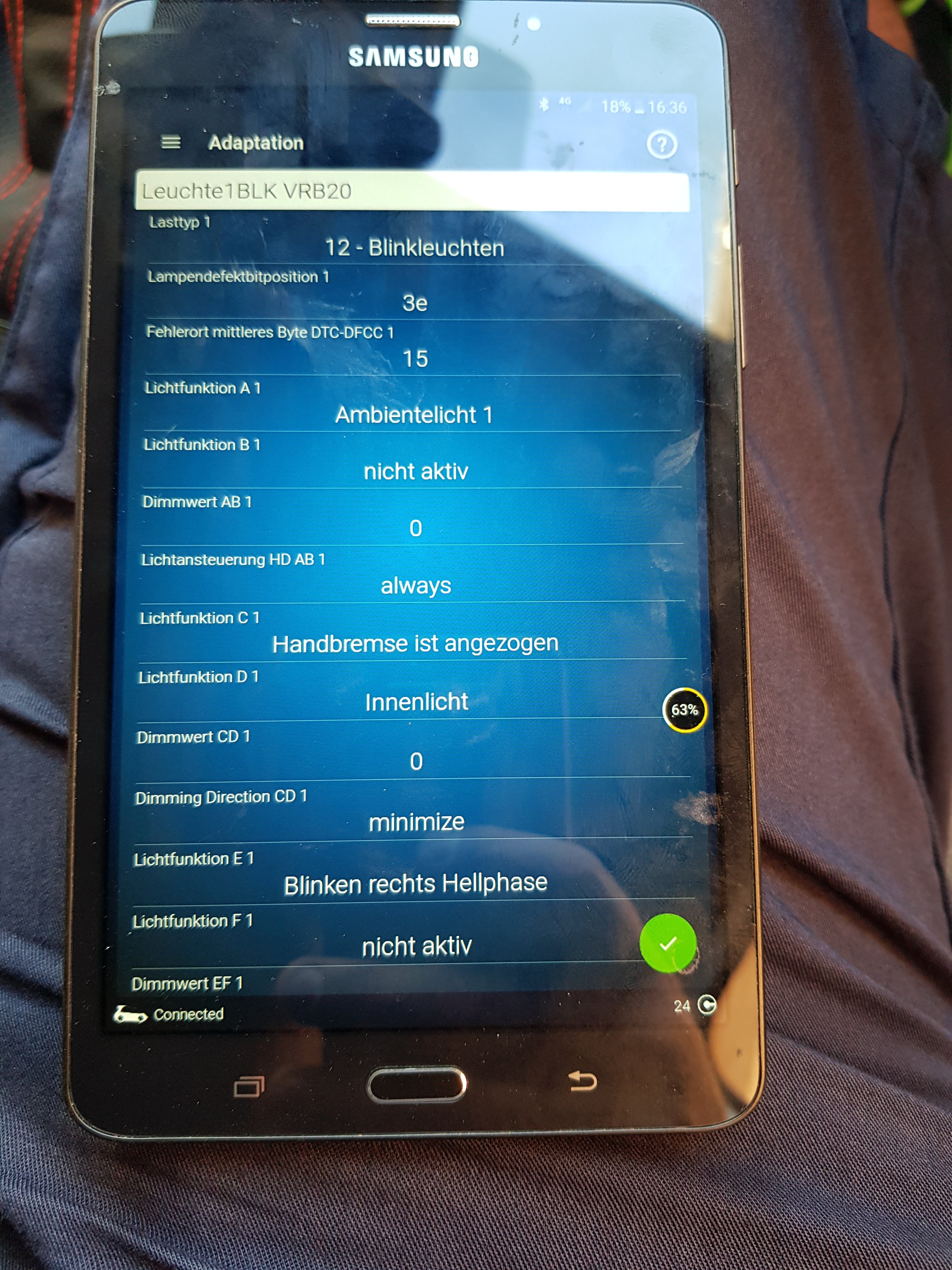

Your g1 and h1 are different to your g0 and h0
Yeah i know but know it works perfect the blinken and us light ,before one was always on when i locked the car, know i dont have any problems but i first try with the vagcom but the adjustment menu doesnt work than, my adaptions wasnt ori when i try it with obd eleven

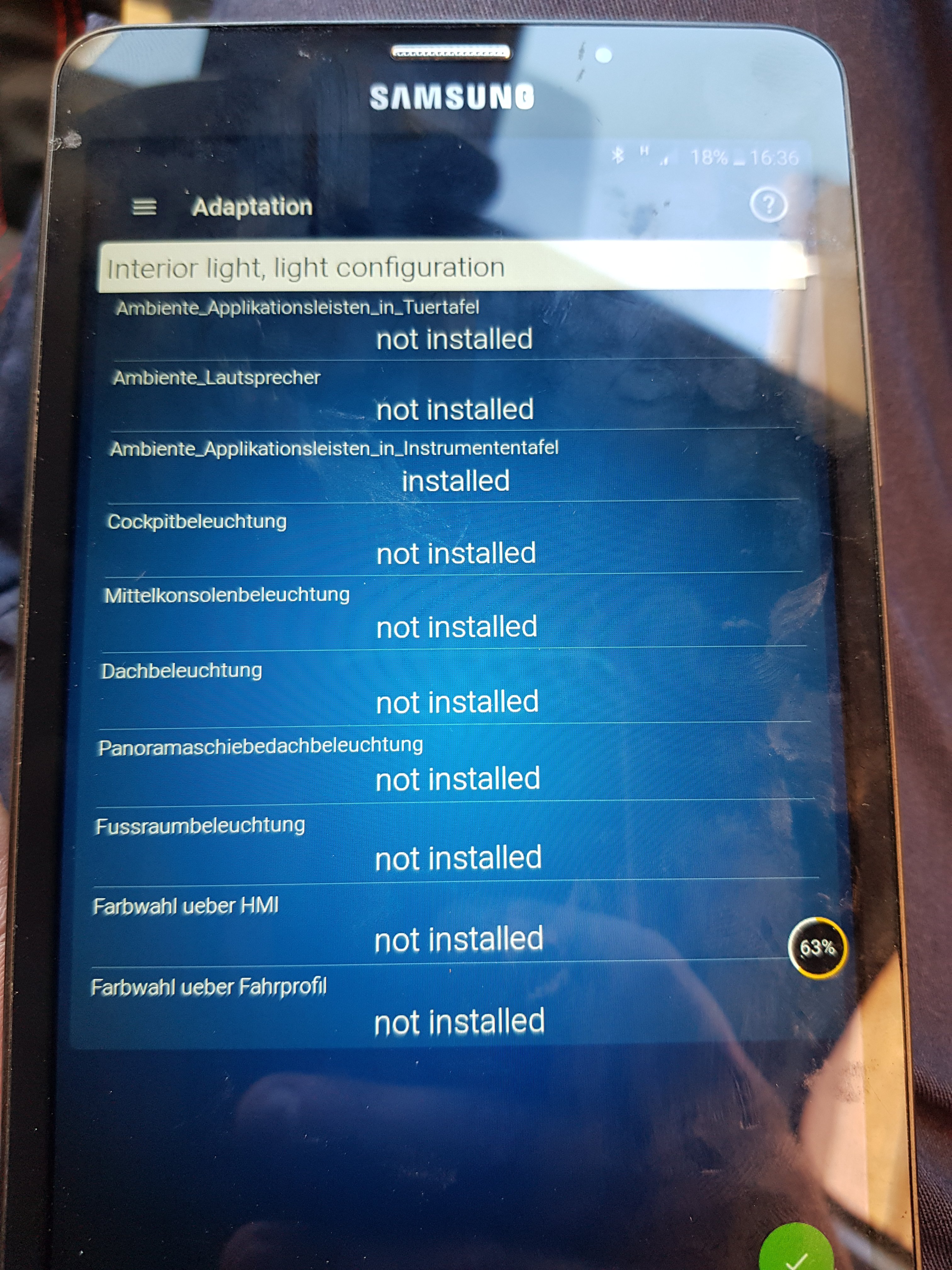

oh... i do not think you'll be able to see that so...
theese are only for the option to appear in infotainment
Byte 17 Bit 0 instead of "Indoor Light Luminaire Configuration". The rest is similar
field byte 17     now is 00001000, you change it to 00001001
Try it with Ambient Light 3 instead of Ambient Light 1
ab1. One was 0. One was 100.
