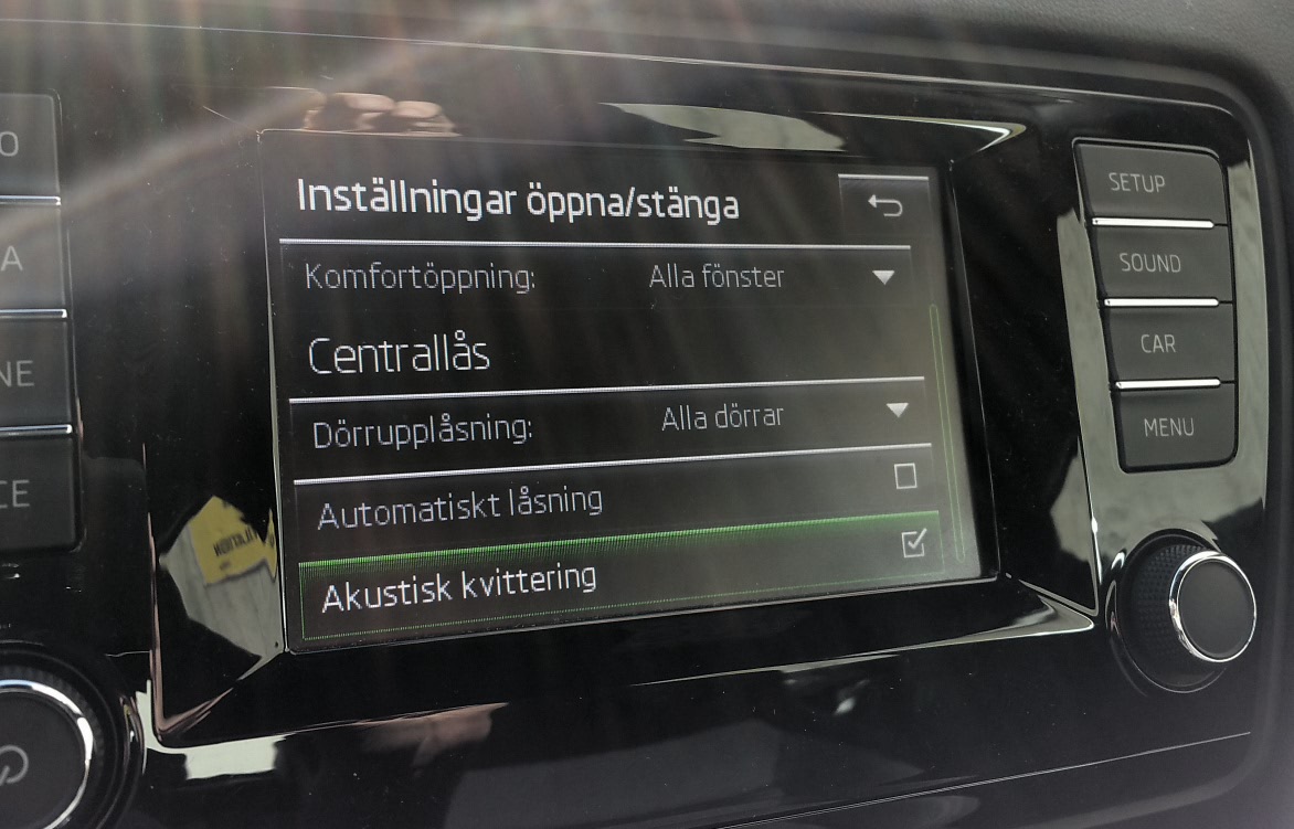

Regarding to the chirp it's actually possible to activate without an alarm, I did it yesterday and it works through the horn with the option on enable/disable in the infotainment (I have Bolero), thanks to Gizmo who pointed me in the right direction :)

Can you upload a photo of this on the infotainment unit. I have searched and can't find it. Would be interested to see where it is. Thanks.
Sorry for bad picture quality and that its in Swedish but once activated it will show up under car settings > open/unlock and bottom option "Acoustic confirmation", hope that helps!
