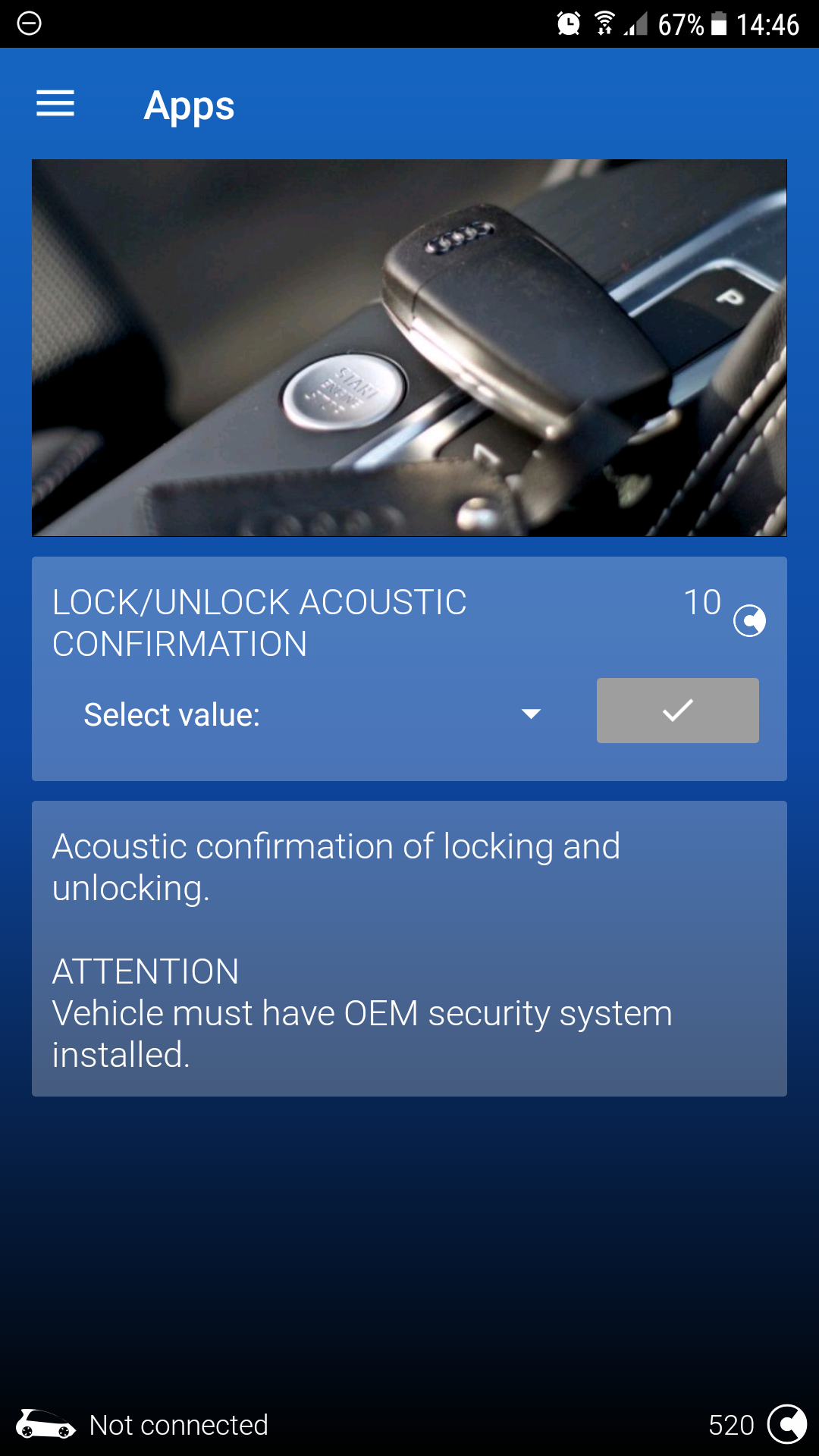

I've got a MY17 SE Sport and even when enabling the option via vcds and obdeleven, it wouldn't appear in the settings.

Ok so it doesnt appear in settings but does it work, do you get any sound when you lock/unlock?
Also, can you tell me what steps you did with OBD11 and where you found the guide?

Chirp is only there if you had OEM Alarm fitted. The alarm is not standard in all countries, it is an optional extra, but if you bought from forecourt the garage may have ordered it with the car. I ordered mine to spec and never ordered the alarm (an oversight) and no chirp available through any settings etc.
It may be possible to activate via VCDS, I haven't tried so I can't be certain.
Retro fitting the OEM alarm is possible by a good alarm guy. He can wire into existing system using canbus communication and your original key will operate everything, no need for extra alarm fob like usual when aftermarket alarm done. He needs to fit siren and sensors and then configure settings using VCDS I guess.

Yes it can be activated on a MY17 car, FWIW there is no need to turn the chirps on with VCDS once the below has been activated as you can now turn them on and off yourself in the infotainment set up:
https://www.briskoda.net/forums/topic/380829-superb-mkiii-vcds-adaptations-tried-and-tested/?do=findComment&comment=4742527 - yes I know it’s in the superb section because I have done it on a few Superb’s, but the process is the same for the O3:
Activating alarm chirps locking/unlocking
I noticed on a MY17 L&K that there is no option to turn the alarm chirps (Acoustic confirmation) in the infotainment.
Controller 09 - Central Electronics
16 - Security Access - enter 31347
10 - Adaptations
Go to:
IDE02269-ENG122188-Acknowledgement signals-Menuesteuerung akustische Rueckmeldung
Change to active
You will now have the Acoustic Confirmation option in the infotainment screen.
