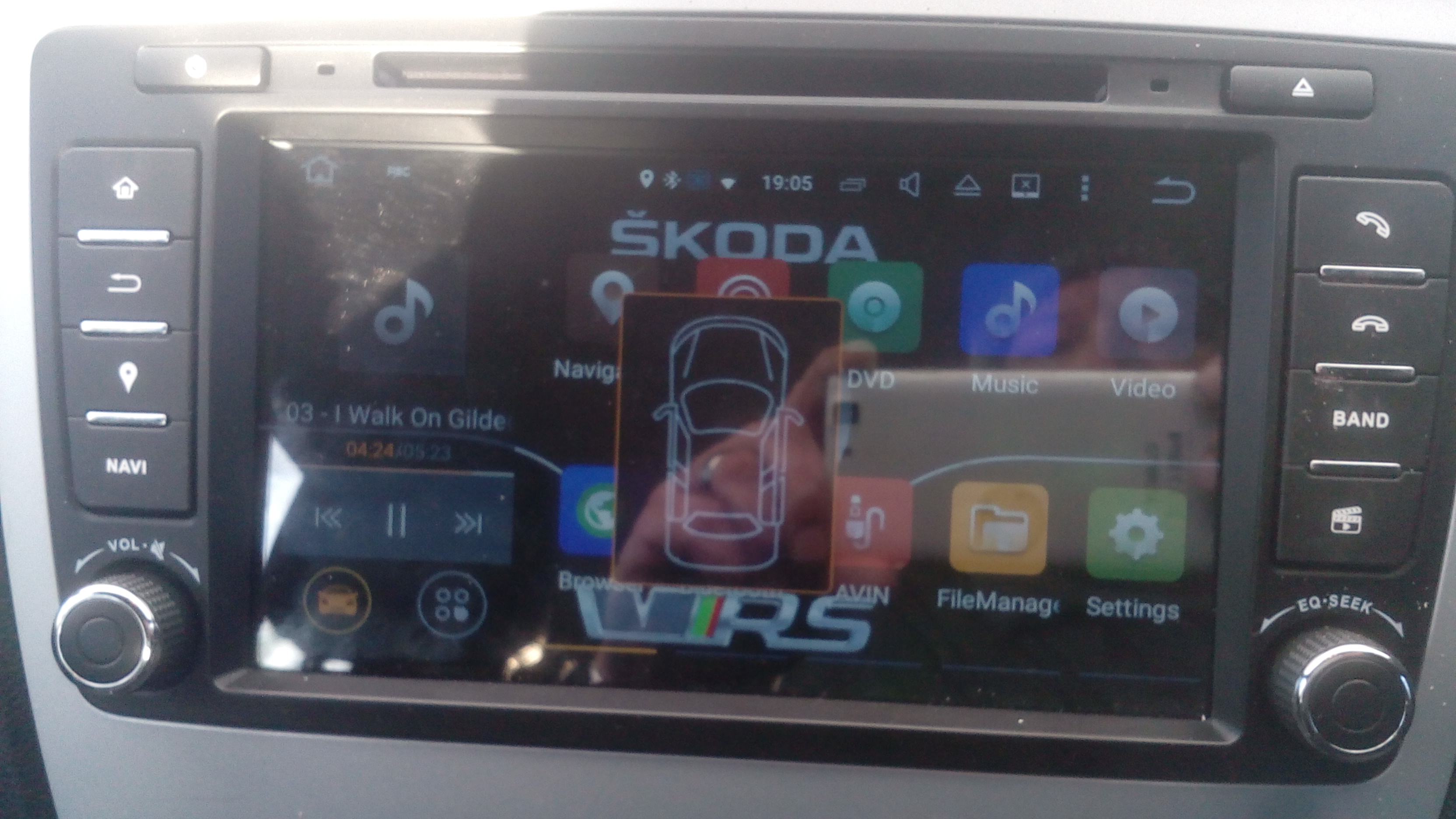

hi levy9 i have been looking at your xtrons model how do you find it any chance u could post a pic of the screen with the climate control on there the spec of it  looks impressive kevin
Yeah overall I’m really enjoying it but it is more of a toy than anything else.  On the practical side of things the hands free and satnav functions (Sygic from the Play store) are really useful and work well, also now I’m hooked up a reverse camera it adds some more useful functionality.
It’s great with playing MP3s and CD’s plenty of storage with the 2 SD card slots, I’ve connected up a DAB unit through one of the USBs and that works fine but signal can be a little patchy in my area.  I’ve used the second USB as a phone charger which I’ve sent through to the top storage compartment above the air vents.  Connecting my phones Bluetooth and syncing the contacts list was simple and making a Wi-Fi hotspot using my phones data.   It plays MP4 videos and DVDs perfectly fine also.
The user interface is very good responsive and intuitive, if you use to Android then that will help with the settings menu but even if not it’s all easy once you know your way round it.  It takes about 20+ seconds to boot up from cold and you can customise the boot up logo, you probably will have to swap the door open graphics in factory settings as that seems to be the wrong way round for everyone.
The canbus picks up everything out of the box for me, MFSW worked as its meant to and the climate control graphics overlay on screen when you use them, the canbus also works the reverse camera with connections into the back of the head unit, so no need to splice into the reverse light wires or anything else.

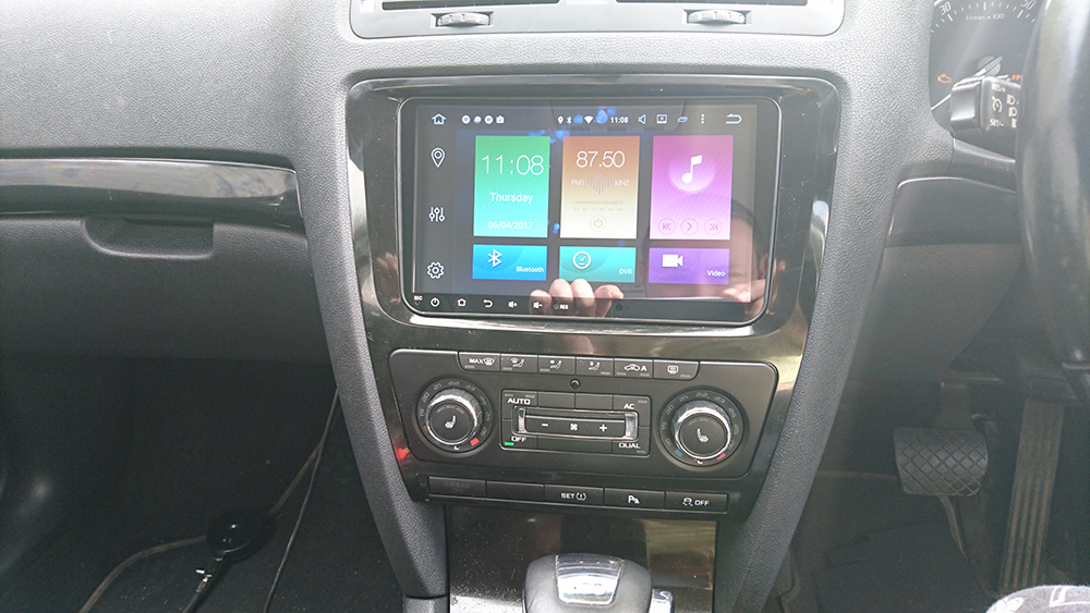

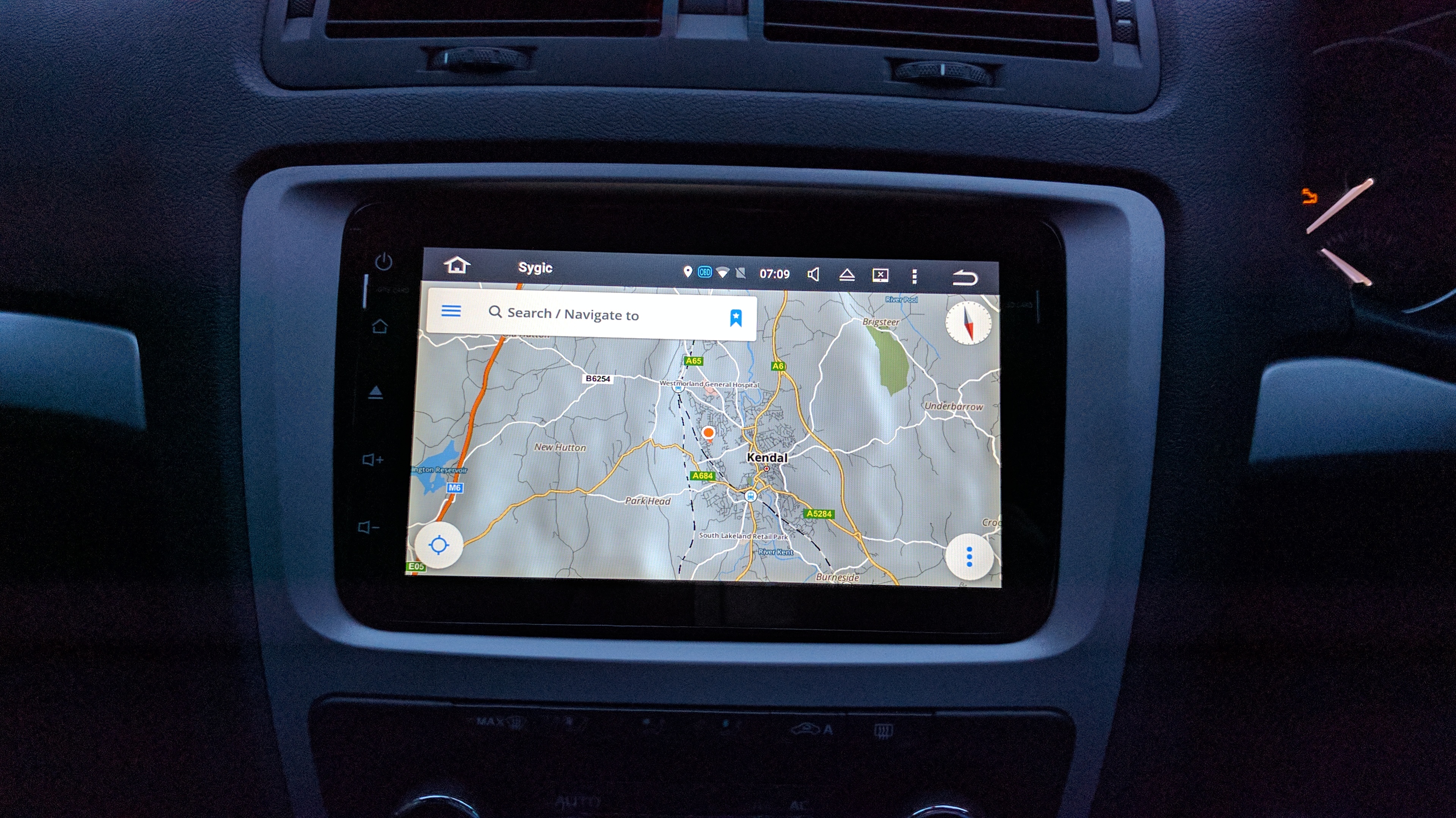

Some pictures of the finished job.
Wiring depends on the model you get, with mine there is no adaptor for the quadlock and the canbus is built in so the factory quadlock plugs straight in the back of the unit, hardly any more wires than OE if you are just using the aerial and wifi and gps are the only extra bits, the USBs dont really take up much room, it gets messy when you add the extra wires if you need audio/video in/out, TV or DAB etc etc.
I was going to remove the vents though as it would be a better place to run a USB cable into the cubby for a USB stick or phone charging which I will probably do.

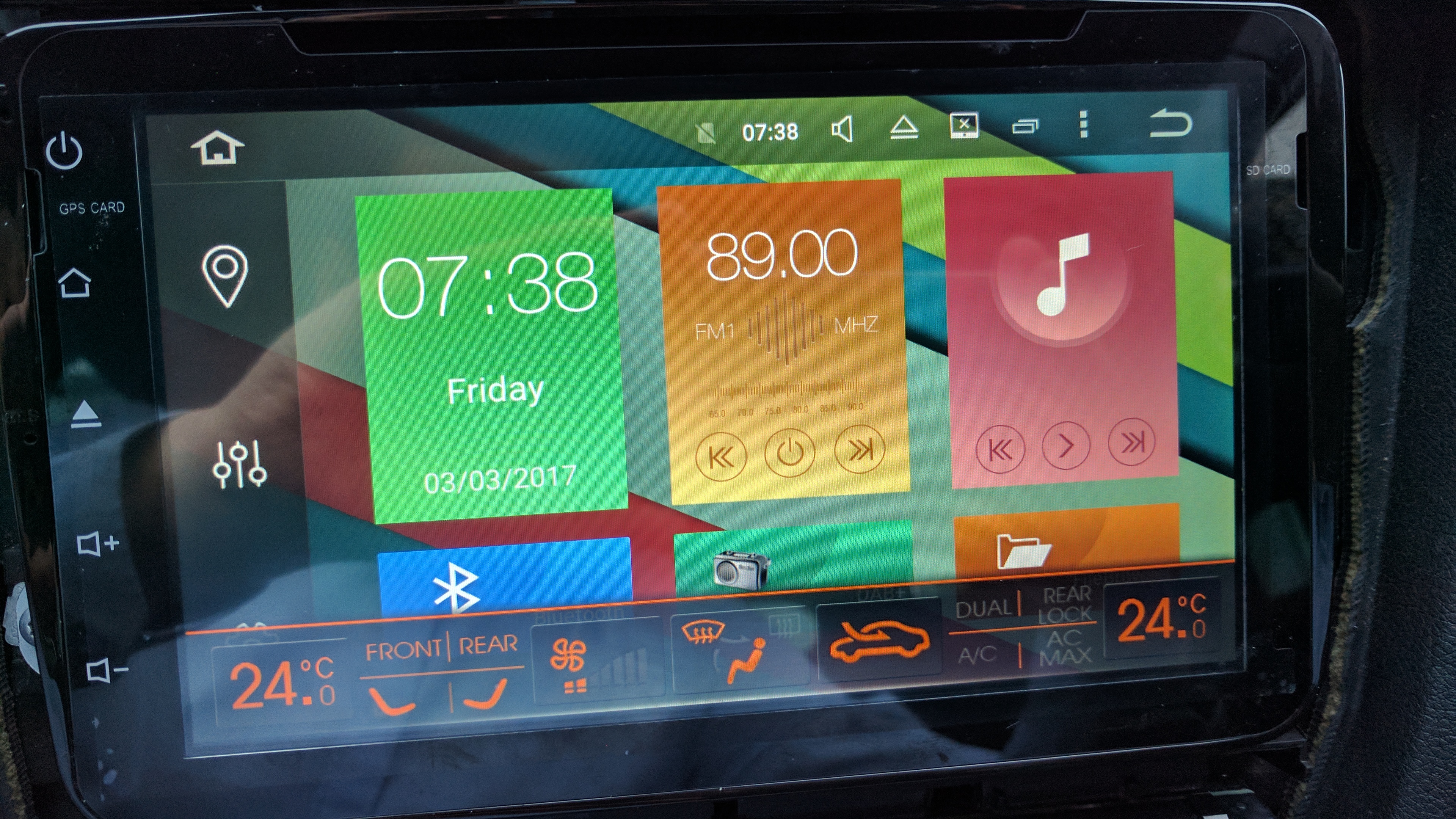

Here are a few pics, sorry the quality isn't great as I couldn't get out of the glare of the sun but it gives you an idea of the AC, Doors, Vehicle, Sat Nav and Torque app.
The camera isn't bad quality for £12 ;-) not so good in the dark but it will still show an accident.
There are 2 more but I reached the 10mb limit
