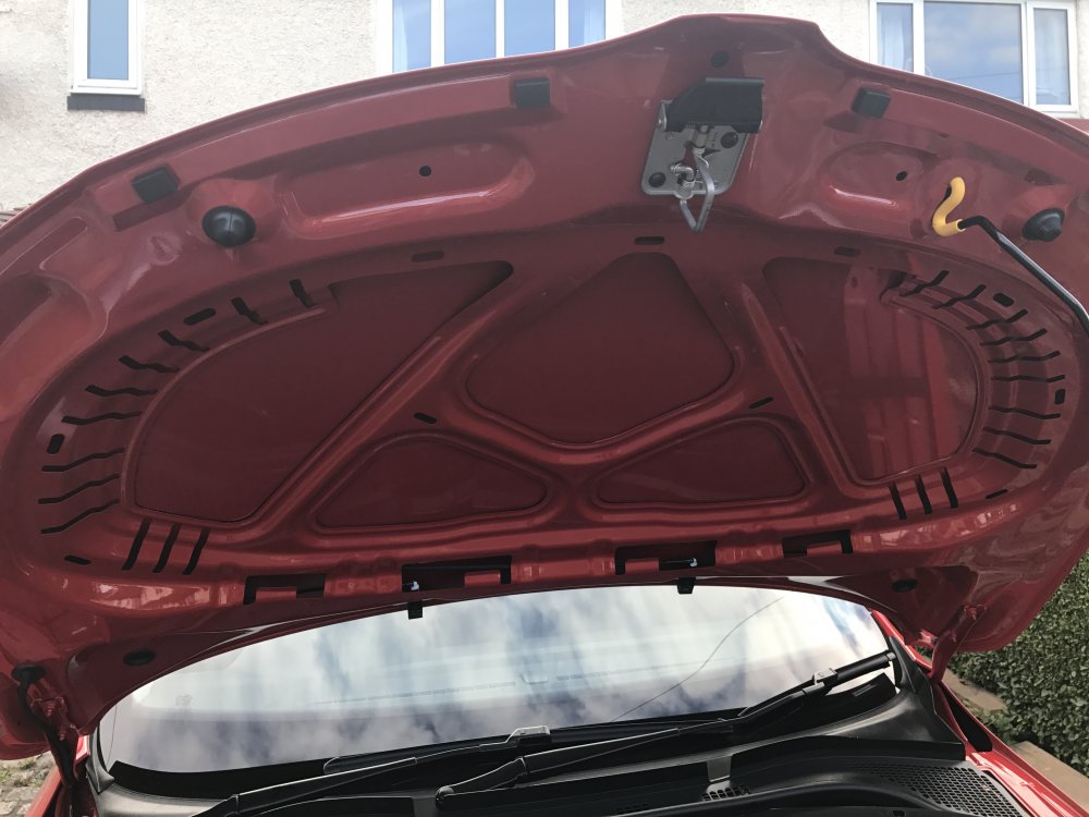

Our MY2017 Rapid Spaceback SE Tech 1.2 tsi 110ps has no under-bonnet sound insulation.  It's probably not necessary because I think this engine is quite smooth and reasonably quiet.  Even so, I was wondering about fitting the insulating pad for further improvement.  It's available from Superskoda at http://www.superskoda.com/Skoda/RAPID/Rapid-original-Skoda-Autoas-hood-silenting-panel
Does anyone have any experience of fitting this under-bonnet sound insulation with the 1.2tsi?  Is there any reason not to fit it (e.g. engine cooling)?

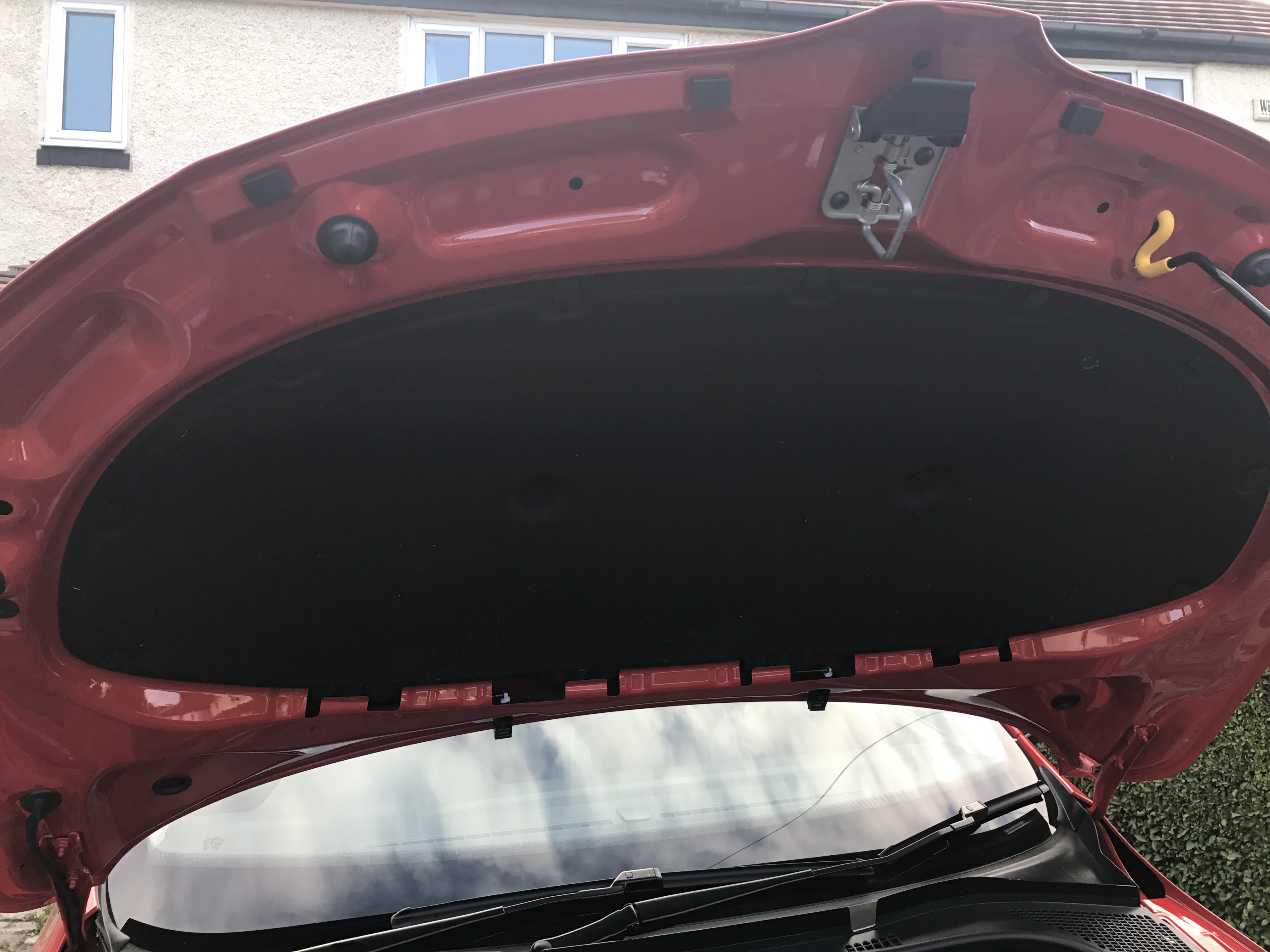

However, our 62-plate Fabia Combi 1.2 HTP was not. I had to buy it as an accessory part and fit it myself (was only £25 from the parts counter including the clips). However, doing so made a hell of a different in terms of deadening the engine sound at idle and made an improvement to warm-up times.

NOW fitted & really think it should be a "standard" factory fit...no doubt to do with cost cutting !

I agree! I finally got round to ordering and fitting the under-bonnet insulation pad, and I think it makes a noticeable difference in subduing engine sounds on our 1.2 tsi (110ps), particularly at low revs. I could even convince myself that front tyre rumble is more muffled. At £23.24 from my local dealer, I would say that this part gives a worthwhile improvement to overall refinement. I think it took nearly 30 seconds to fit it!

I took the under bonnet insulation pad from my 14 plate rapid hatch and installed in my new 17 plate Spaceback. Fits perfectly, easy fix. The 1.2 engine is very quite, but it all helps. If nothing else it just looks better!
