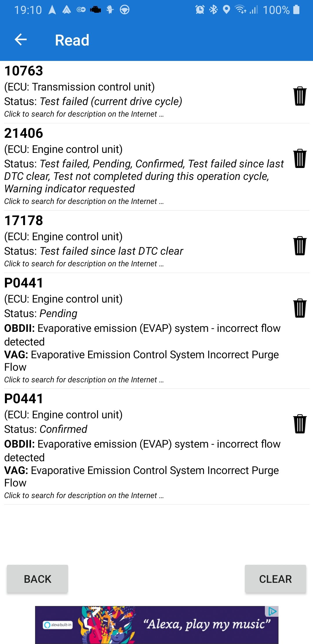

I've been checking my car over the last few weeks and since the evap canister was changed, it has not happened again since.
I specified the parts changed in an earlier post.
I did get an engine management light up on the drive home after the canister was replaced which I checked using a Carista OBD II dongle and it mentioned the following.
Basic OBD2: P0441 (pending) (confirmed) - Evaporative Emission System Incorrect Purge Flow
Central electronics: 197904 Ignition authorization: 65794 - Data bus for suspension - 1 wire mode
Heater & air conditioning: 263425
Driver's seat: 13893632 Engine: 21406
They cleared all the errors and the engine management light is now off.

Latest update.
Engine management light kept coming back, even after being reset a few times.
Diagnosed as a EVAP canister purge valve needing to be replaced.
Another £190 later and no more lights for now. I will just keep an eye on this and hope for the best.
