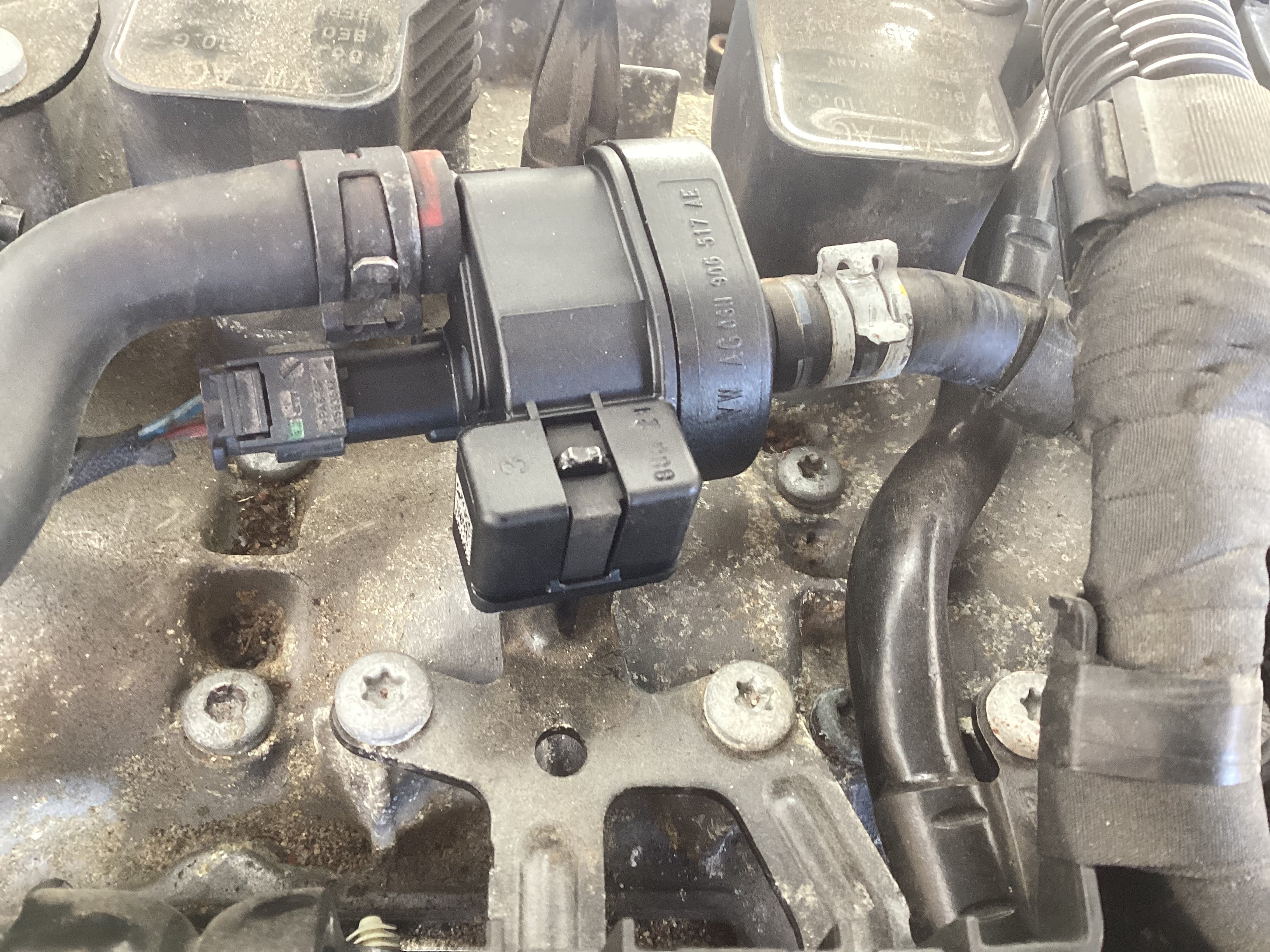

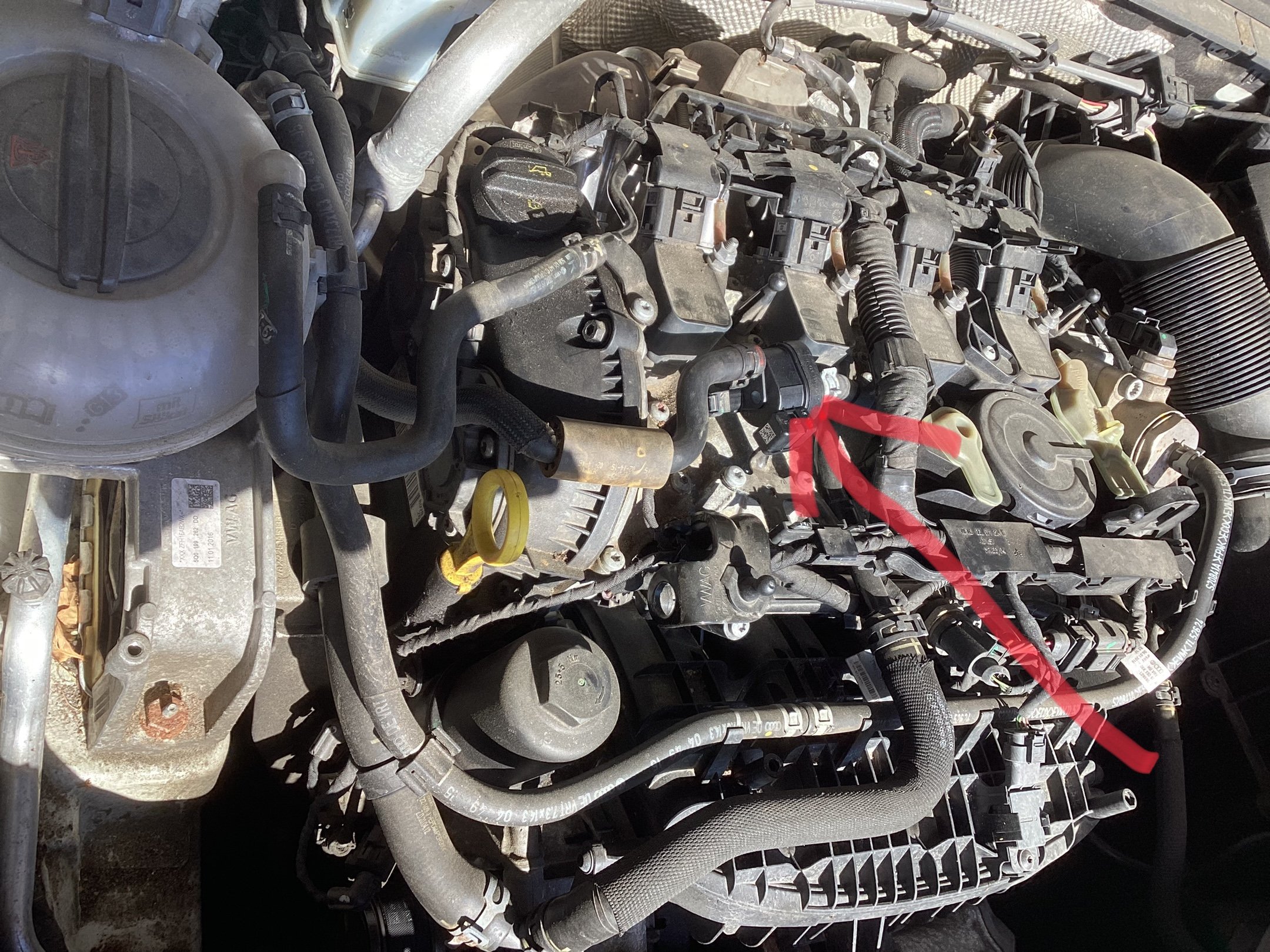

Oh well hey ho, just like @Ronskin, day 2 and check engine light on, evap control. So I located the N80 valve which is conveniently on top of the engine just under the plastic cover. I took it off and can blow through it, which I think is wrong, I think it should be closed when unpowered. So I’ll order a new one on Monday. You can get pattern ones on eBay/Amazon but it doesn’t look expensive so I might as well get the pukka part.

Popped down to TPS as the part has arrived. In the TPS car park I opened the bonnet, removed the plastic engine cover, used pliers to remove the 2 hose clips on the valve, popped off the electrical connector and pulled the offending N80 valve off its mount. I can blow through the valve, which I shouldn’t be able to do. New valve out of the box - no I can’t blow through it. Pushed onto engine, 2 hoses attached, connector pushed in, plastic lid on, bonnet closed. Into the car plugged in VCDS to car and laptop, cleared fault code. Total time elapsed less than 5 minutes.
Maybe I am counting my chickens but the N80 valve was clearly faulty. I suggest that anyone else with these issues can carry out this simple test at home, remove the N80 valve and see if you can blow through it (gently!) when it’s disconnected. You shouldn’t be able to. Quite possibly I didn’t need to replace the evap canister, just this valve.

Oh and the old part number was 06H.906.517 T. New part number was the same but with AE at the end instead of the T. Cost £38.47 including VAT

Check the N80 valve on top of the engine. It will just take 5 minutes!
