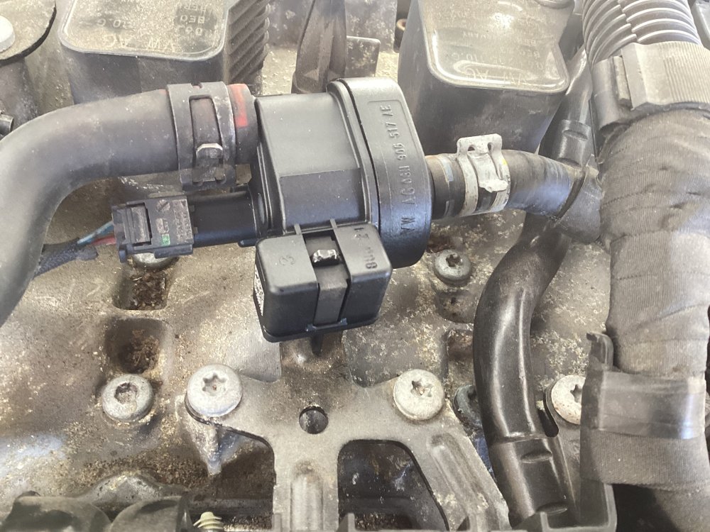

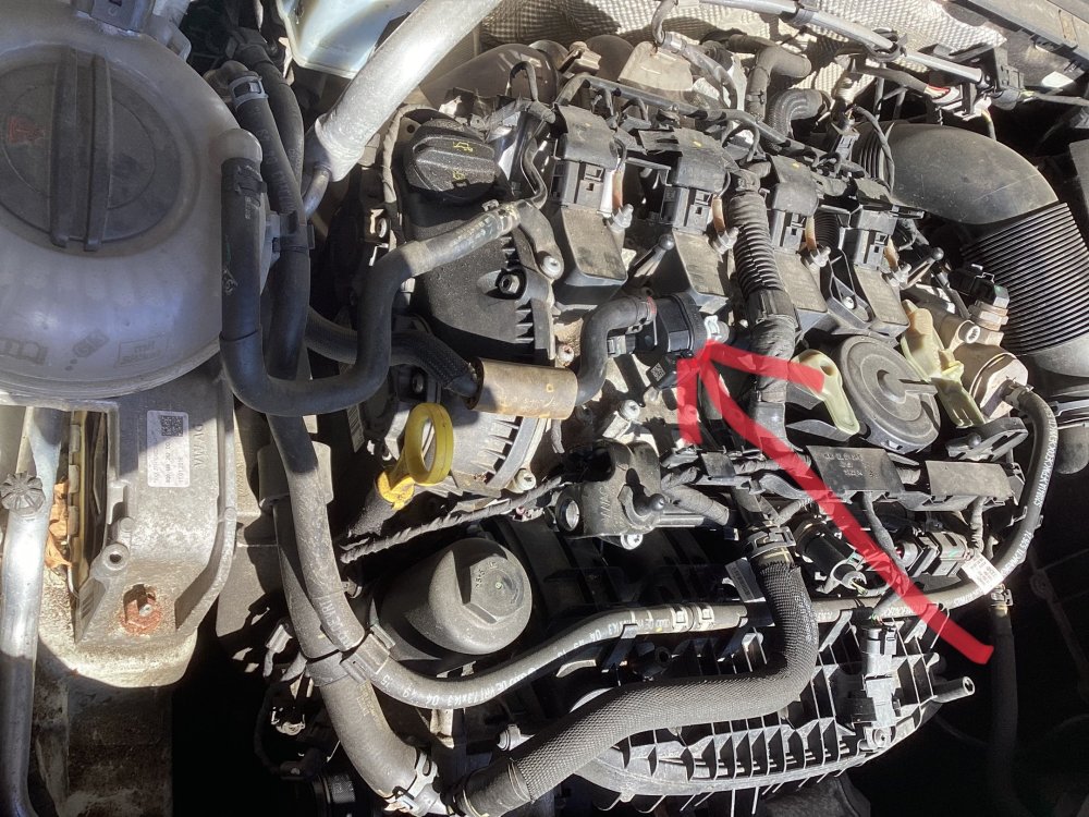

    Yes, this is the purge valve.  I can only assume that the valve was sticking, such that the canister wasn't being purged.  The result, I imagine, was the canister becoming saturated in fuel, when then

Since having the carbon canister and the evap valve replaced (with a new battery) I've seen had no other issues and the car has never ran sweeter since I purchased it in February.

One replacement Carbon Canister (fixed fuel issue) and an Evap Valve (got rid of engine management light) and it's all good.

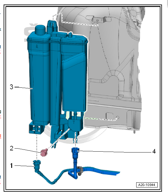

The problem is caused by overfuelling, trying to squeeze the extra in after the pump clicks, something I do all the time but mine is diesel and doesn't seem to be affected.
The evaporative canister is intended to recieve fuel vapour, liquid fuel will block it.
Filling right to the top of the neck the fuel will just flow down to the canister, even just beneath that it will happen with heat expansion.
Once the canister is full of fuel the tank cannot vent other than through the canister pressure relief valve which is full of fuel.
The hot weather has made the problem worse and also shown up canisters that have already become clogged, I do not know why mine and other diesels have escaped the problem but it will be to do with the vaporising point of the fuel,  amongst the fuel cans in my garage its the petrol ones that swell up and sometimes leak in the heat, never the diesel.

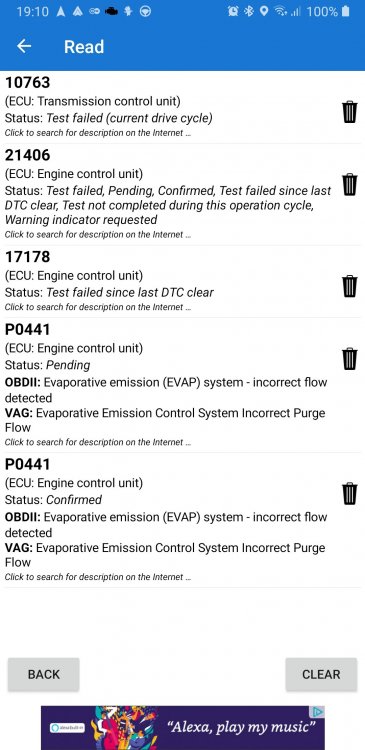

I've started having this problem, seems to happen when I have the car at the gliding club and do a few very short journeys around the airfield or to the caravan, in hot weather. According to other sources and ERWIN, it is the charcoal evaporative canister (under wheel arch  near filler). There is a modified part available. So it looks like an evap canister change for me. I have just been on the phone to TPS for the part, at £45 including VAT that is not too bad. It is arriving tomorrow and doesn't look difficult to replace - FLW... Hopefully it will not need the G10 valve changing as well, but since I have no fault codes hopefully not.
