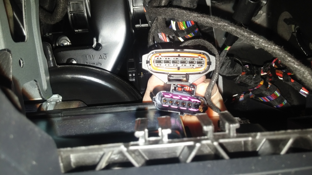

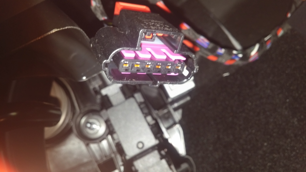

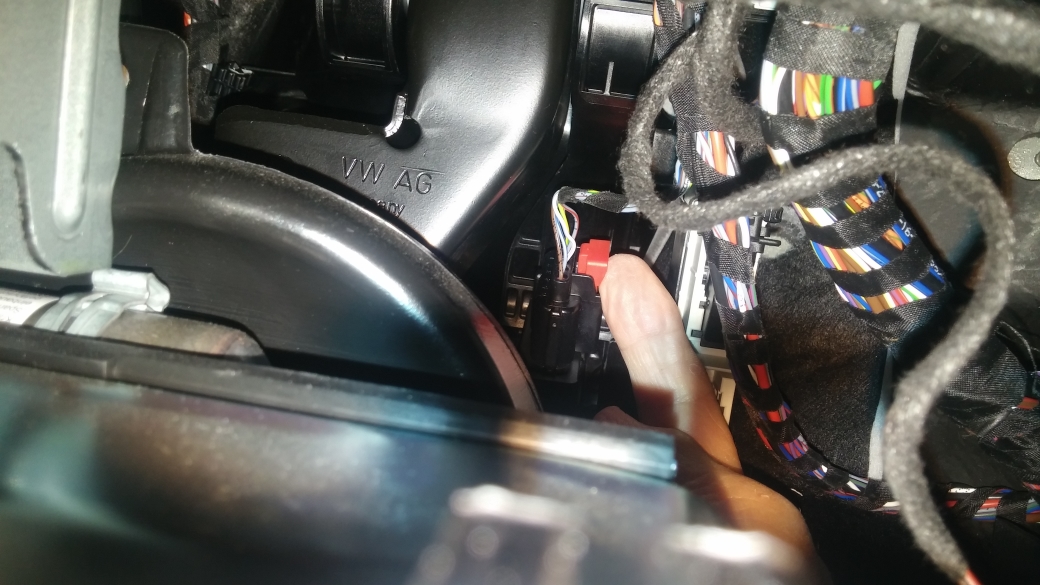

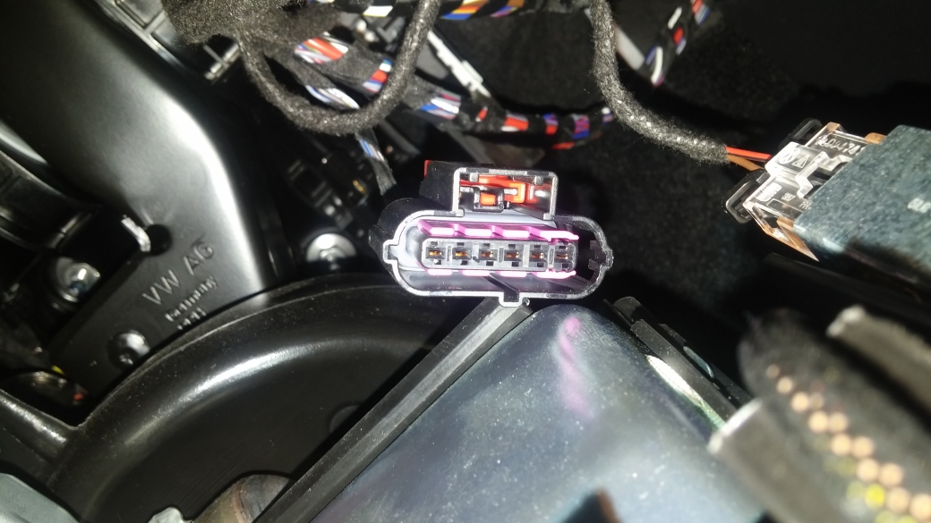

Well the response control arrived today but it doesn't fit!  First of all thanks l4wrence for the tip about the storage drawer. Taking that out made it a lot easier to see the connector.
Anyway the connector is totally different to mine as you can see in the photos. I have sent them these photos and am waiting for them to get back to me.
@facet edge  In the last picture the pink connector is correct so if the (yellow, upper) connector is on the Throttle Response cable then it is indeed wrong, but if it's the connector you pulled from the car then you've pulled the wrong one.
Edited by BillyJim
Yeah the pink one is mine and I put their connector beside it to show how different they are.
I take it that you have got the pink one as well. Makes you wonder what they have given me. :blink:
Yup. Throttle Response and OEM are exactly the same, even the same girly colour. :kiss:
