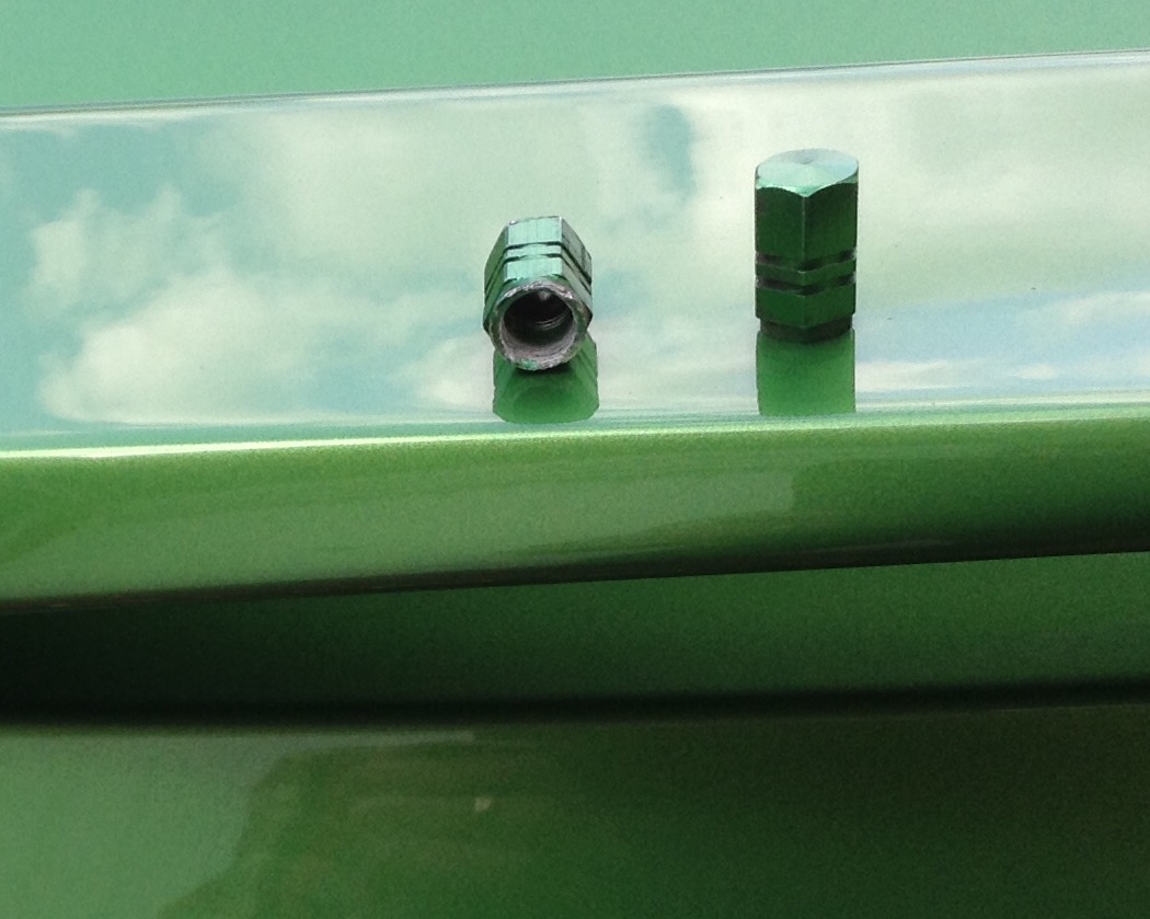

if you are going to fit metal dust caps, do use copper grease and check them regularly. Having been told by ex-Police motorcyclist that they are an important piece of safety kit, I fitted them to my car, also because they neatly matched the paint colour. Despite noticing them getting tight and greasing them, the two rear caps oxidised and welded themselves to their valves stems, necessitating a trip to the local tyre bay today to have them pulled out and replaced. Not expensive, just annoying. On the plus side there's still 4-5mm on the rear Potenzas and the discs are unmarked at nearly 21000 miles. Definitely replacing them with Goodyear Eagle F1 whuch have been a revelation, being much quieter and giving better grip.
Already found that one out the hard way. Managed to remove them with careful use of a hacksaw and a pair of wire cutters.

Are they alloy or steel caps? Alloy will react with the valve stem and corrode. Steel, good quality ones, won't!
I have had this problem on my insignia the valve caps corroded and stuck to the stem, as i twisted it off it broke the valve stem and as they were the tpms type valves it cost me £45 to replace it, quite an expensive lesson.
personally ill never use them again!
Alloy, you can see the white corrosion in the original post. Lesson learnt.
Ouch! I tried several times but knew that I was about to break the seal and leave my car pancaked on the drive or even worse, scratch the wheel lacquer. My local firm were great, they simply stood on the rims and pulled upwards with a set of molgrips and the valves popped out without a scratch. £5 was requested, I gave him an extra £5 for a pint, well worth it.
