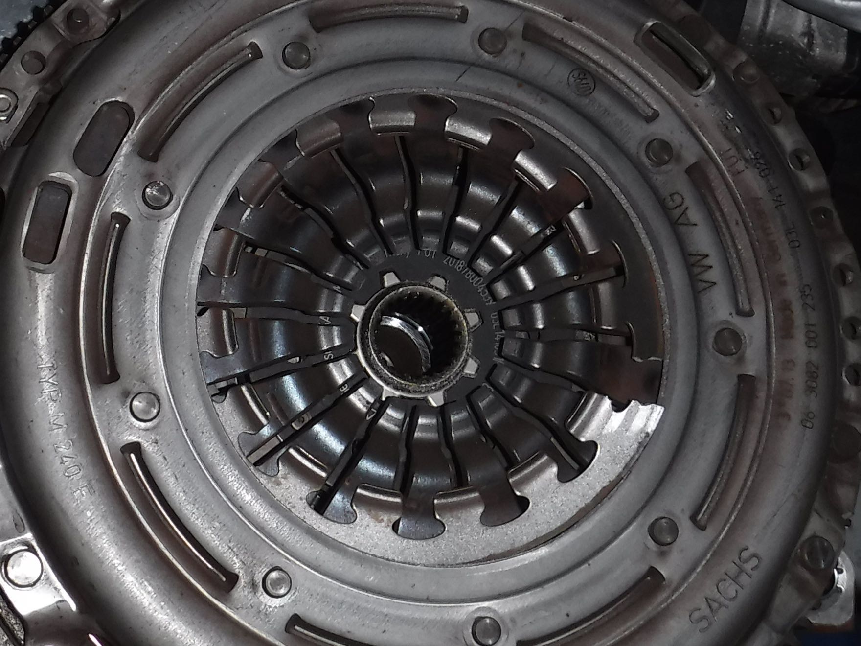

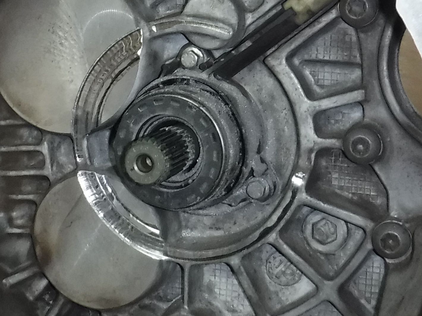

Sorry to say sounds like mine when clutch pressure plate failed - as mentioned above this can also do serious damage to the front of the gearbox casing. When mine went the noise was only really noticed outside the car. Really thankful had taken extended warranty. Skoda did make a contribution too as it seems to be a known issue
