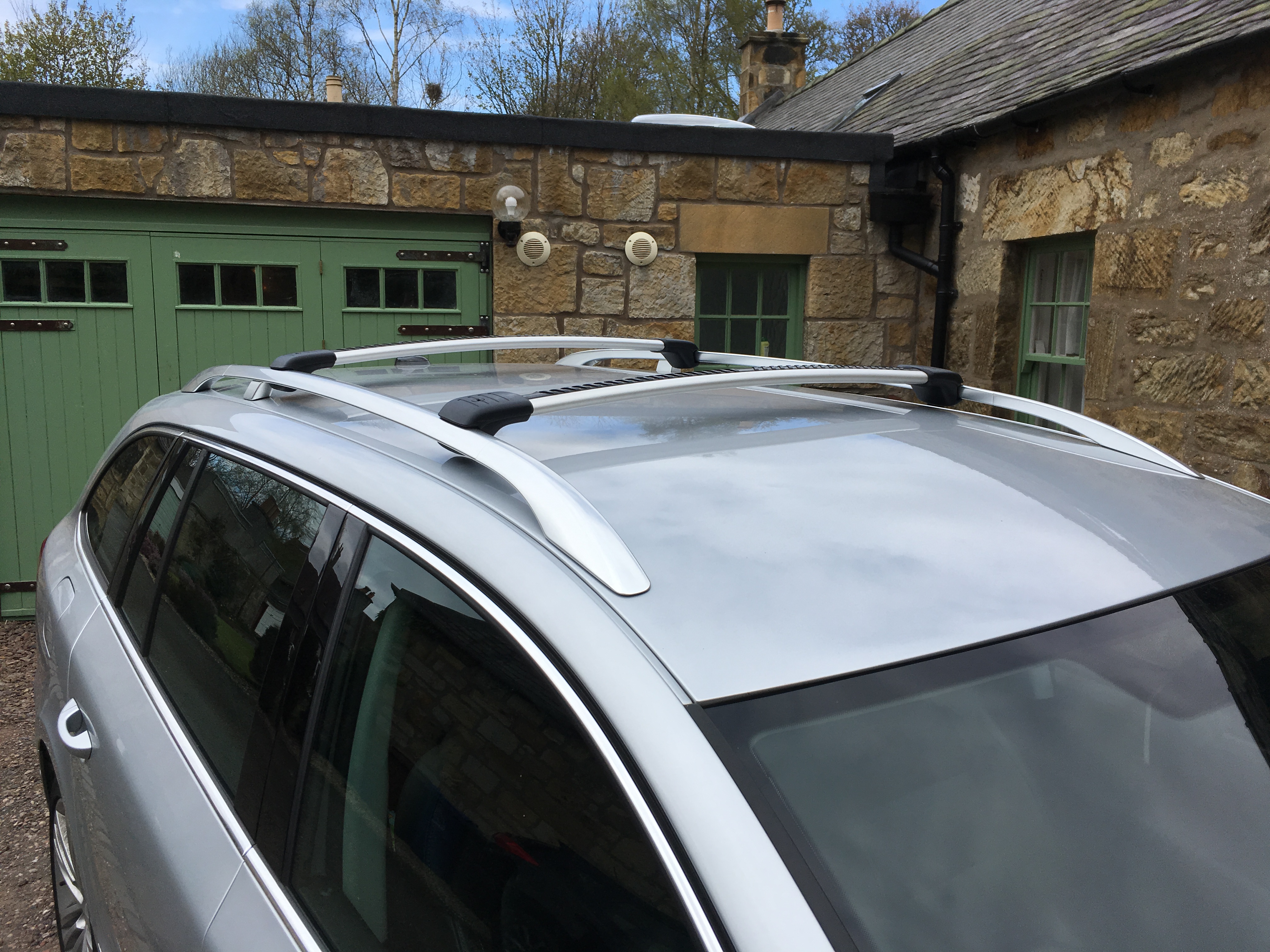

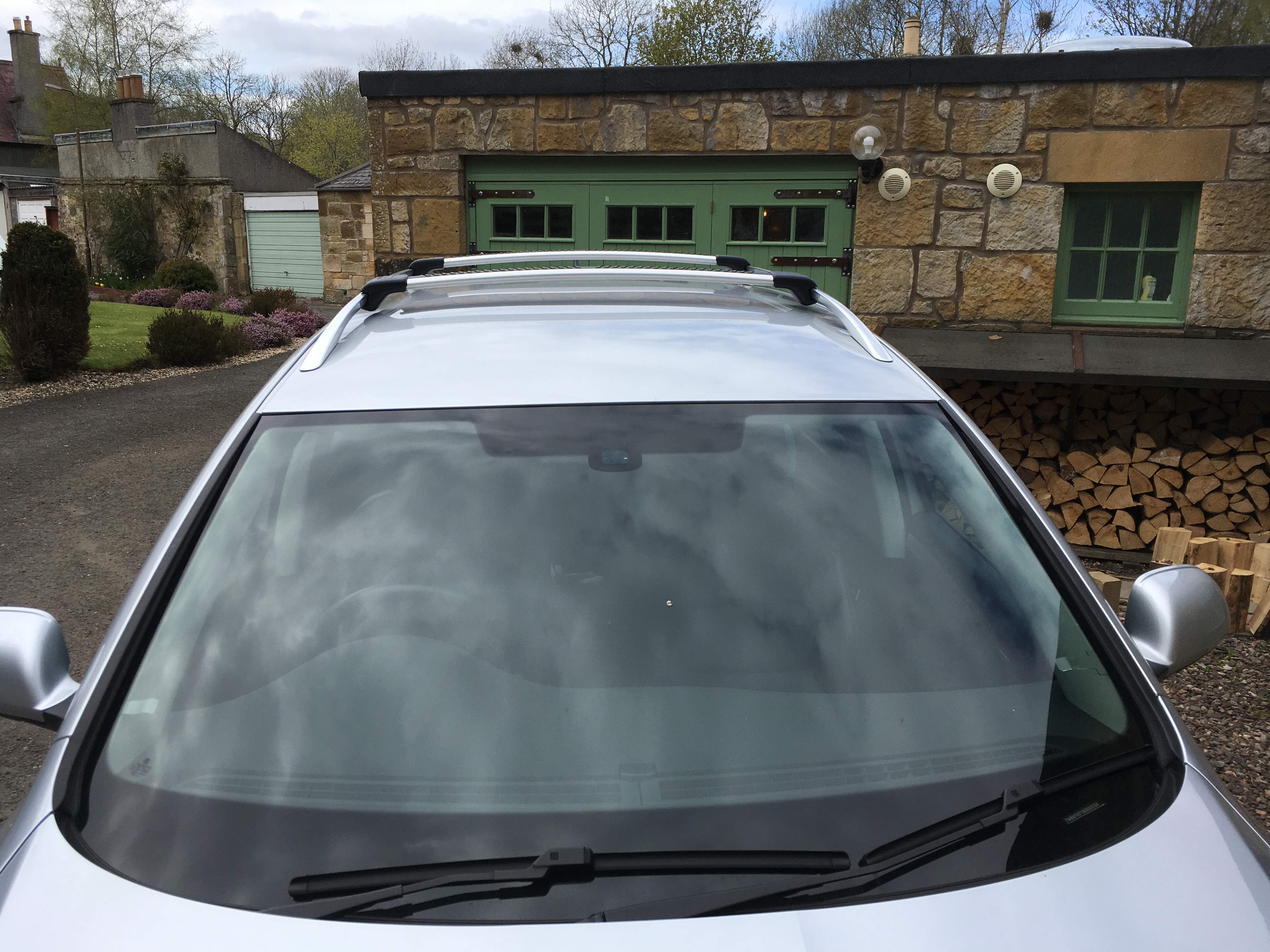

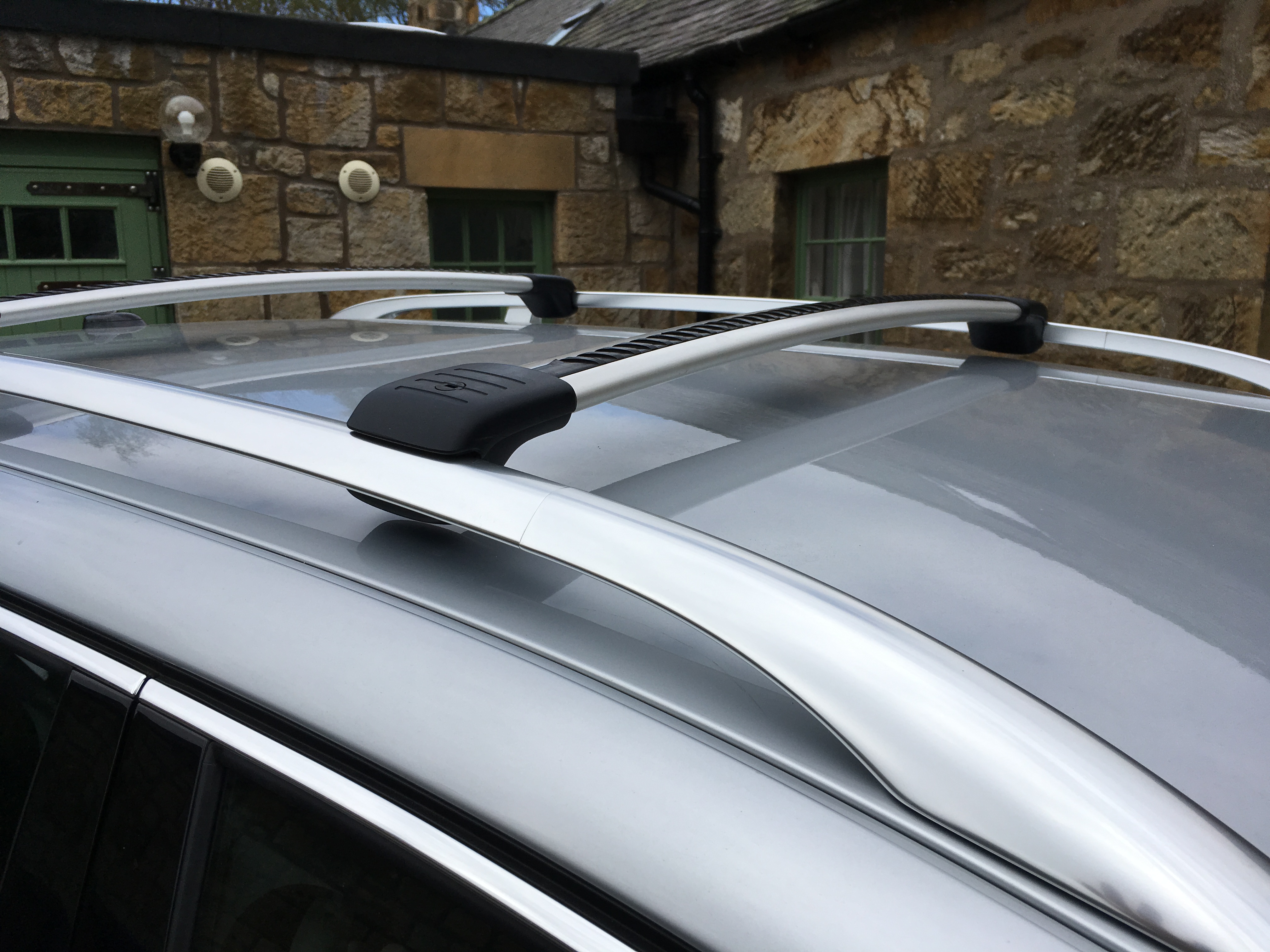

Got the Volvo bars cut down (well one of them, the other fitted as was). Gave them a quick clean and fitted today. Quite pleased with how they look.

They look great - that's a win!
Thanks. Really plaeased with them. Not quite as low profile as the whispbar option but basically a set of Thule bars for no outlay (apparently Thule do make Volvo bars, makes sense what with them both being Swedish).
In the end I just ran tape around the bars to act as a guide and then used a hacksaw. Clean up with coarse wet and dry paper. Only took 30 mins or so inc fitting to the car.
