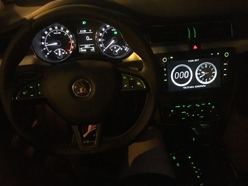

Review of Xtrons PB86MTVAP Android Head Unit
Many thanks for the post.
I too have had the same grumblings with the Columbus to look at the Android unit options, and have also came to the same conclusions.
Better in some respects but worse in others.
It really is subjective and whether the owner can live with certain aspects of either choice.
No doubt that if the Columbus packed up then I would replace it with a Columbus looking Android unit.
I do think the flat screen looks nicer but the fingerprints would drive me to distraction.
Also, I listen to DAB through a phone mostly, and it takes an age to connect to my Samsung S7, so DAB would have to be faultless for me. - Oh and the Maxi-dot

Forgot to mention the Wi-Fi, a few people have had problems with poor range mine is fine and works brilliantly when tethered to my phone. The dab is not the units fault it's the crappy aerial. It's listenable in wide open areas but loses signal mainly in built up areas where I do most driving.

For the money I cannot complain at all about the Xtrons, it gave me what I wanted in flexibility with sat nav and apps and overall speed of operation, is it better than the columbus in some respects yes but in others no. There is a thread on the XDA developers forum where custom firmware is being looked into and I think it is the flexibility of the unit is its greatest feature. How long the unit will last is an unknown. I think if Xtrons had got a octa unit with a button layout as per the columbus I would have chosen that as sometimes you do spend too long looking on at the screen while driving. Overall for the sound quality alone I think its a great choice.
