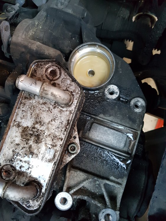

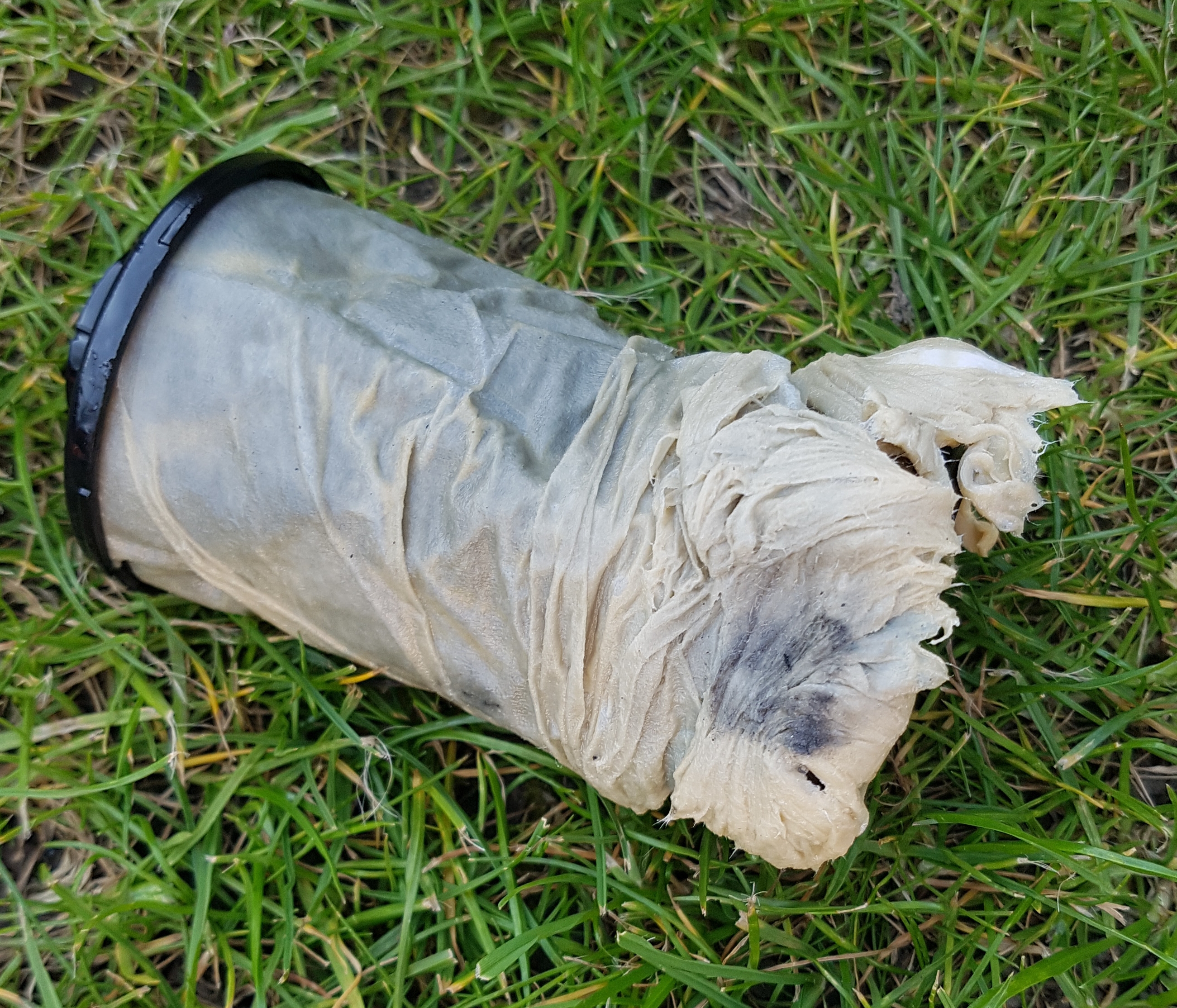

Anyway before I'm going to spend a minimum of  £1000 on an unknown quality gearbox I thought I'd do a little digging of my own and am I glad I did.  The coolant keeps filling with a white gel like substance didn't smell like engine oil but did have a distinctive smell so I thought I'd check the gearbox oil cooler and filter, my god what I found is the root cause of problems here are the pictures below, with the dsg filter out that white stuff is the gearbox oil, the other picture is the condition of the filter as I took it out. When I rub the oil between my fingers it feels like it's lost all it's lubrication and more watery, I'd say the dsg oil cooler has given up the ghost. I'll do a oil and filter change see if that improves anything, cheapest option shy of changing the gearbox.
Pic of the oil filter
Yep, wonder how long that problem has been lurking. Since the last DSG oil and filter change (sarcasm implied).  You going to have to change out the oil cooler and change the oil aren't you?  I am not sure how much faith you can put in that gearbox now.

Anyone reading my have seen the condition of the gearbox oil when I took the oil filter top off, the oil cooler had had it and was mixing coolant and gearbox oil. My thinking now was the gearbox has had it so if I carry out an oil change what's the worst that could happen, the gearbox goes bang I would have to replace it anyway.  So I bought a new oil cooler, gearbox oil and filter from a local motor factors only cheap stuff, if this improves things I will replace the oil with some genuine oil and filters.
Now I didn't do the procedure properly because I don't have VCDS or Vagcom to check the temperature to check the level in the box after filling, I also opted for the top fill method because I don't have the tool to do the correct bottom fill method. Again as I said I wasn't to fussed if all this went wrong. So drained the gearbox and what can only be described as salad cream came out just over 5 litres in total, it was overfull due to the coolant in there, replaced the oil cooler filled the gearbox with 4.7 litres of oil, put everything back together started the car and cycled through the gears. Took the car for a drive and couldn't believe the difference so much smoother, but this was short lived because when the car had warmed up the vibration had come back when pulling away but had gone when driving along.
Now my next thought the gearbox holds approximately 6 litres of oil, so there is still around 1.5 litres of salad cream in there I'm planning on taking it to an indy to get the oil changed again and have the clutch adaption done. Fingers crossed
