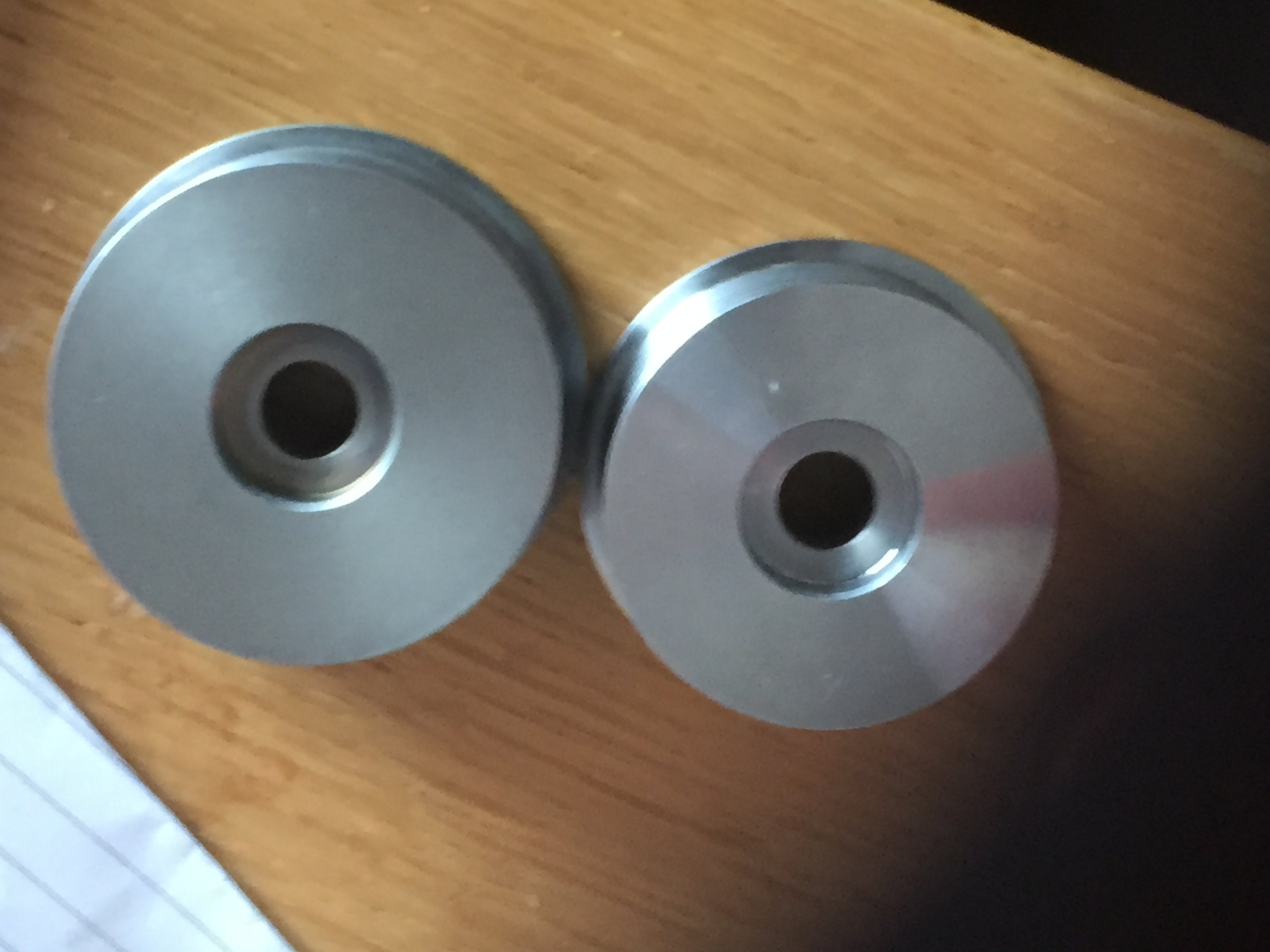

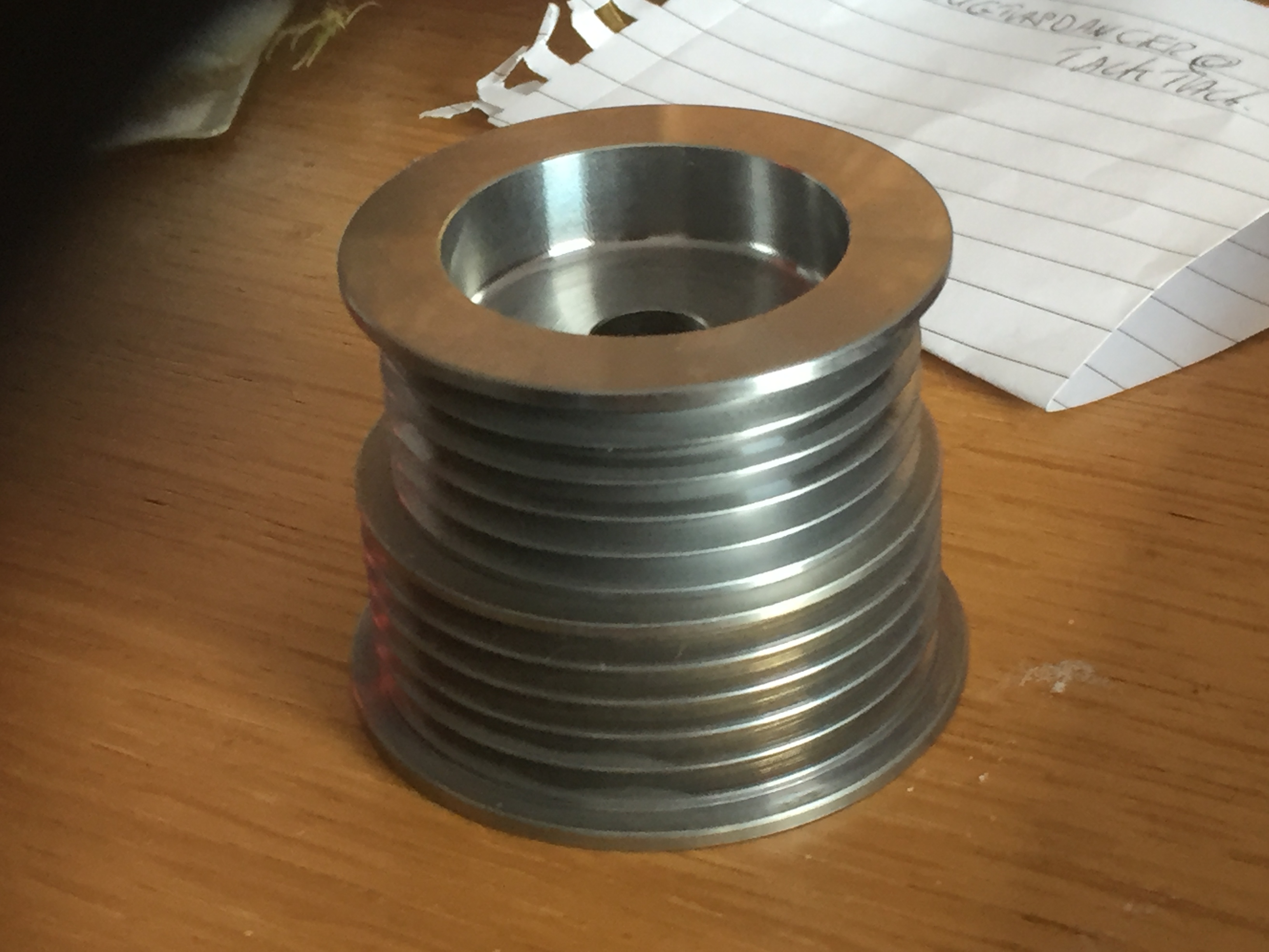

hi mate , the pulley is made exactly the same as the original pulley just smaller but not small enough that the original belt wont fit as the tensioner will just tighten the belt around the new pulley so its essentially just a bolt on mod, i have the pulley but haven't fitted it yet as i don't have funds to run a dyno first so people can see what my car is running standard I'm at my girlfriends at the moment or i would post a picture of the old pulley next to the new pulley
On 9 June 2017 at 18:00, Skyl1n3 said:
So anxious to see what this can achieve.
heres a picture of the smaller pulley while i wait for funds to get a dyno run of my car on a standard map
