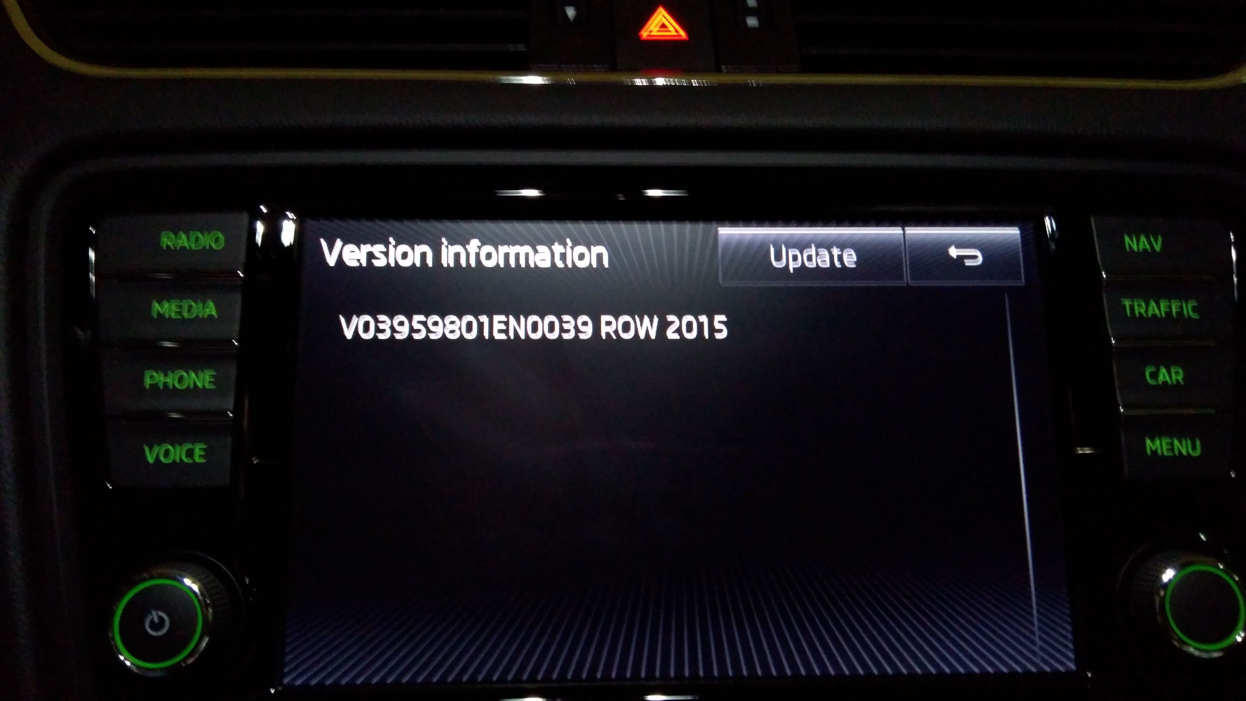

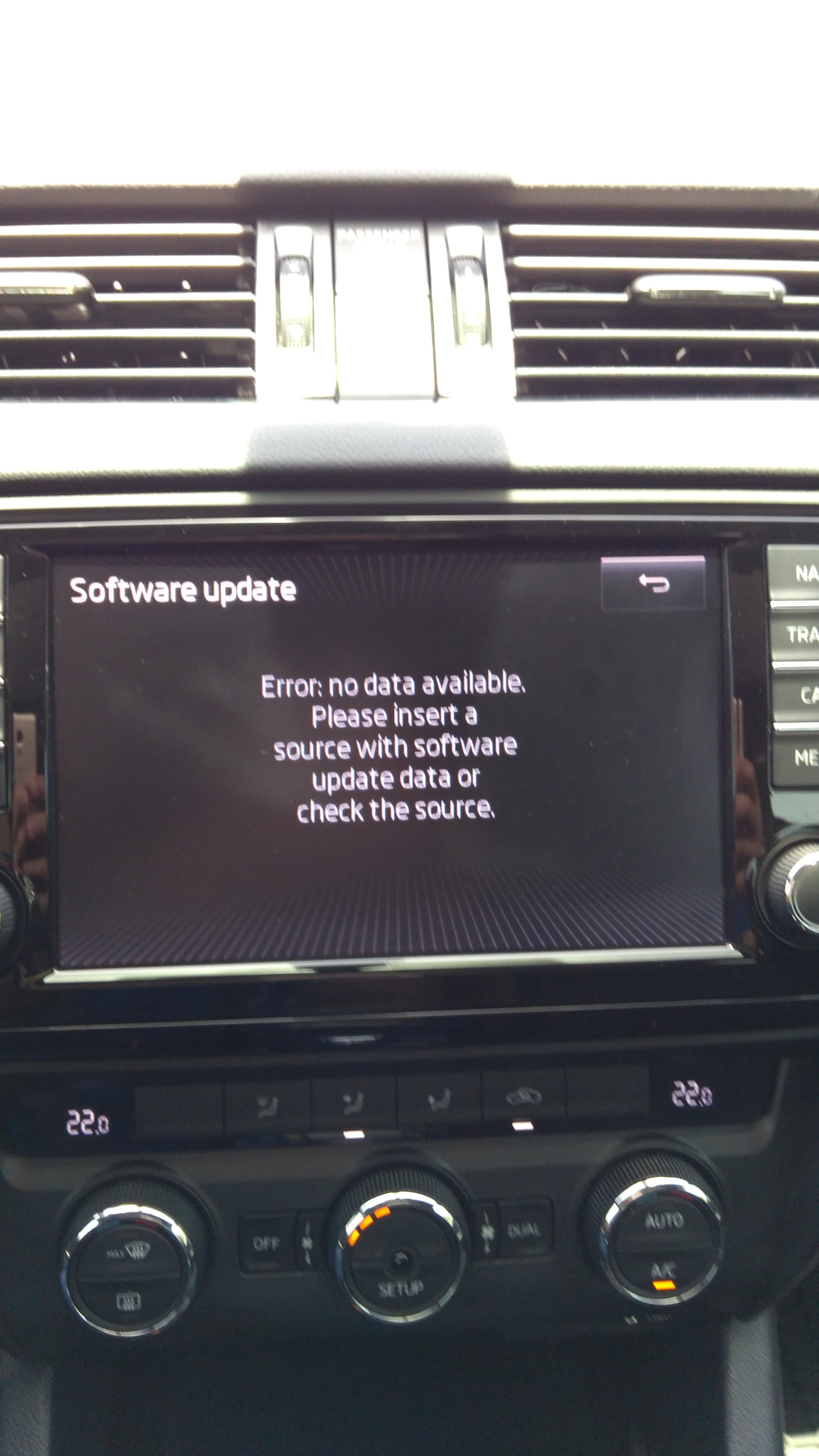

Hello everyone . I tried to update my row 2015 maps on my 2015 vrs and followed the exact same instructions posted by other forums members here in terms of sd card formatting capacity and class but still with no results. Any ideas ? The card contains 2 folders MIB1 and MIB2  and the textfile.
thanks in advance
Amir
P.S i attached the screen shoots
That looks like a Columbus unit so you dont need to use a special SD-card.
You can use a USB key, hard-drive connected via USB or any SD-card to perform the update.
I would format the card the default way on your PC (without any special clusters sizes or changes - this is only for Amundsen), then copy the files onto the card & try again.
As you say, in the root folder of the card you should have a text file & 2 folders, MIB1 & MIB2.
thanks in advance
Amir
I doubt if you will be able to update RoW maps with ECE ones ......
