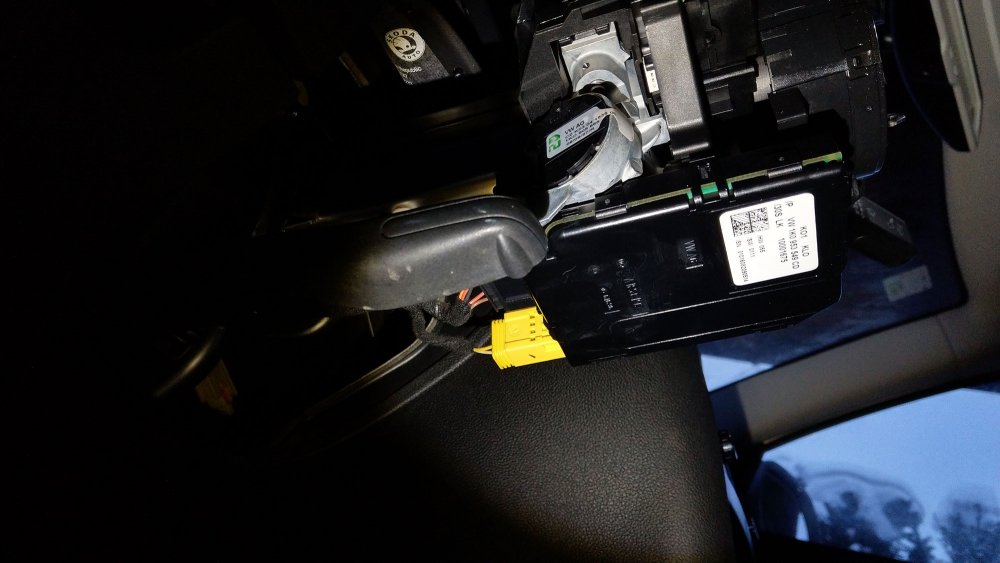

So, to start with: i have a S2 model 2012 with no MFSW and no cruise control my current column computer is 5K0 953 549 (simple, no letters).
To install a MFSW i understand i need a new computer (the highline one 5K0 953 549 B ) together with left/right sticks (turn lights, cruise control on left and wipers, etc on right).
I have this item together with the sticks, as well as new airbag and cabling, but i have problems with 2 wheels i found: the buttons on both don't work properly, volume up is pressing the left wheel, vol down is pressing the right wheel (instead of left wheel scroll for both up/down), etc...can't get into MFD or BC using the right buttons, etc...
The person who installed it explained that the new computer (the only one high-line available for this of car) does not play well with the commands in the wheels, because they are Octavia 3 or Octavia RS wheels. The damn things look identical to Superb 2 FL wheels but the button controls are different components.

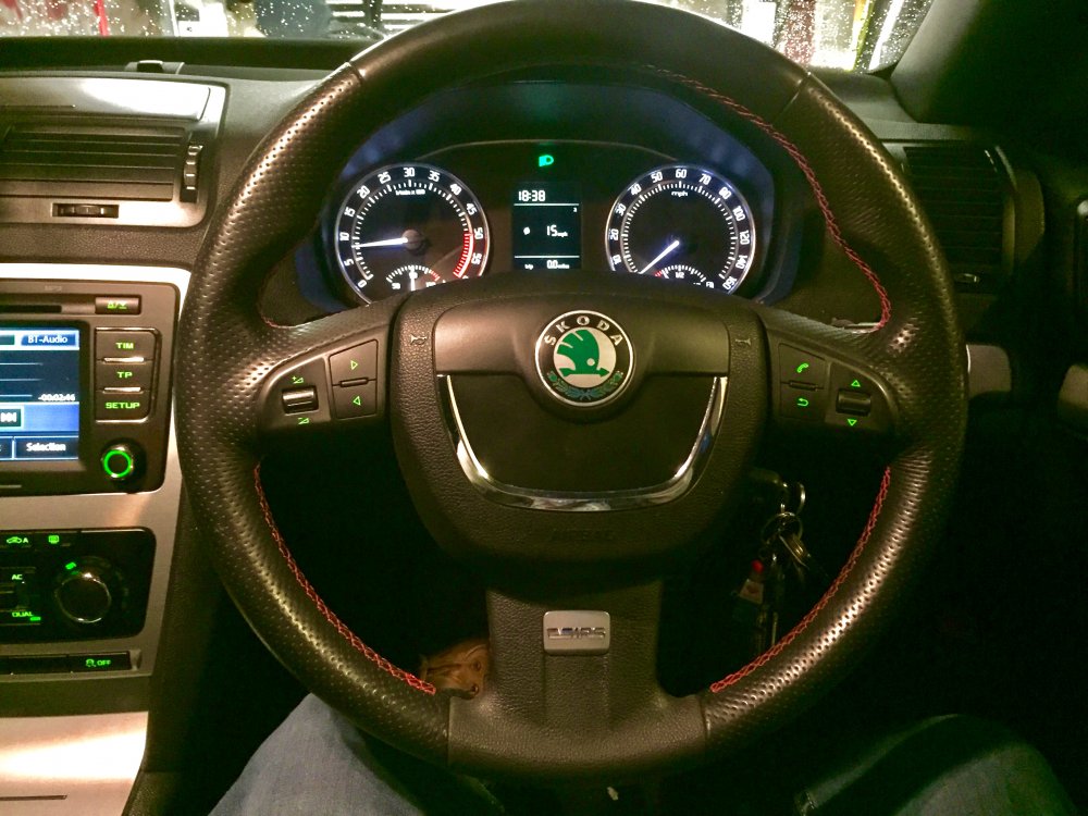

The stupid wheels i tried are an O3 wheel, 4 spoke, similar to the S2 FL one, and a RS wheel, flat bottom, perforated leather with red stitching. Both with only multifunctional buttons incl. telephone and no DSG paddles. Luckily the airbag fits both. I need the airbag regardless, because the one in the original wheel is different and will be sold together with the wheel itself (once i get this damn retrofit sorted out)...

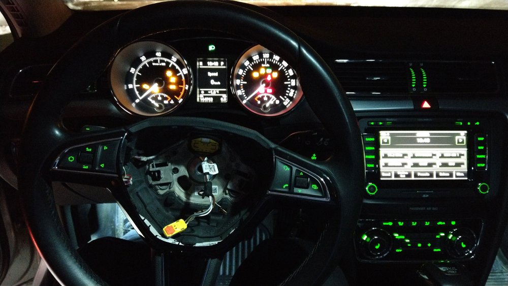

I am trying to fit THIS wheel now
But i had THIS one also today and also failed....
As i said, my controlled now is 5K0 953 549 and the one i have to install is the "B" high-line version, together with new sticks.
Ross Tech wiki says the same thing HERE

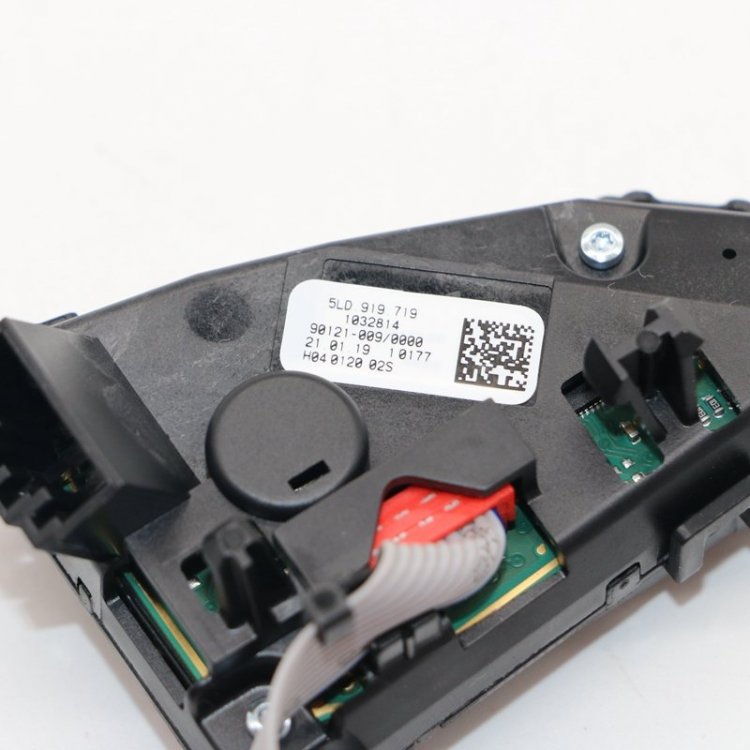

basically the "old" buttons have the 3T0 (Superb 2 pre-FL) code, while the "new" buttons have the 5E0 (Superb 2 FL, Rapid, Yeti) code.
while 3T0 should work 100% with the 549B module, the question is: do ALL 5E0 buttons work with 549B as well (besides knowing they work anyway with 569)
Edited by zice
My understanding is that there are ~8 different 5E0 part numbers. They are split between two different communication types for PQ35/46 or MQB cars.
If your 549 B module supports 3T0 buttons, I believe it should support 5E0 buttons designed for PQ35/46 cars. It will not support 5E0 buttons designed for MQB cars.
ETKA suggests the following:
- 5E0919719 (Fabia3, MK3 Octavia)
- 5E0919719A (Fabia3, MK3 Octavia)
- 5E0919719B (MK3 Octavia)
- 5E0919719C (Fabia2, Rapid, Roomster)
- 5E0919719D (Fabia2, Roomster)
- 5E0919719E (Rapid, MK2 FL Superb, FL Yeti)
- 5E0919719F (Rapid, MK2 FL Superb, FL Yeti)
- 5E0919719G (MK2 FL Superb, FL Yeti)
That shows that 5E0919719/5E0919719A/5E0919719B are for MQB cars so will definitely not work.
I think that 5E0919719C only has the left hand buttons. Not sure about 5E0919719D.
That leaves the following as the best match for a PQ35/46 car such as your MK2 Superb:
- 5E0919719E - without telephone controls
- 5E0919719F - with telephone controls
- 5E0919719G - supports DSG paddles
I can't be sure they are compatible with your 549 module but with the correct wiring loom I would be surprised if they didn't work.

i found an Yeti/Rapid/S2 FL wheel, code 5L0 419 091G CWE. It has for sure the 5E buttons (new design) but can't know exactly which until i test it.
am i correct to assume that Skoda was smart enough to put 5E buttons compatible with MK2/PQ35/46 (one of the 3 you mentioned last), on a wheel which is compatible with MK2? :)
Assumption based on the fact that the classic Octavia 3 wheel, such as the one i have now and doesn't work, has installed the 5E buttons compatible with MQB, not PQ35/46...
I checked the info HERE and i got the following, is it correct?:
Superb FL 2014:
3 spoke wheel - (2) 5L0 419 091 G
buttons - (11) 5E0 919 719 E/F/G
Octavia 2014:
3 spoke wheel - (2) 5E0 419 091 G/AG/H/AH/D/J/AF/AS/AT/K/L/AP/AQ
button - (11) 5E0 919 719 A/B
Yeti 2014:
3 spoke wheel - (4) 5L0 419 091 G
Therefore i assume the buttons on the S2 FL/Yeti are similar, while Octavia 3 are different (even though the f***g wheels look the same) hence my issues.
Now hopefully the factory don't assemble Octavia buttons in Yeti/S2 FL wheels, because they'd have the same problem as mine right now...not 100% working commands.
And to add more hope, the S2 FL/Yeti wheel works fine with the 549B highline and the Octavia 3 airbag fits properly :)
I can't figure out why current buttons light on O3 wheel are white, not green...hopefully the S2/Yeti wheel is green.

Ok, i can confirm it works!!!
just installed it.
Thanks all for your help!
