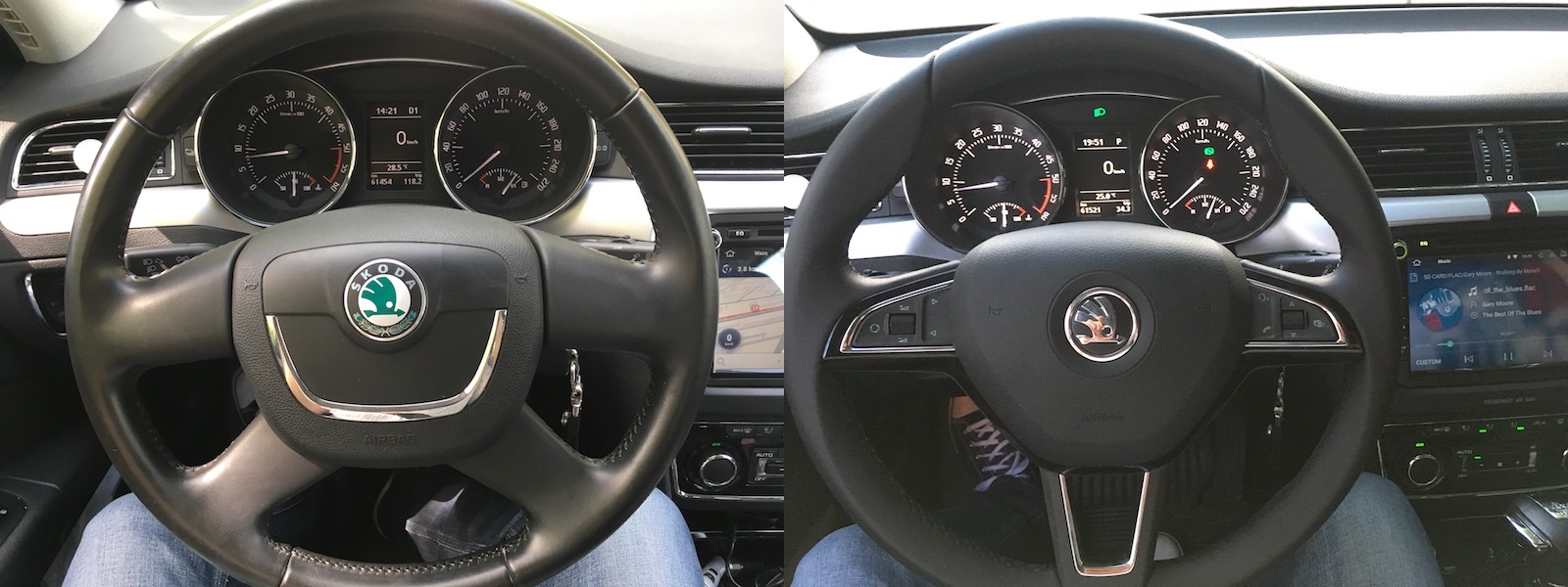

Overall i'm very happy with it, everything works, buttons, cruise control. Perfect.
Even my aftermarket chinese android headunit gets along fine with it, i can control it with no button remap or anything. Nice.

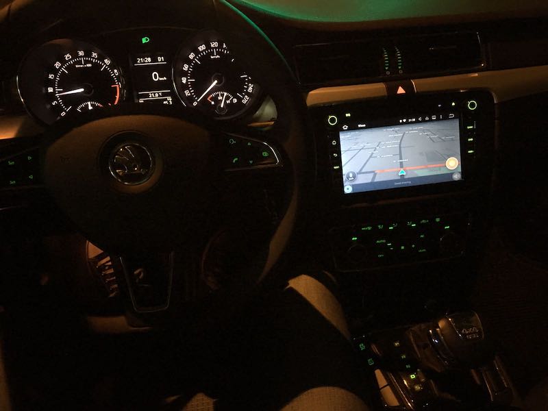

Here's how it looks, all lit up. The navi lights are green but don't show properly in the picture. They are RGB so i can change them to any colour needed.
Highly recommend Joying units for VW, if anyone's interested what it is...

Looks much better i hate the cheap plastic look of the original wheel.

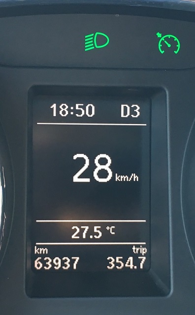

This is what i see in the MFD when cruise is activated. Only the green icon appears and the digital speedometer shows the current speed.
What do you mean "press the stalk up or down"? It has small click buttons (SET and RES) at the tip of the stalk which can be long pressed to increase/decrease speed when CC is activated. Short clicking them does nothing apparently. To increase/decrease speed i have to long press them (keep pressed 2-3 seconds then speed goes up or down in a linear fashion, gas-pedal like)
A quick press of the increase/decrease switch will adjust the speed on my car by 1kph. However, it is very gradual, perhaps 3 to 5 seconds depending on the road incline.
