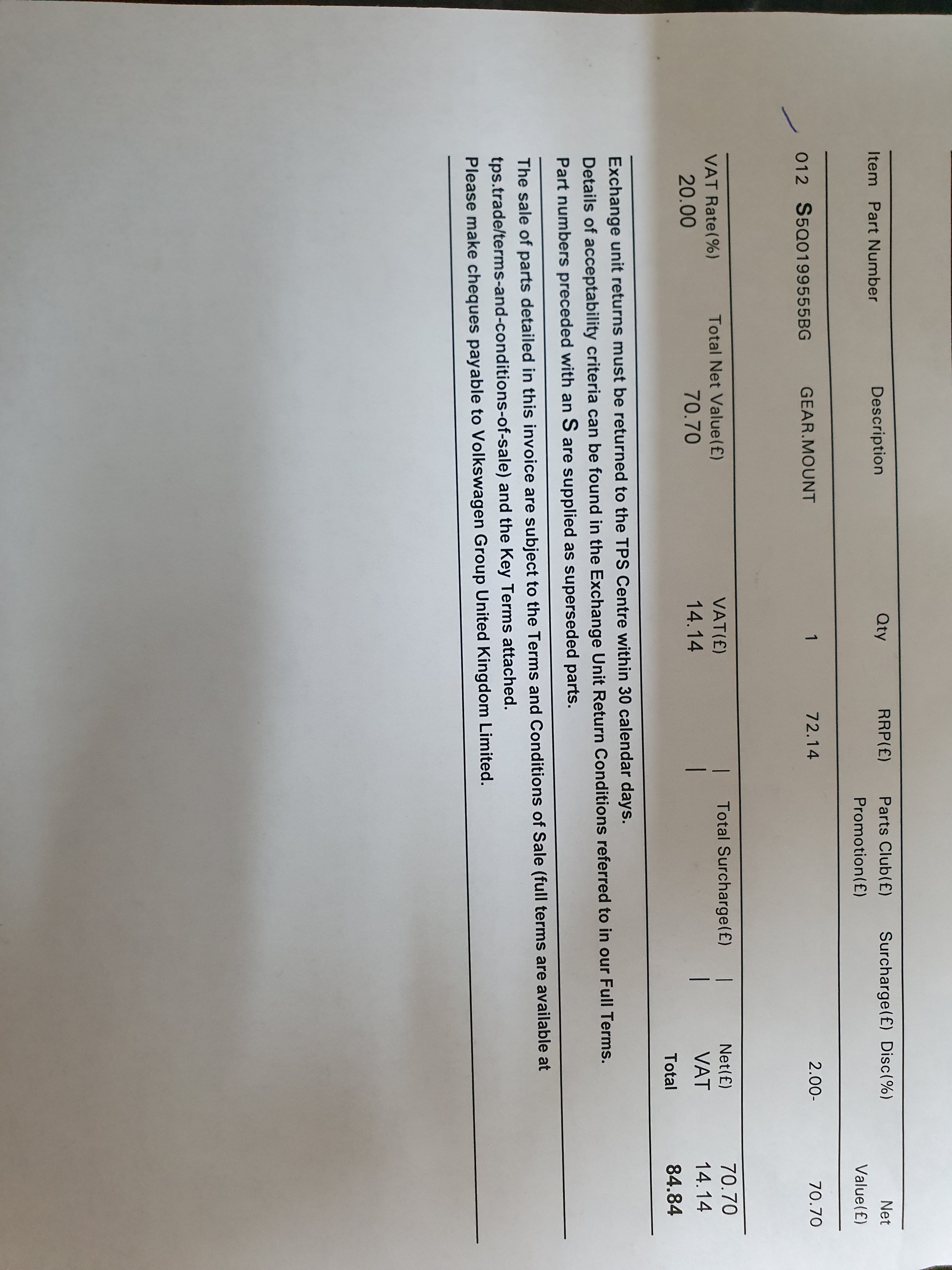

Hi All, i have recently bought skoda octavia 2015 green line from a trader to put it as a private hire vechile so when i bought i didn't realise the nosie on turning left but after few days of driving it i start noticing the noise when turning left i went to mecanic and told him to change the gear box mount but he opened the battery and its box and by looking at it he goes no mount is ok then we changed brake pad discs left side front wheel bearing and cv joint but noise was still there so i went to tps and bought gearbox mount from tps and went to different mechanic and asked him to replace the mount and soon gear box mount replaced the noise on left turn is gone completely .
Hi,
Its dealer only part and i got it from tps it costed 84.84 pounds and tps only sell it to traders but i got it as i got taxi badge. There is other option you can buy second hand from breakers but i personally wont go that way i have heard even a mount is slightly weak it wont fix the noise issue.
