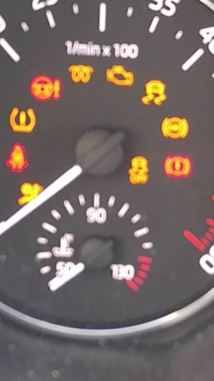

on switching on my 15 plate tdi octavia estate the symbol for the dpf does not show.
i bought the car ex demo from  a skoda dealer. i have never seen the dpf or regen symbol at all.
how should i know if and when the car is doing a regen or if the filter is full?
i do a mimimum 30 miles a working day only on motoway other times up to 50 miles. i never drivr in the city.
here is an image of the dash
thanks for helping in advance

Never seen mine on a 2009 Yeti or a 2013 Octavia either. I'd only be worried when it shows up.
The DPF light should not come on under normal operation of the DPF, during an active or passive regen.  I find this post on another forum explains things:
http://uk-mkivs.net/topic/31023-dpf-regeneration-information-must-read-for-all-drivers-of-dpf-equipped-cars/
The DPF light will only come on if the DPF can't sort itself out through an active or passive regen and a trip to the dealers is likely but a good thrashing at the prescribed revs/duration may alleviate the problem.

Your dealer is correct. Just stop worrying about it. Like I said, the time to worry is when you can see the light.

You really don't need to worry at all, the CR engine is well suited to a DPF and it manages to cope perfectly fine even on shortish runs providing your journeys allow the car to get to operating temperature (DPF will not start regenerating until the engine is quite some way to being at operating temperature)
At the distances you cover and the type of roads, you should not see the DPF light at all, as it will regen on it's own.

There is a DPF light guys (assuming the car is a diesel).
It's all in the manual ;-)
Image result for 2016 octavia dpf light
Have never seen that in the status.
Usually when it is running a DPF, the status just says "Start Stop unavailable / Engine needs to be running"
The only time to worry is when the light comes on or you see the warning above!
