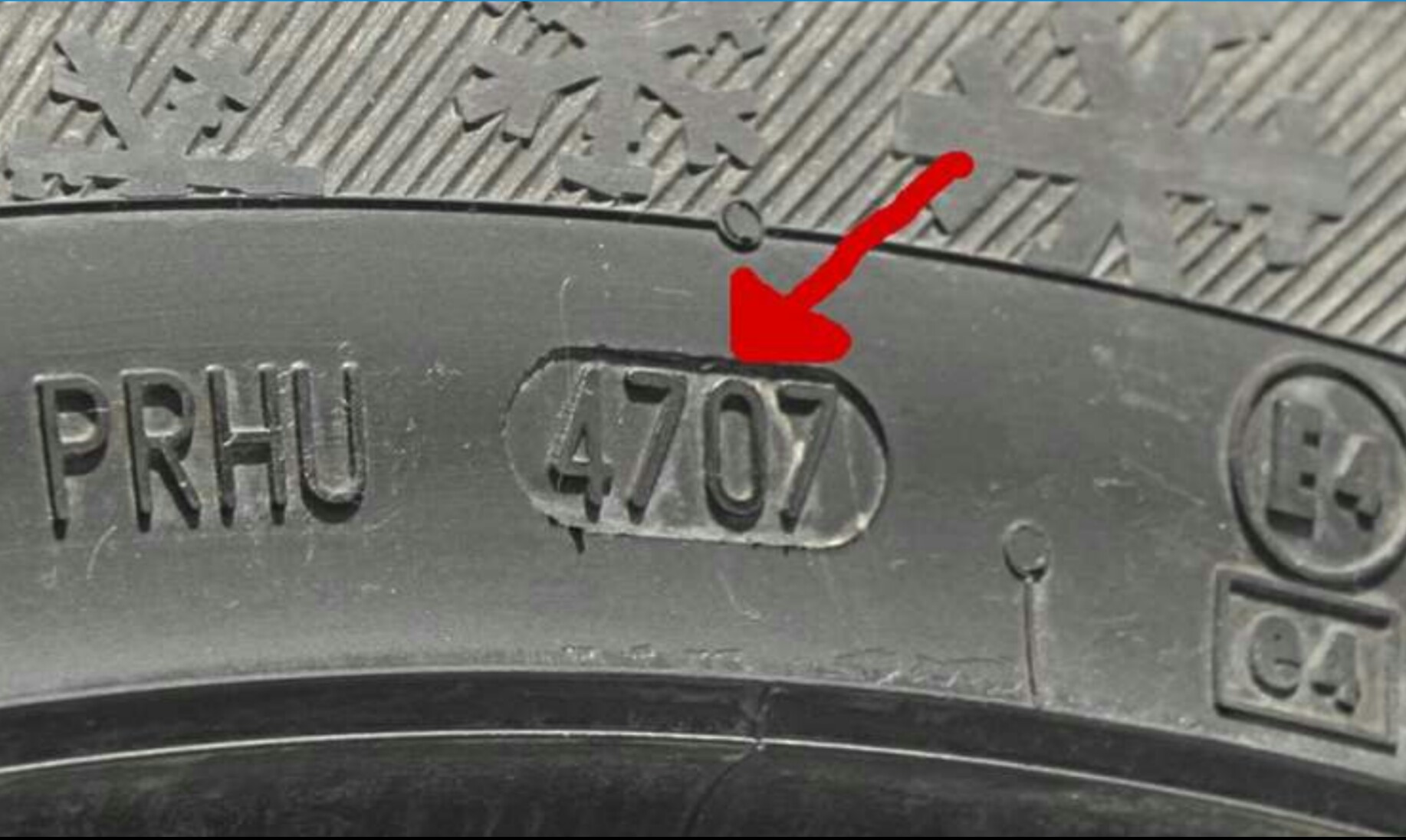

How old are your tyres? Rubber hardends over time and hard rubber gives less traction. There is a oval mark on tyre side wall with 4 numbers in it (month-year). Check it.
It also matters if the tyres are stored badly during winter season. If kept unused in the sun and rain the rubber deteriorates quicker and you get less traction when you put them on again._20170507_153039.thumb.JPG.4f95437d24b875e77be4fff184f0a696.JPG
Sorry, wrong info from my side: the oval marking on the side walls are (WEEK-year). In my example photo above, the tyre was produced week 47 in 2007.

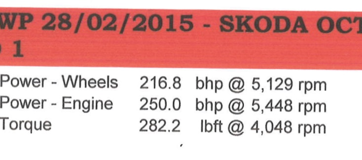

I have a 230 Vrs with 230 Plus (predictive 250ish) bhp, running 225/35/19 Pirelli P Zeros @ 39psi all round and have no traction problems at all.
I find it very difficult to light the front tyres up, does have the fancy e-diff though..............

Please put a rolling road graph up showing this magical 250-ish BHP.
some tyre manufacturers don't use that style dot code. some use moth/year i.e 0117- so reads January/2017

Is this from a VRS 230 or a mapped car? If it's standard, impressive....why aren't owners complaining about the extra BHP, like the TDI owners are with extra NO2 !

Ive had my 2010 2.0ltr tsi on a rolling road and it came out at 222bhp and 233ftlb torque totally stock
