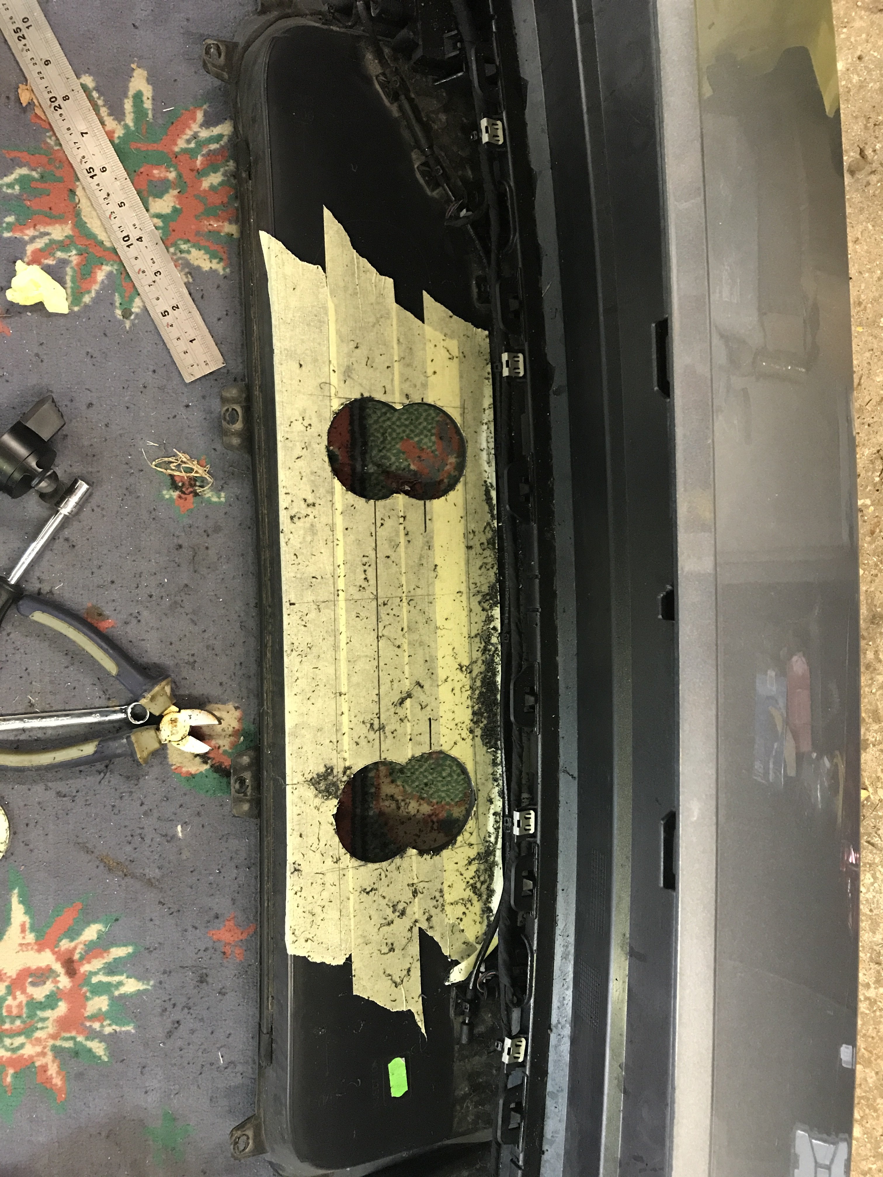

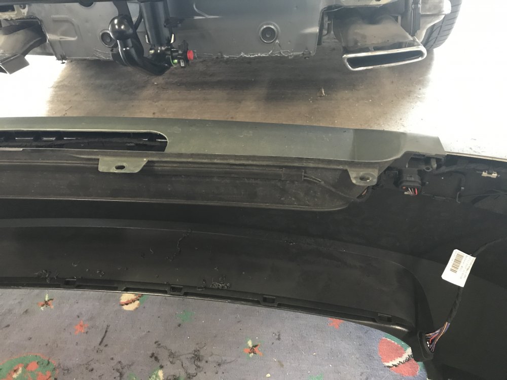

The sensors are long cables, one flat along the inside bottom lip the other very close to the cutout (in photo continues diagonally and meets up together)
