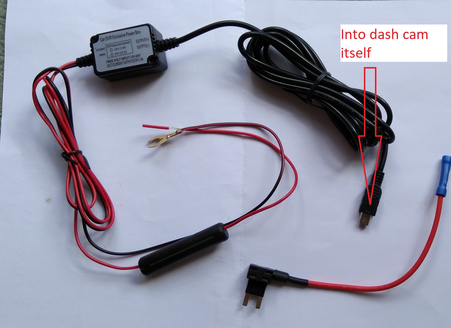

Can you please show me fuse off ebay I need to buy? I assume there are quite few empty slots in fuse box for this fuse? Dash cam needs to be powered all the time, even with engine off, as it also recording in parking mode with G sensor and motion detection.
This is a kit I have been sold to wire it in
I piggybacked off the 'washer jets heater' fuse - as my car is not fitted with heated washer jets. Of course this is a switched circuit that is only on with the ignition.
I did read somewhere that for a permanently powered circuit you could try the remote central locking circuit. Alternatively, since the 12v outlet sockets are permanently powered in the Rapid, that would be a good one to piggyback off. I'm no expert though - and do refer to the manual to select the right fuse number. The rapid is also awkward as it has a mixture of small and large sized blade fuses - I wanted to feed off the rear wash wipe as Chrisgreen suggested, but the kit I used had the smaller fuse piggyback hence I found an alternate.
