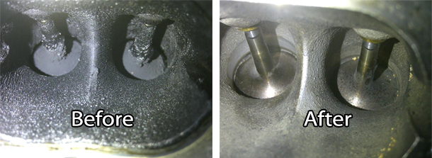

guys is it worth doing a carbon clean

Carbon clean?
Snakeoil Quackery. There is no good quality evidence, don't bother.

really ?
I'm Talking about where they take the head off and clean the valves surely that has to be of benefit to the engine valve_cleaning.jpg.e523bd5a95f998758766f7f74de0fd90.jpg
If they dismantle the engine, clean it, and put it back together then, yeah, that's plausible, but if it's the nonsense where they put a magic pipe in your intake, that's *******s.
